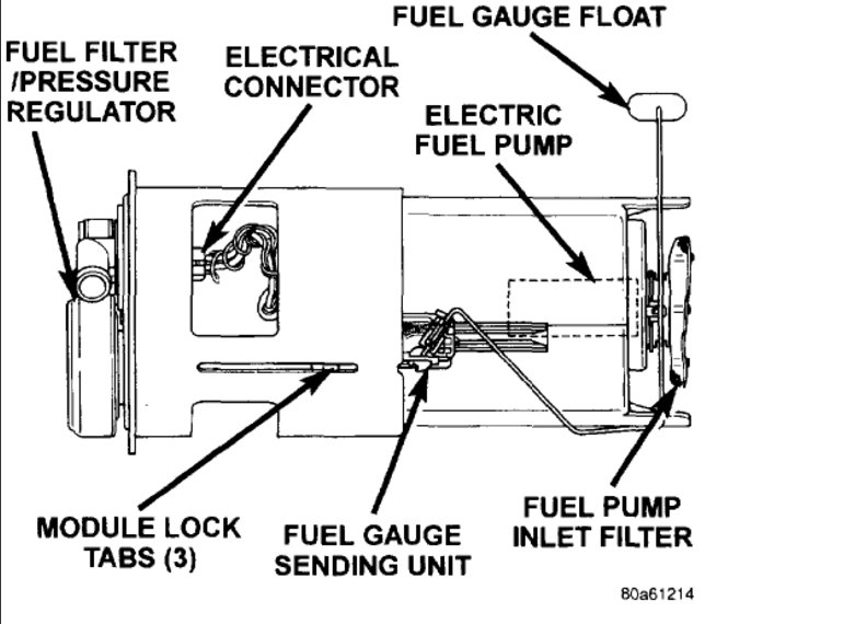

Where is the fuel filter?
Does it have one other than the one in the tank?
Nov 21, 2019 at 2:21 PM
Good afternoon.
The filter is at the fuel pump. It is the only one listed. I attached a picture of the location of the filter for you to view. Check out the diagrams (Below). Please let us know what happens.

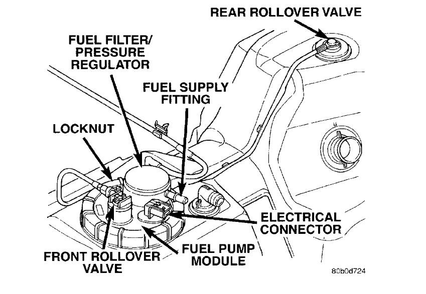

Check at the fuel tank where the fuel pump module-its right beside the pressure regulator.

Welcome to the forum, the fuel pressure regulator has an internal filter, the regulator is on top of the fuel pump module. There is no separate fuel filter, that I know about.

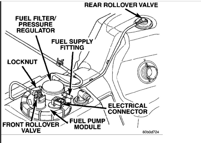

  • 54,178 POSTS
The fuel filter is located at the top of the fuel tank. Here are some diagrams of where the filter is located in the tank. (below)
It is with the pressure regulator.

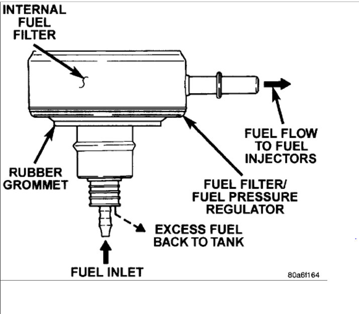

sing a twisting motion pull fuel filter/pressure regulator from the rubber grommet on the fuel pump module, ensure it's not pulled more then 3 inches out or damage to the pressure regulator can occur! Dodge recomends the tank be removed to service the filter/regulator! It's on top of the gas tank!

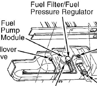

YEah, nice place huh? You'll need to drop the tank to get the pump out. The filter/regualtor assy is on top on the module fuel pump module.

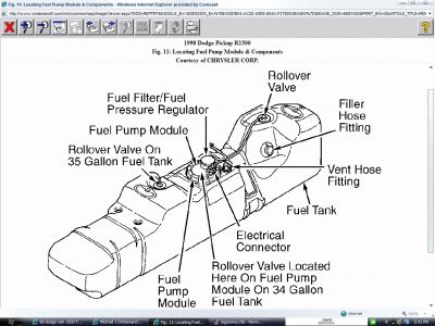

  • 75,992 POSTS
The fuel filter/fuel pressure regulator is located on top of fuel pump module.
