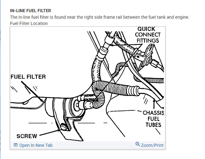

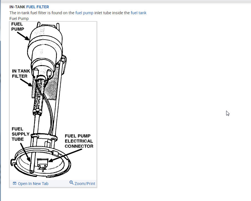

Where is it located at?
Oct 19, 2020 at 11:13 PM
It appears you have two. There is one in the tank that is part of the pump. The other is on the frame rail. If you cannot find the one on the rail then you only have one in the tank. It does not state that all are equipped with both so you may only have one.
