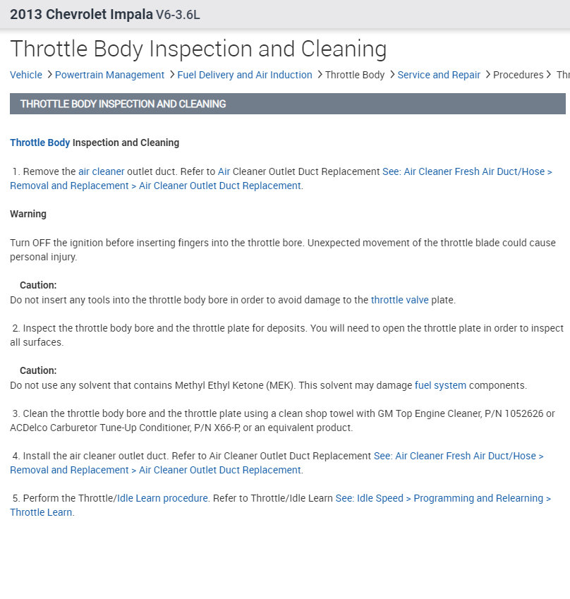

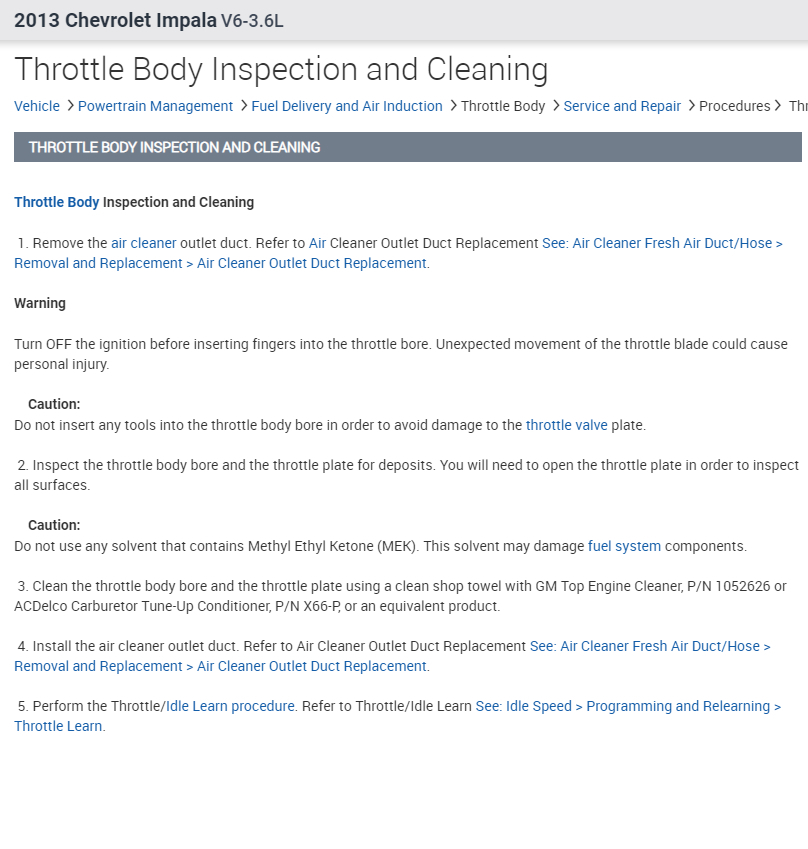

Many times, doing a tune up can improve overall efficiency significantly. Like replacing the air filter, changing out the spark plugs, cleaning the throttle body and mass airflow sensor etc.

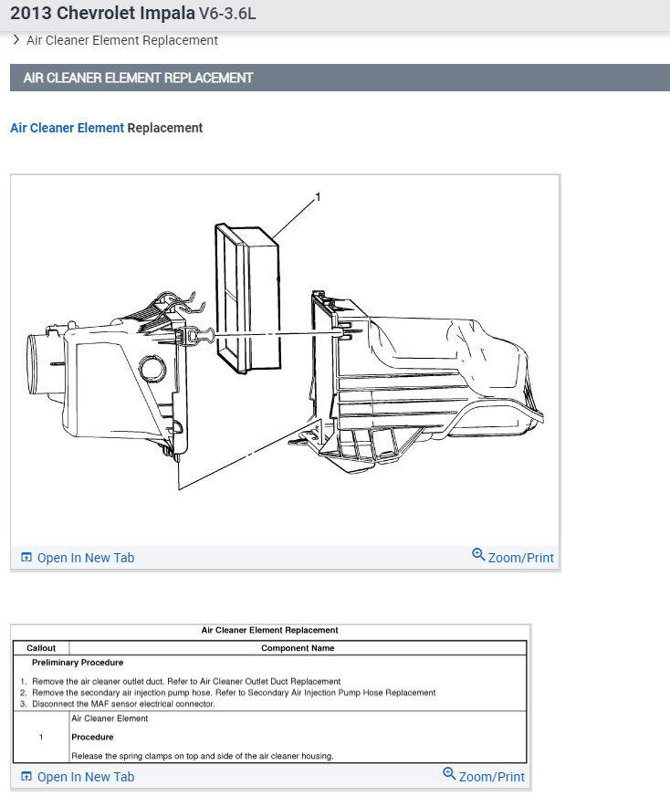

If the plugs are worn, then replacement would be recommended. Be sure to check the air filter as well as the mass air flow sensor.

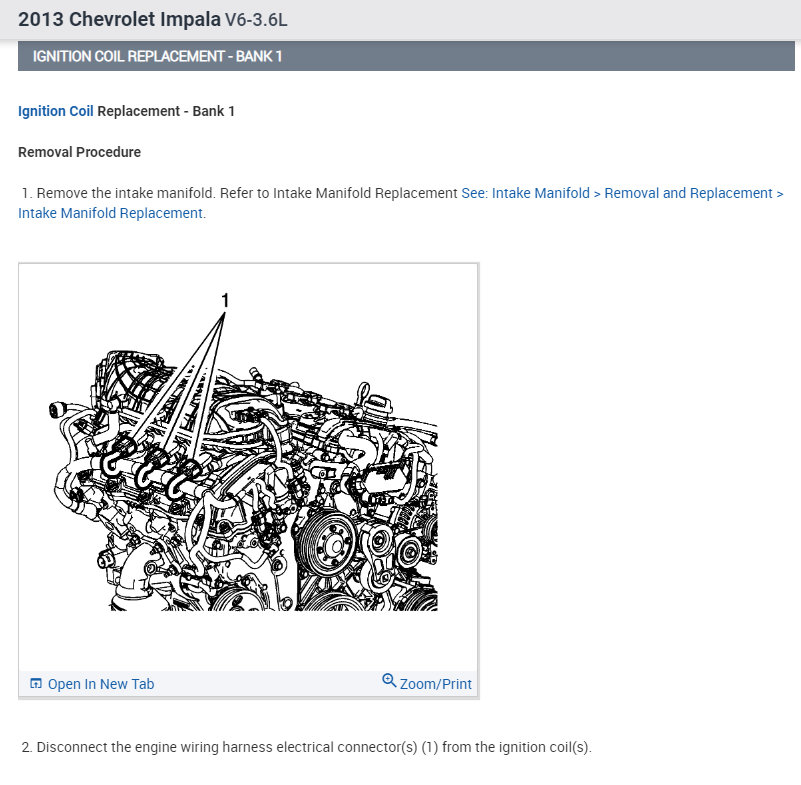

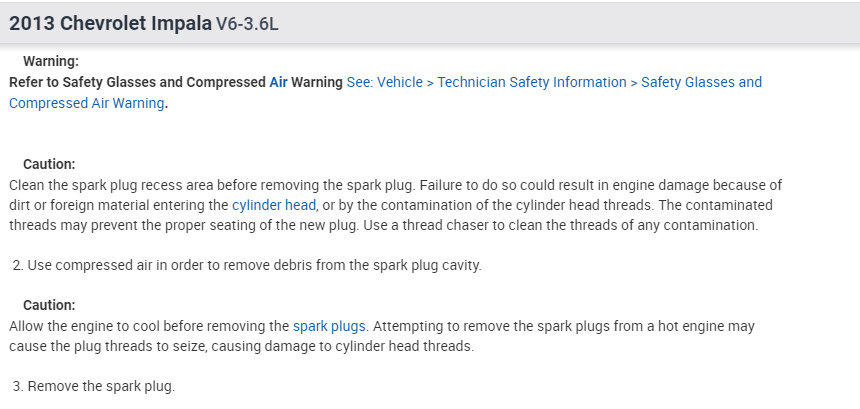

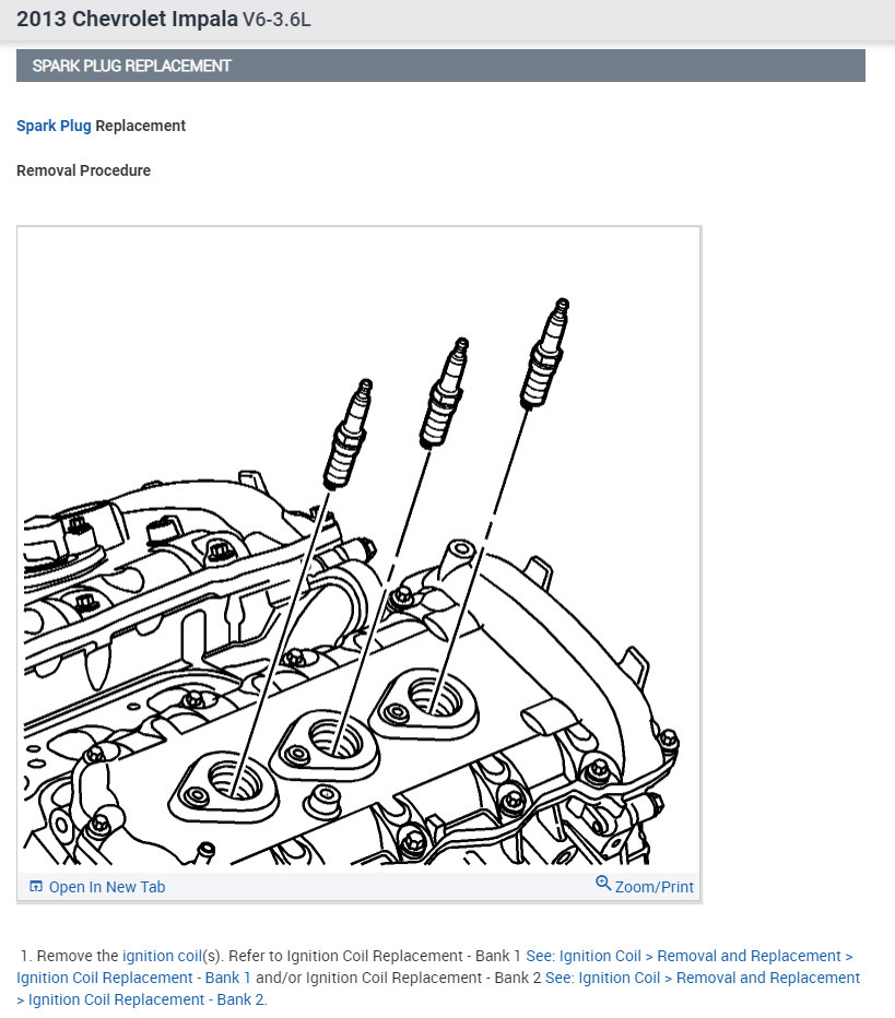

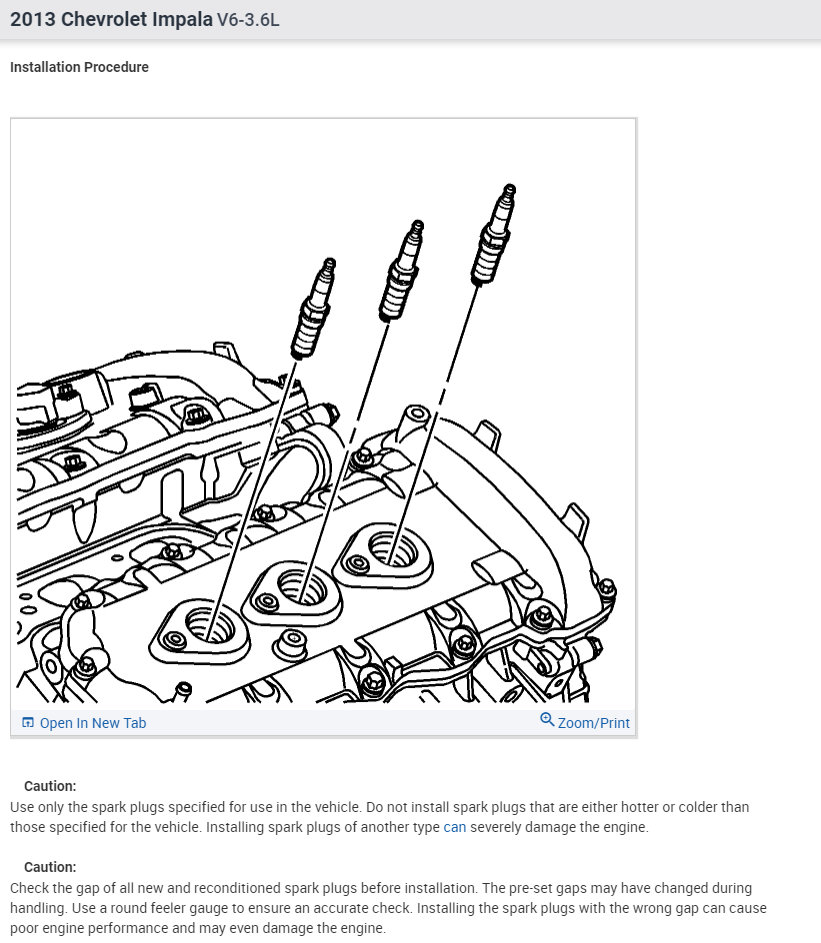

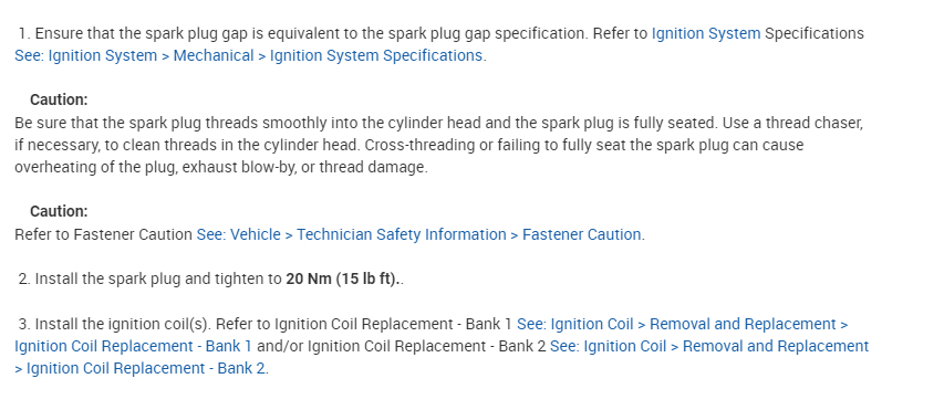

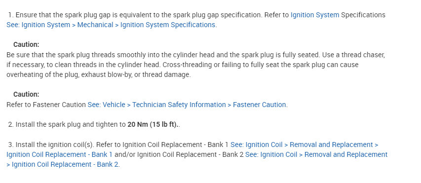

How can I change the spark plugs myself on this car? I went to a repair shop to get quotes on replacing just spark plugs. He was asking $450+ which I cannot afford.
Saturday, August 27th, 2022 AT 4:15 PM
SQM
  • 6,383 POSTS

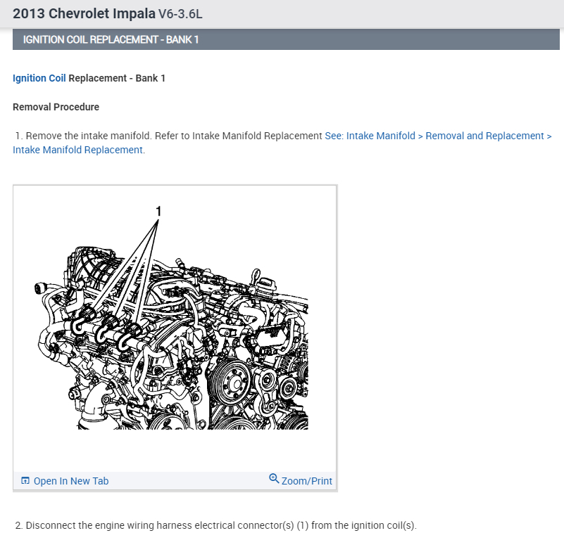

See attached for the spark plug replacement procedure.

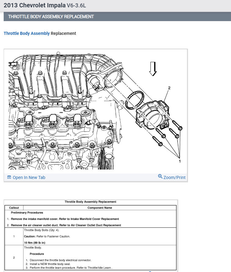

Keep in mind that you will also need to check the air filter and replace it if necessary, also cleaning out the throttle body is also recommended.
https://www.2carpros.com/articles/how-to-replace-a-car-air-filter
See diagrams below.
