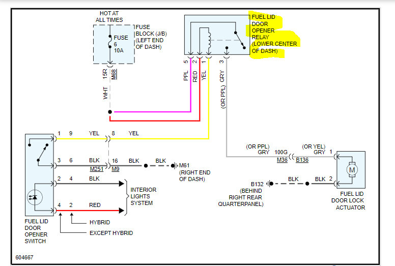

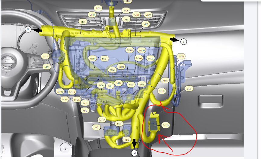

I'm unable to find the location of the fuel door lid opener relay.
Jul 28, 2024 at 10:21 AM
  • 110,190 POSTS
It is a little to the right of center, closer to the glove box and under the dash. I attached a pic of the wiring schematic showing it. Also, the second pic is the best I could find to show the location.
Take a look and let me know if this helps.
