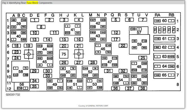

Fuel door and trunk release do not work from dash, not relay in trunk already checked No previous history of this problem, both quit working at same time. have to open trunk with key and pull on fuel door release cord from inside trunk to open fuel door

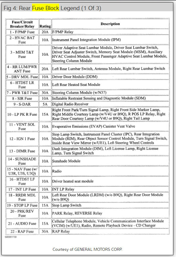

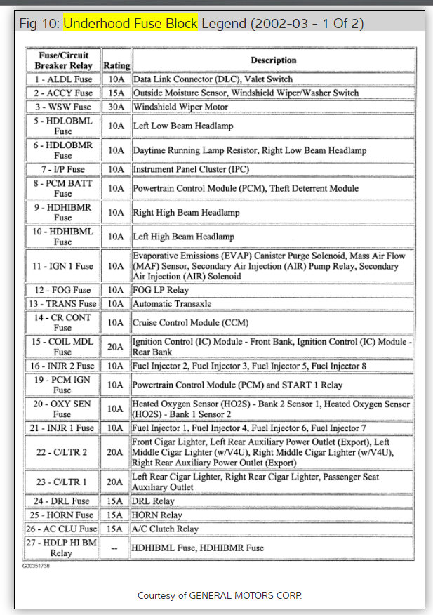

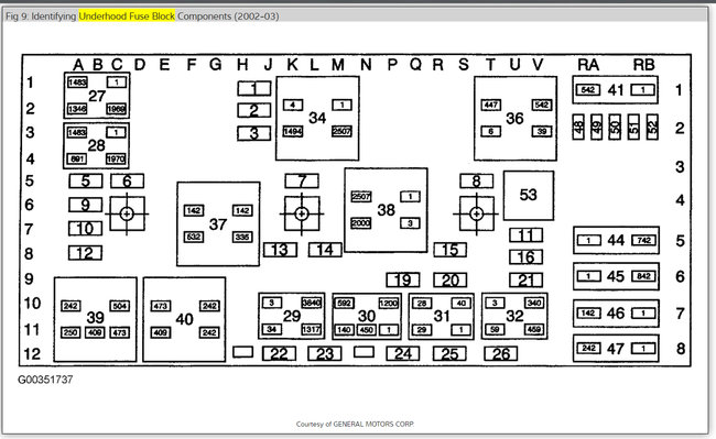

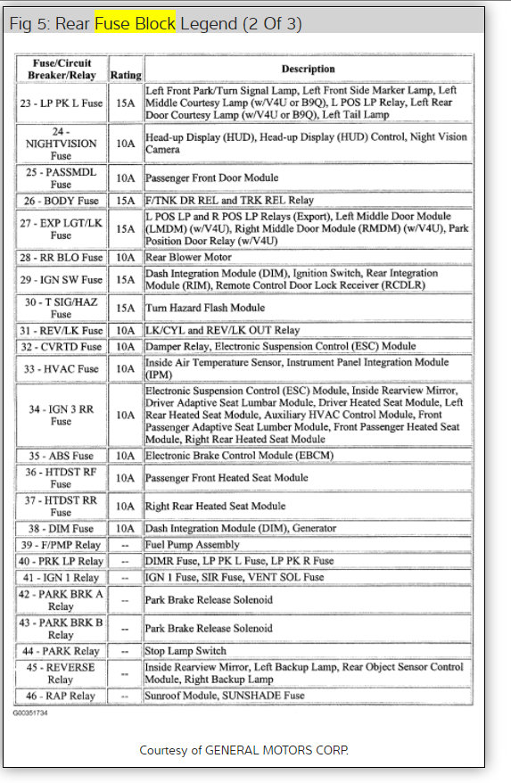

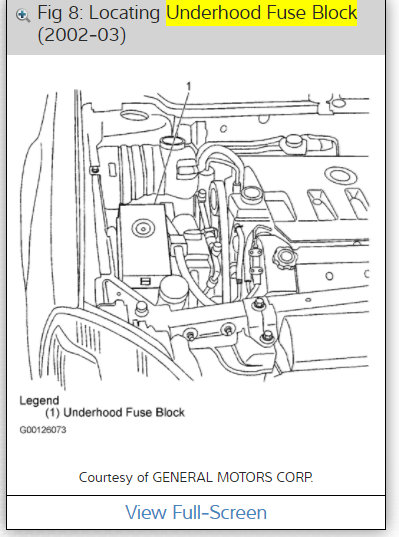

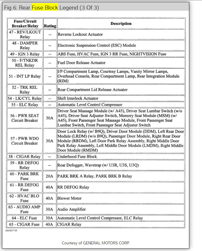

Check Body fuse in rear box under left rear seat also check to see if Valet switch is set here is a guide to help with the fuse with the fuse panel in the diagrams below.
Check out the diagrams (Below). Please let us know what you find.

Valet switch in glove box was the problem. must have been turned on by accident. I even called area caddy dealer they were of no help other than bring car in for diagnosis,
