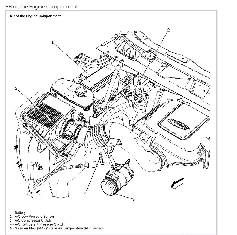

It sounds like it could be a bad MAF sensor, if so, it will tell the computer the volume of air is way less than what is going into the engine, therefore the mixture will be lean. We should run the codes to see what comes up. here is a guide to help:

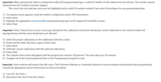

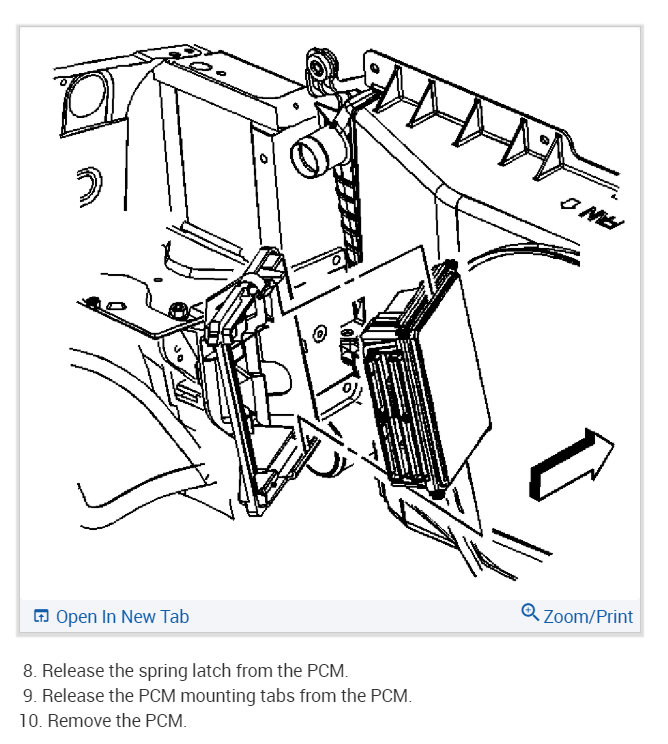

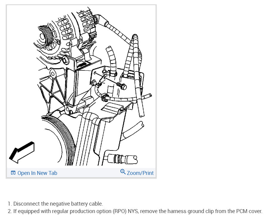

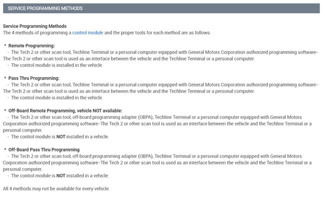

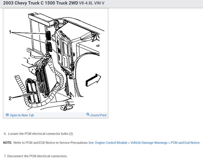

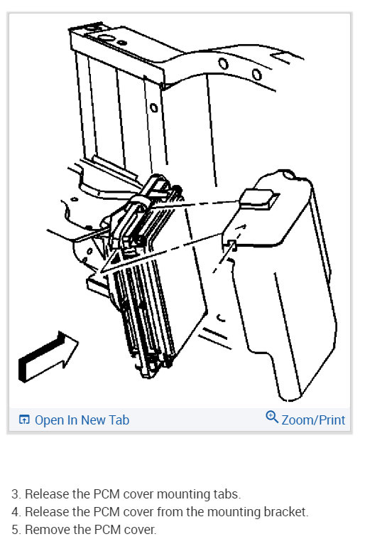

How does the engine wiring look, in good shape? With this many problems and codes, it sounds like the PCM is bad. To be sure let's do a CAN scan which is the future of automotive repair you can get a CAN scanner from Amazon for about $30.00. here is a video to show you how and a link to a scanner from Amazon:
https://youtu.be/u-4syLc-ifQ
and
https://amzn.to/3OpAotj for the scanner

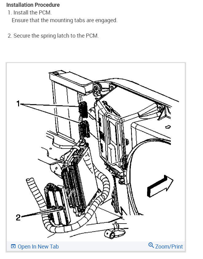

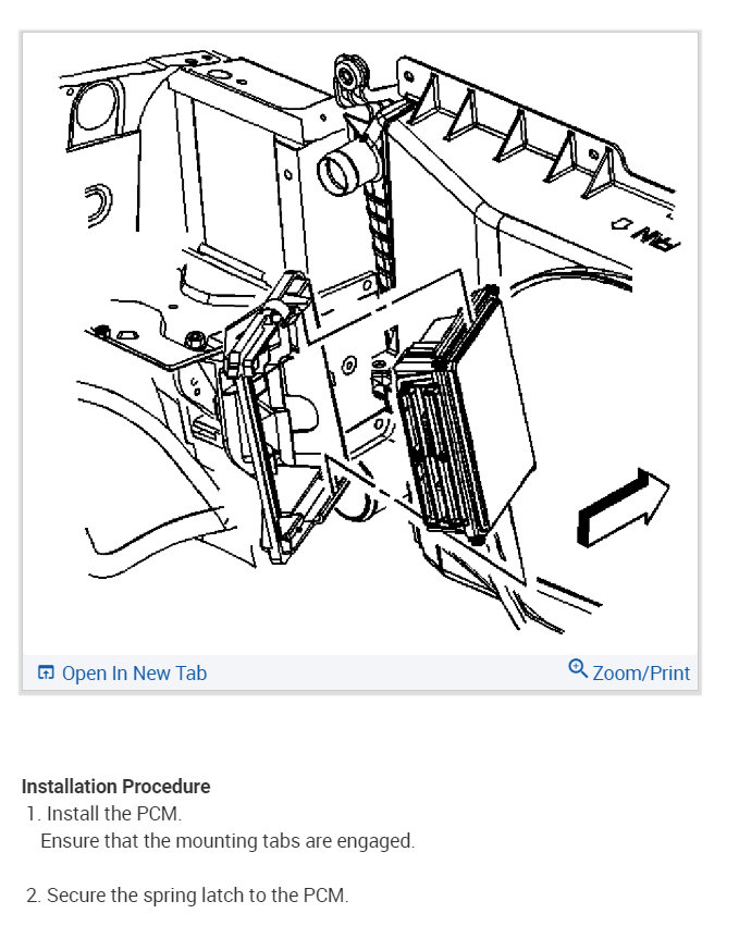

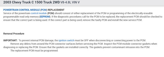

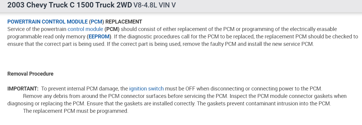

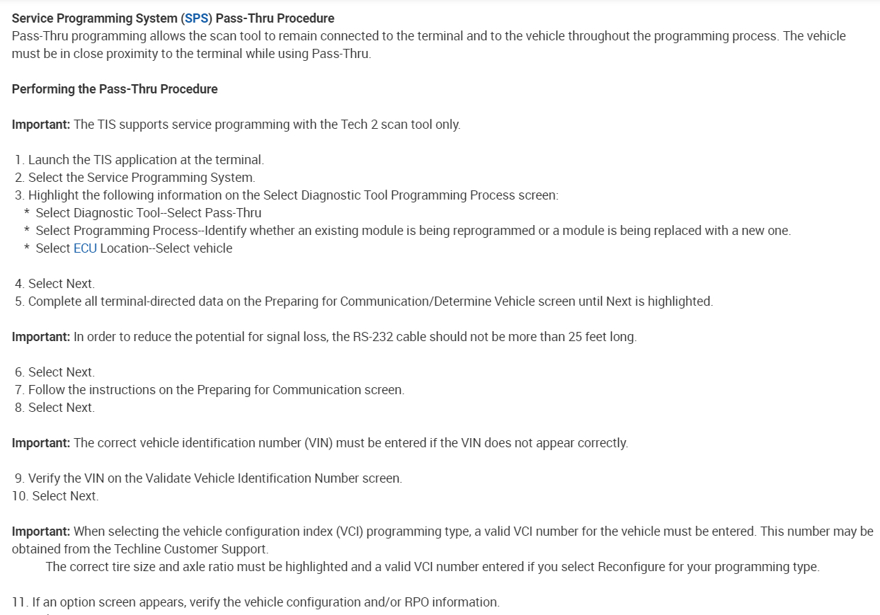

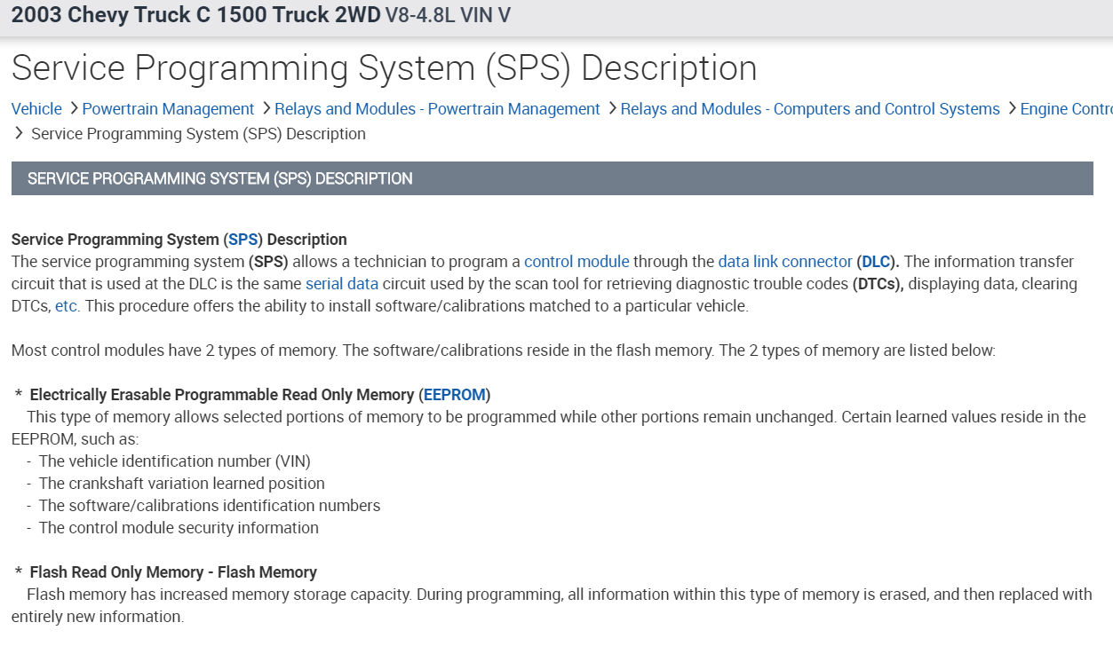

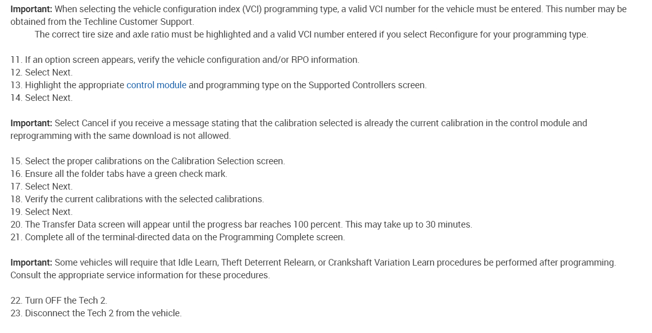

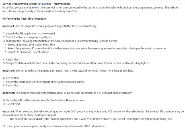

Also try to clear the codes, then shut the key off, then turn the key on without starting or cranking the engine over and then run the codes again to see what comes up. Check to make sure the engine and body have a good ground as well. Here is how to replace the PCM in the diagrams below.
