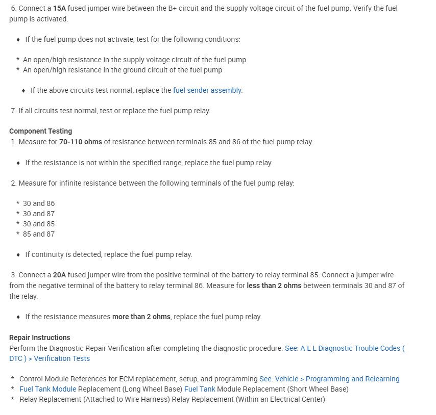

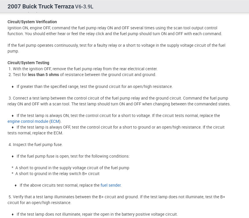

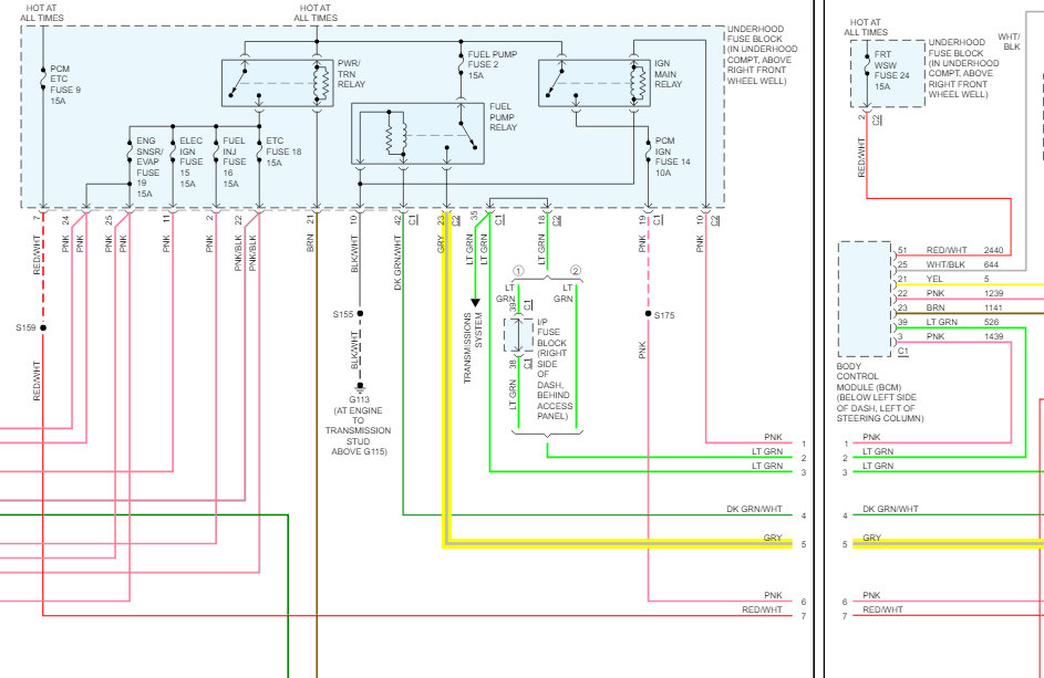

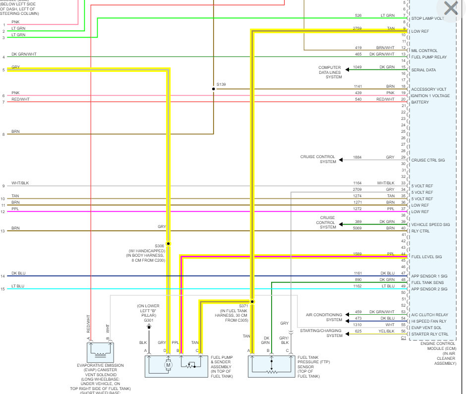

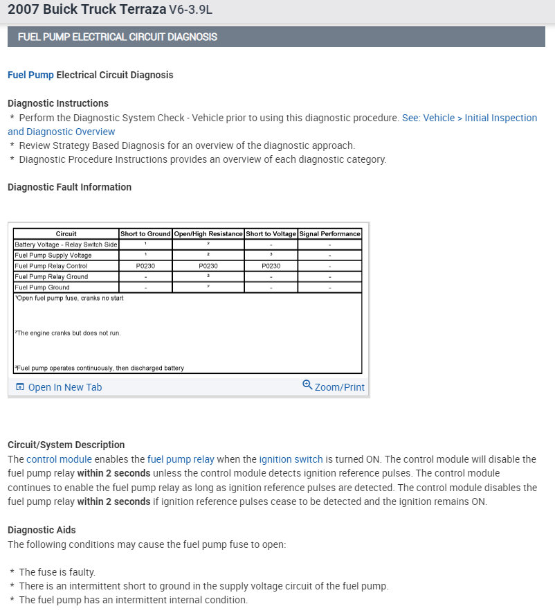

So, you are down to either a bad pump or faulty wiring.
I have attached the wiring schematics for this vehicle below.
Also included is the test procedure, which can help you determine the issue.
Let me know of any questions.
