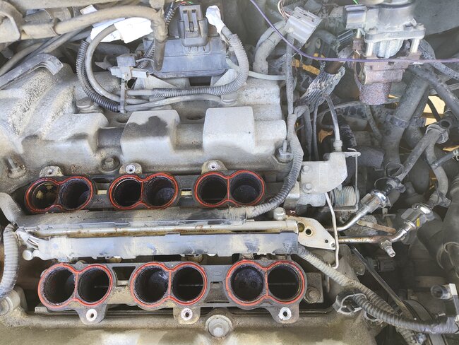

My old vehicle listed above starts and runs great but once it warms up the fuel pressure drops off and it almost stalls (or will stall) if I press the accelerator. I've replaced the fuel pump/filter unit to no avail. I've replaced the throttle control sensor and fuel pressure regulator sensor without any change. Where should I look next?

I don't have a fuel pressure tester so I'm witnessing it on the return line before the tank as the gas pours into a jar, when cold there is a lot of gas moving through the system when warm almost nothing. Yes, when it stalls (only happens if I keep the accelerator pinned) it starts right back up and drives normally for a minute or so.

Cold
Aug 17, 2024 at 12:38 PM
KAMORLE
  • 5 POSTS
Warm
Aug 17, 2024 at 12:40 PM

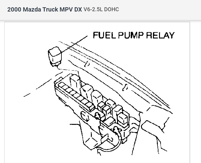

One other thought. Switch the fuel pump relay with a different one in the box having the same part number. See if that changes things at all.
joe
See pic below.

I've actually tried running the pump directly off a separate 12v battery to no change just to rule out any electrical issue. At this point I'm experimenting with the fuel regulator attached to the fuel rail.

If the pump is making constant pressure, the only thing left would be the regulator. How are you checking it?
