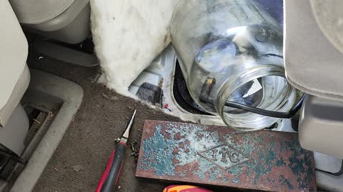

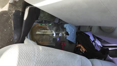

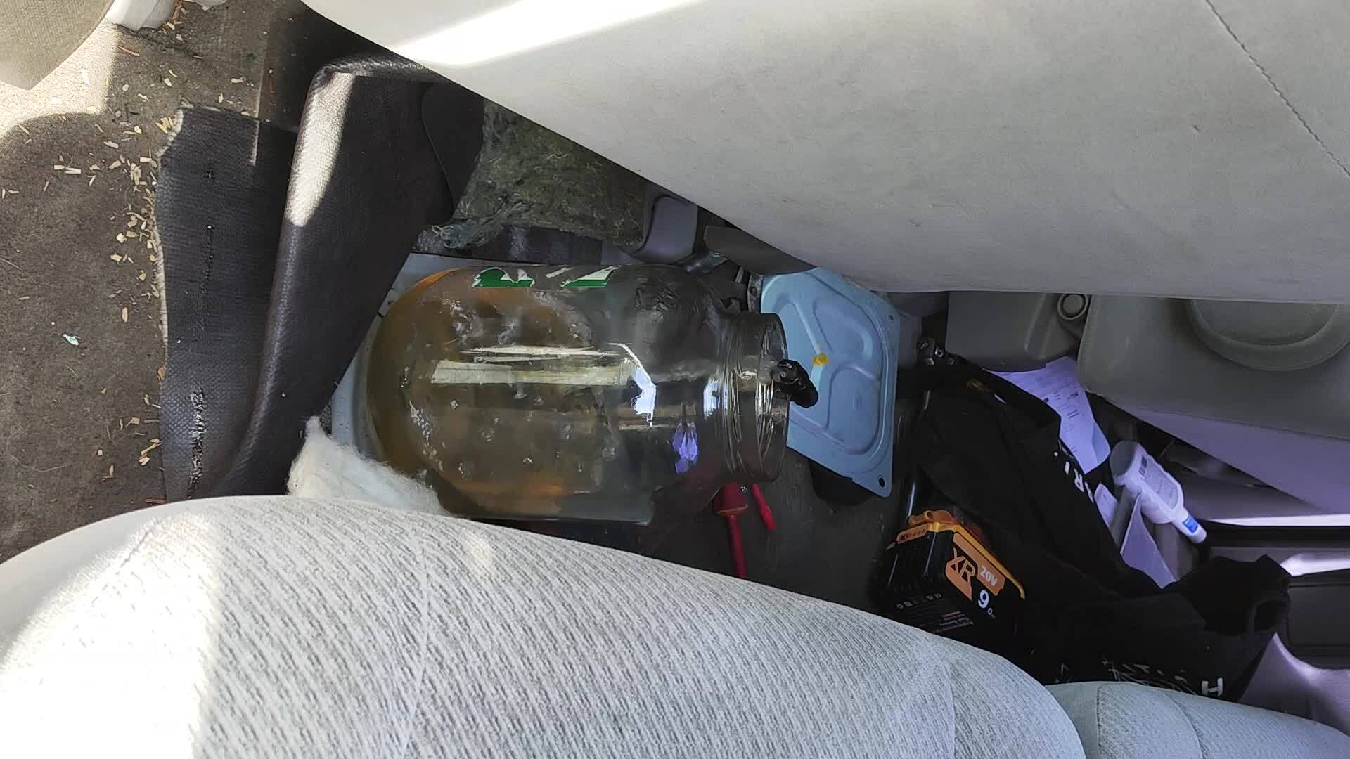

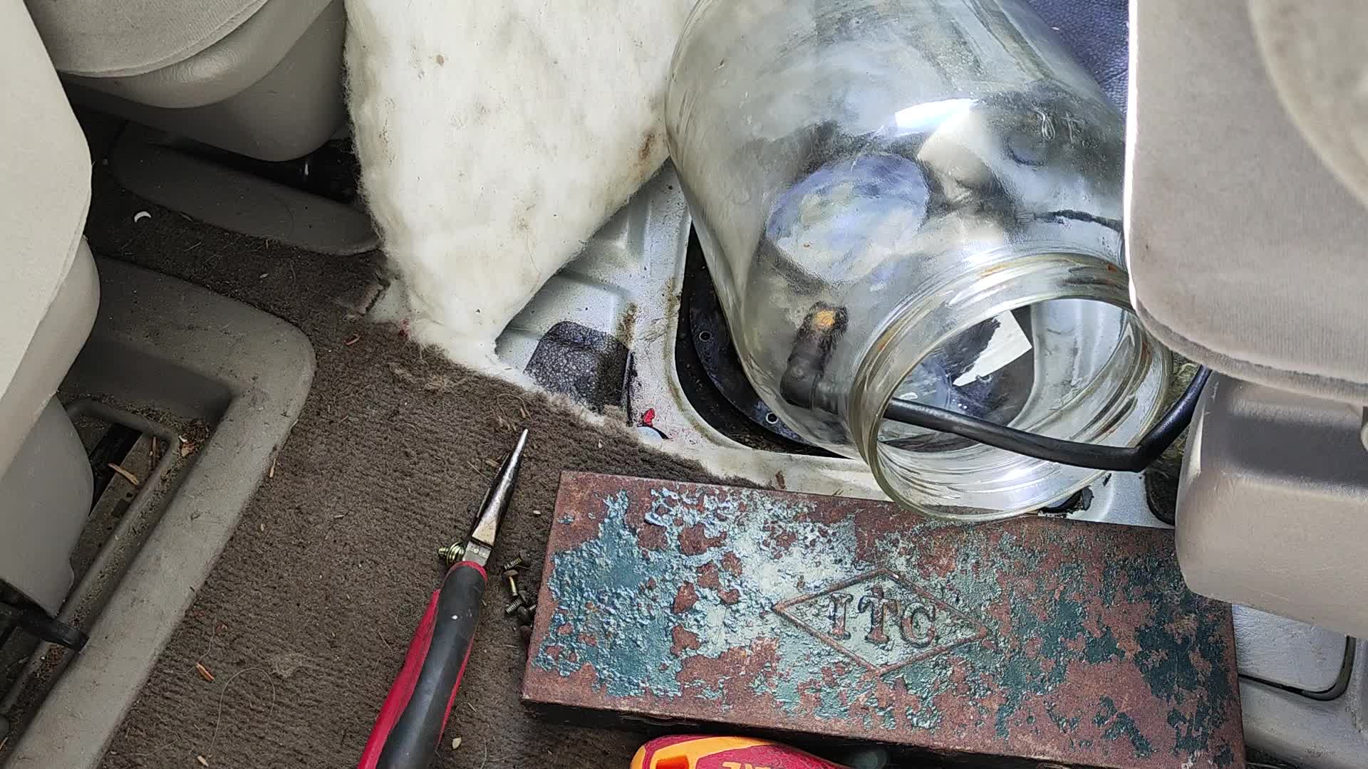

I don't have a fuel pressure tester so I'm witnessing it on the return line before the tank as the gas pours into a jar, when cold there is a lot of gas moving through the system when warm almost nothing. Yes, when it stalls (only happens if I keep the accelerator pinned) it starts right back up and drives normally for a minute or so.
Aug 17, 2024 at 7:35 PM
KAMORLE
  • 5 POSTS
Cold
Aug 17, 2024 at 7:38 PM
KAMORLE
  • 5 POSTS
Warm
Aug 17, 2024 at 7:40 PM

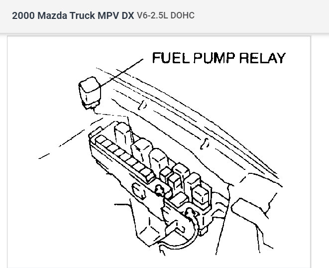

I see what you are referring to. What I suggest is this. Since the pressure drops when the engine is warm, compare the voltage at the pump under cold conditions and then again when it is warm. Just be careful not to cause any sparks.
Let me know if there is a difference. Other than trying this, we need to get a fuel pressure gauge. Most parts stores will lend one to you.
Also, let me know if there was no change when you replaced the pump. In other words, is it doing the same thing as before?
One other thought. Switch the fuel pump relay with a different one in the box having the same part number. See if that changes things at all.
joe
See pic below.
Aug 17, 2024 at 8:02 PM

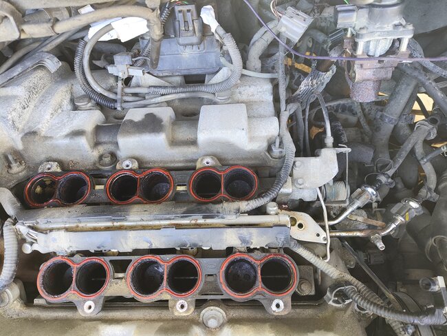

I've actually tried running the pump directly off a separate 12v battery to no change just to rule out any electrical issue. At this point I'm experimenting with the fuel regulator attached to the fuel rail.
Aug 17, 2024 at 8:07 PM
  • 110,194 POSTS
If the pump is making constant pressure, the only thing left would be the regulator. How are you checking it?
