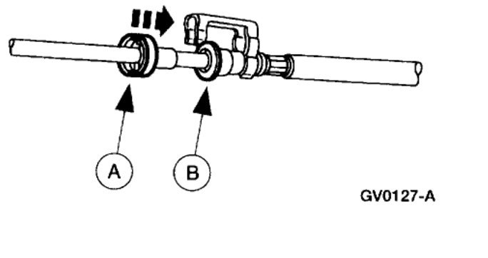

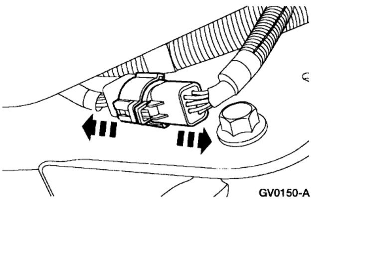

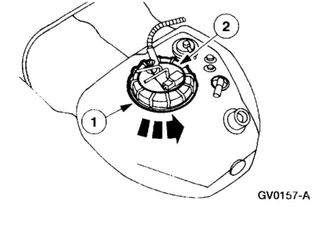

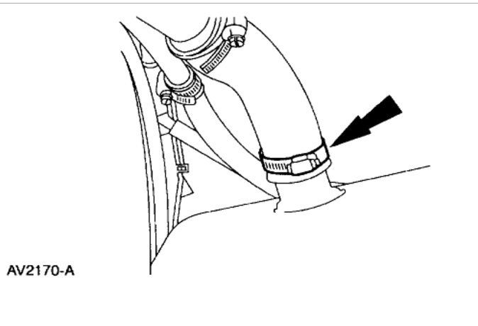

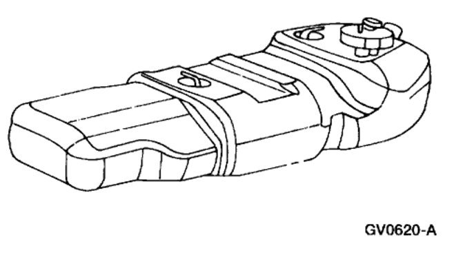

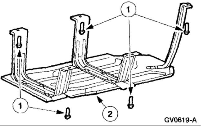

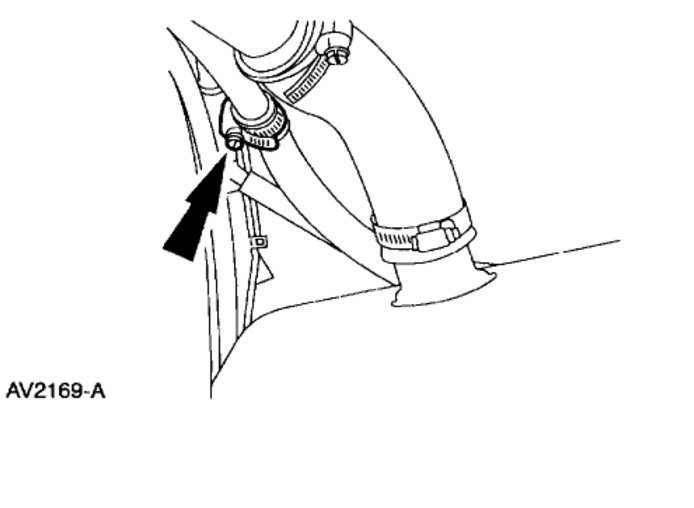

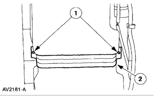

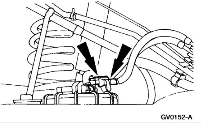

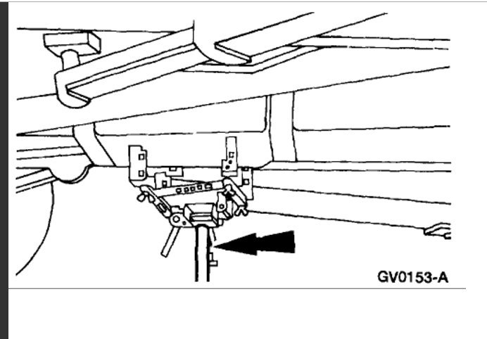

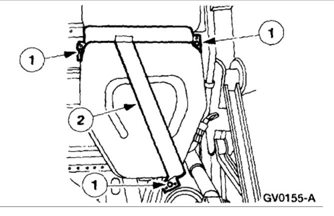

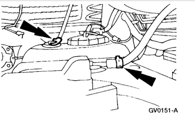

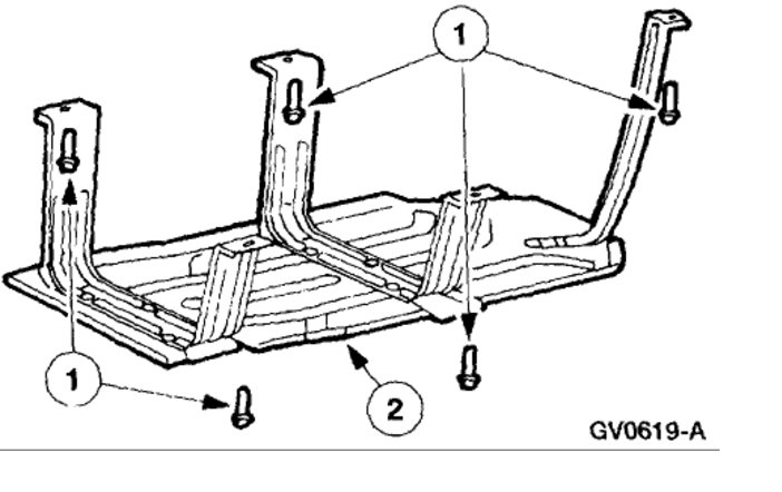

Where is the fuel control module?
Jul 13, 2017 at 1:23 AM
Experienced Mechanic
55,682 POSTS
The fuel pump module is in the tank, here are some guides and some diagrams (below) that will show you what you are in for when changes the unit out.
https://www.2carpros.com/articles/how-to-replace-an-electric-fuel-pump
and
https://youtu.be/Q5MH2gnyFH0
Images (Click to enlarge)
