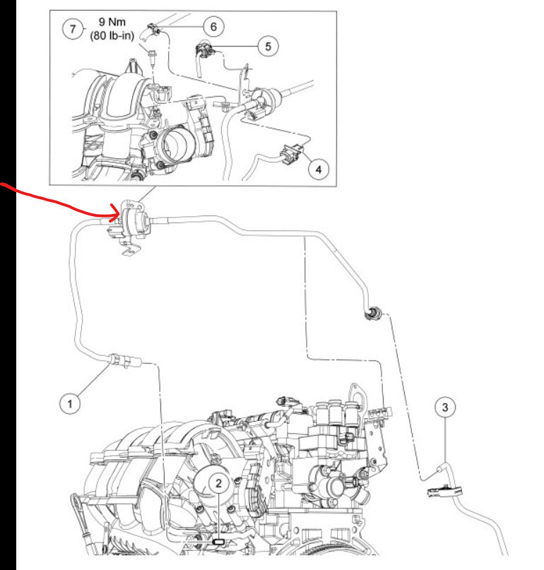

I have seen the EVAP purge solenoid stick open and cause the fuel to be ingested into the engine. Here is the location of the valve, I would remove it and see if you can blow through it, if so, the valve is bad and needs to be replaced.
Check out the images (below). Please let us know how it goes.
