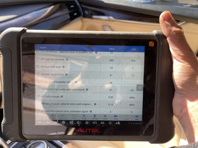

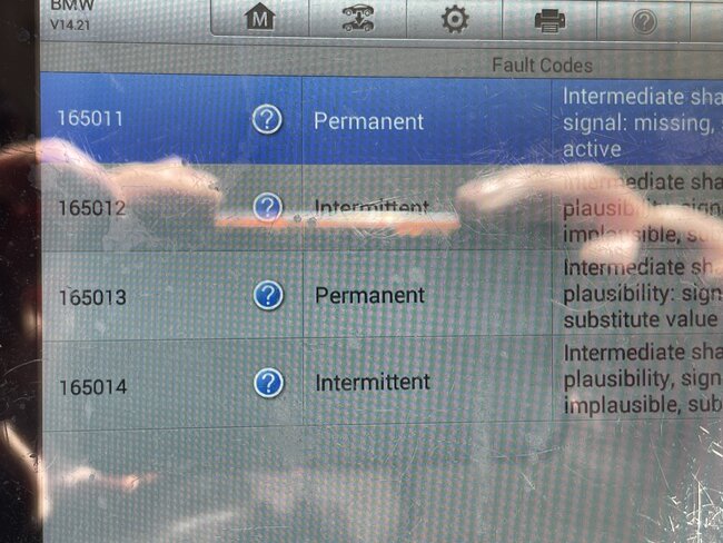

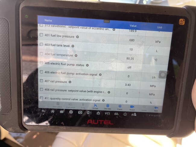

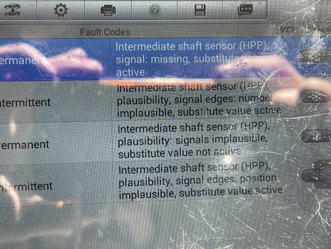

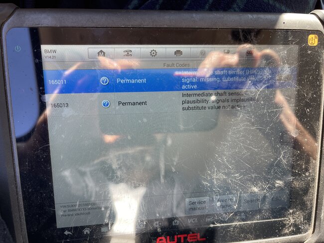

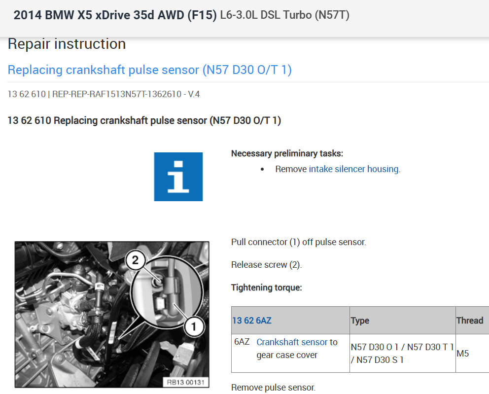

If i delete the codes i get the 2 in the picture. Some readings for engine off and then on.

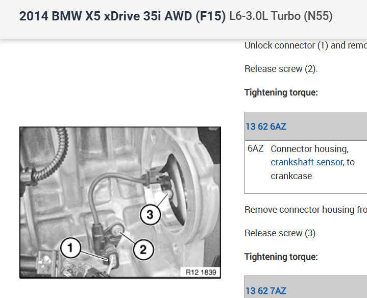

The 165011 and 165013 diagnostic trouble codes (DTCs) for a 2014 BMW X5 typically refer to issues related to the crankshaft position sensor and valvetronic system. How does the engine seem to run, can you unload a video? Here is the location of the crankshaft sensor which I would replace and then clear the codes. Check out the images (below). Let us know what you find.

Engine runs smoothly with no issues. The instructions are for the diesel motor. I have gas inline 6-cylinder N55 motor. No leaks or other issues.
Jan 2, 2025 at 2:43 AM

My bad, sorry, here you go. Check out the images (below).
