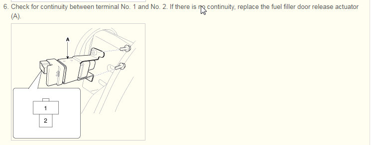

When you press the button can you hear the actuator click?

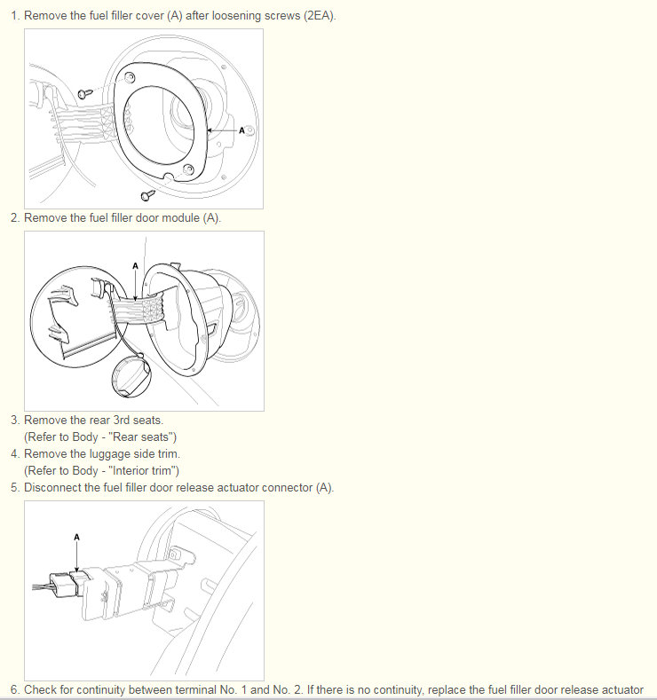

If so, sounds like the fuel door actuator is sticking. Unfortunately, the manual that we use does not provide a process to replace this on your specific vehicle. However, I did find a general process online.
Here is the part number of the actuator:
MDX5056890A
You can check the continuity like it states to do but this is to test for a failed actuator so if may pass this test. However, if it is not clicking when you press the button then it may fail this test.
Let us know what you find. Thanks
