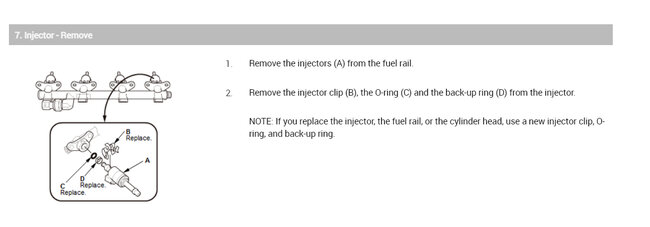

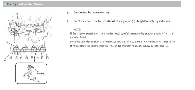

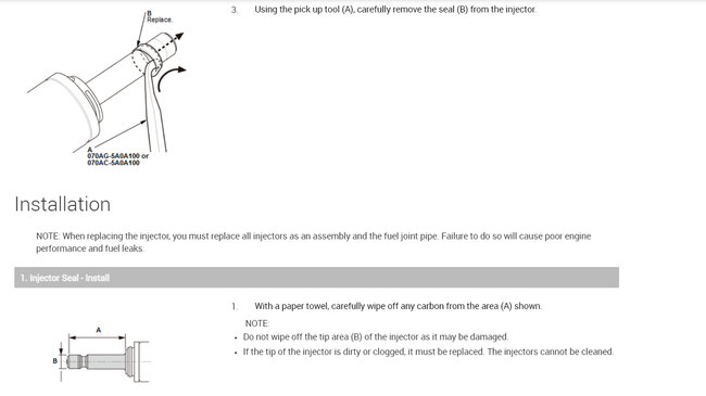

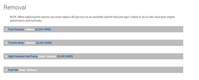

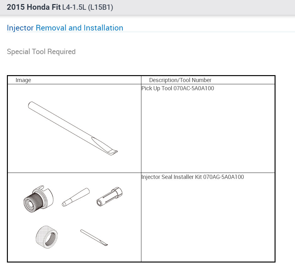

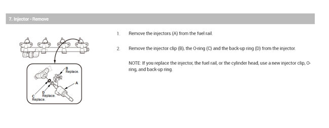

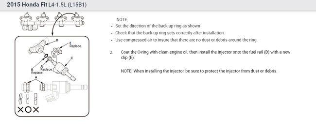

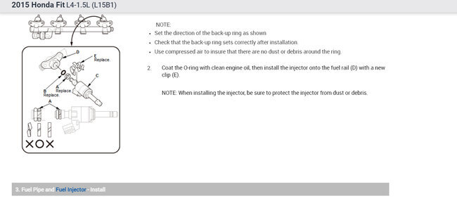

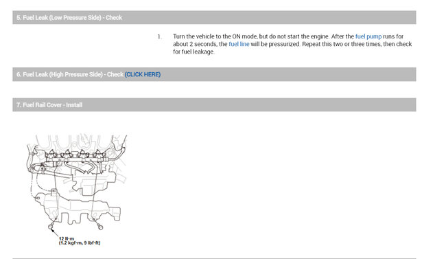

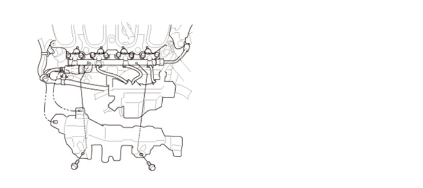

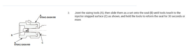

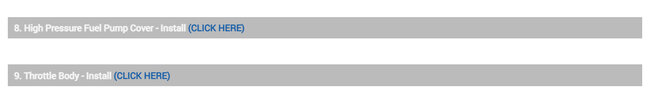

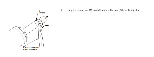

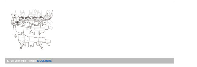

It sounds like the engine is misfiring and the oxygen sensor is picking that up with a lean code which is normal, I would do a compression test in cylinder number 4 which is sounds like the injector is bad if the compression is good. Here is a guide to help with the test and how to change the injector out in the images below in case you need it:
Remove the fuel pump relay and run the engine until it stalls to relieve the high-pressure fuel pump. Check out the images (below). Please let us know what happens. Also, I would service the throttle body as well.

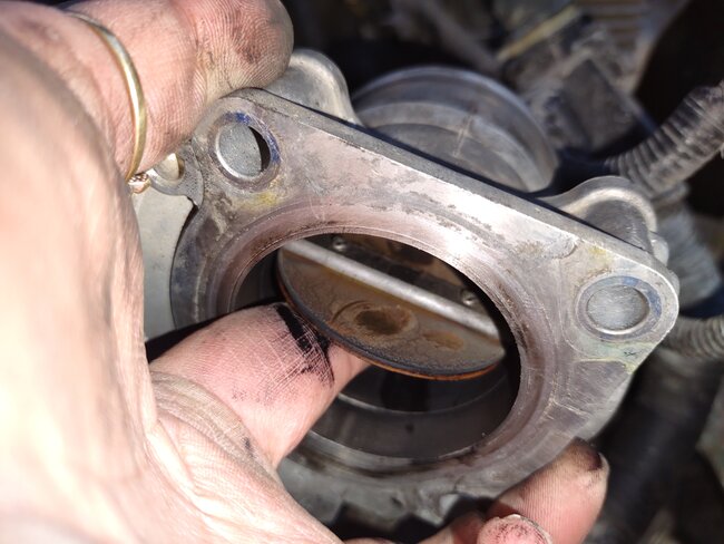

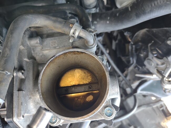

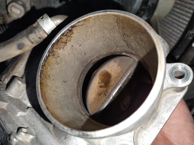

Sorry it's taking so long to get back to you or to work on the car for that fact. My hood flew open when I was doing 60 MPH down the highway and shattered my windshield, so I haven't had to work on car until I got the windshield fixed. But I think I may have found the problem thanks to your guys' advice. I'm hoping it is the solution though. I decided to clean the throttle body first because the fuel injection thing was way too advanced for me LOL but I will upload pictures and let you see what I'm seeing.

Sorry to hear about the hood flying open, that is always scary. Yes, the throttle body is dirty so cleaning it should help. Please let me know how it goes.

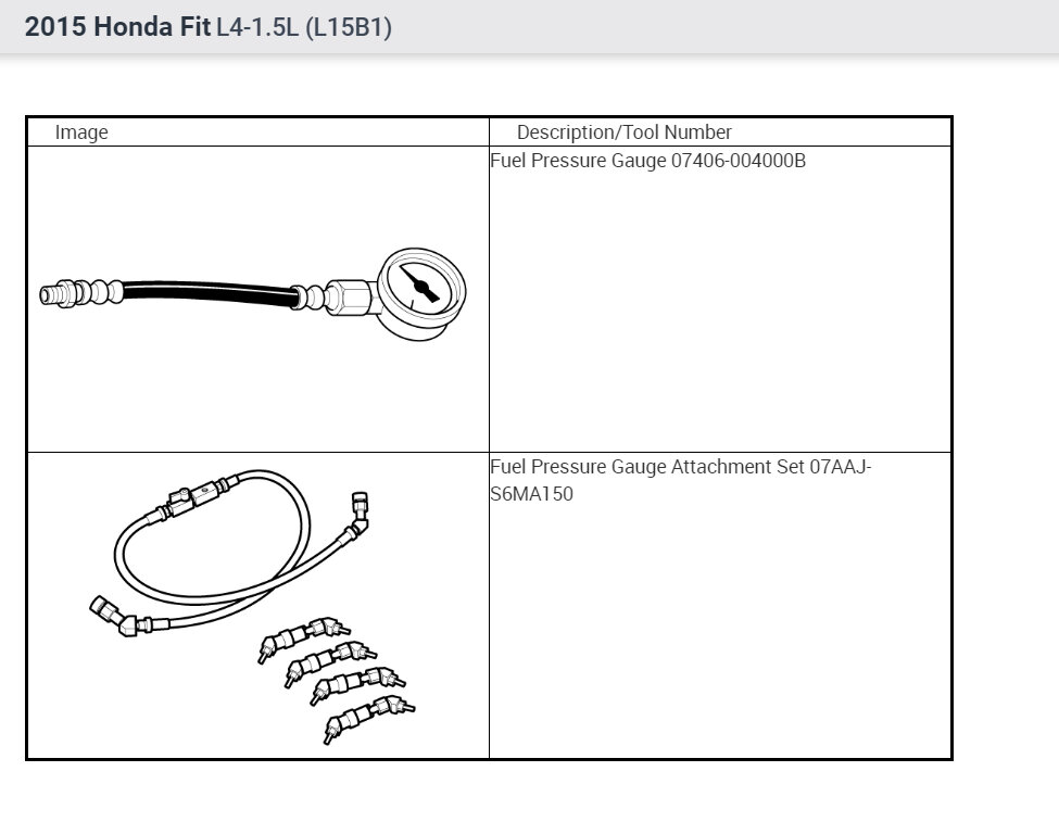

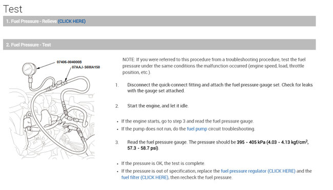

I think we should check the fuel pressure, here is a guide to help and the fuel pressure specs as well. You can rent a fuel pressure test kit from the auto parts store for free or cheap.

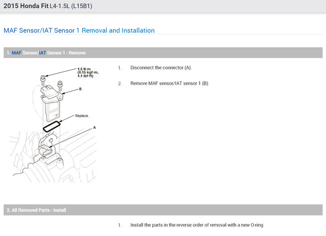

Please check the images below, I have also seen the MAF sensor being bad can cause this issue as well. Check out the images (below). Please let us know what happens.

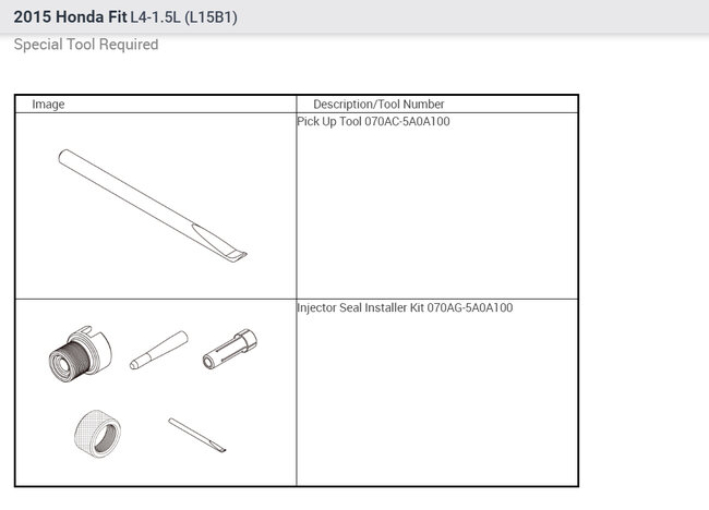

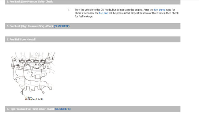

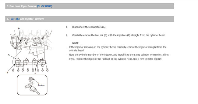

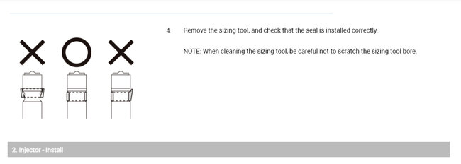

  • 55,808 POSTS

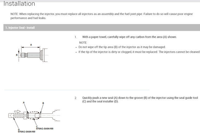

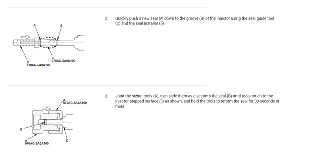

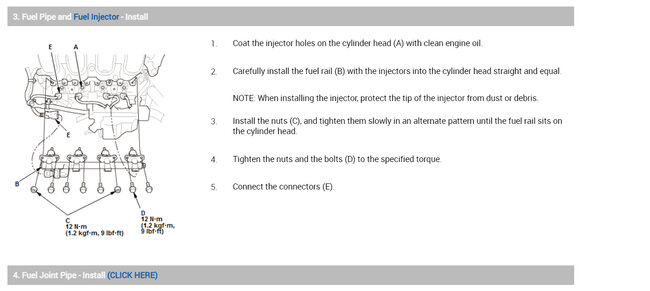

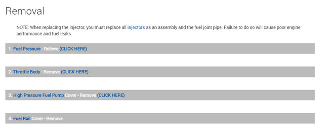

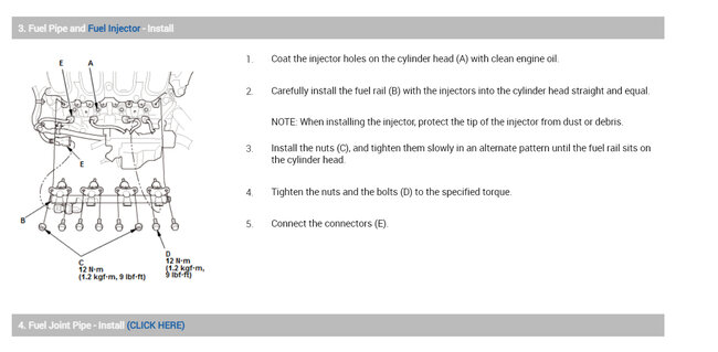

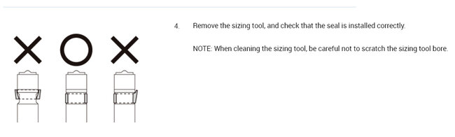

Not really, one is high pressure and the other is low pressure, I would purchase a new injector. Here is how to change the injector out. Check out the images (below). Please let us know what you find.
May 5, 2023 at 3:43 AM
SBUCHANAN
  • 18 POSTS
Okay, so, I've replaced the fuel injector and at first it started beautifully wasn't misfiring drove it for a little bit and now it is starting to cut out again not as often as before, but it is. It still throws a code for a cylinder misfire saying the air fuel ratio. When it starts to cut out, I'm able to downshift and then it usually stops but I have to downshift a lot like it's not shifting gears right still and that is when I'm in regular drive mode it does the same thing and sport mode also. I don't get it.

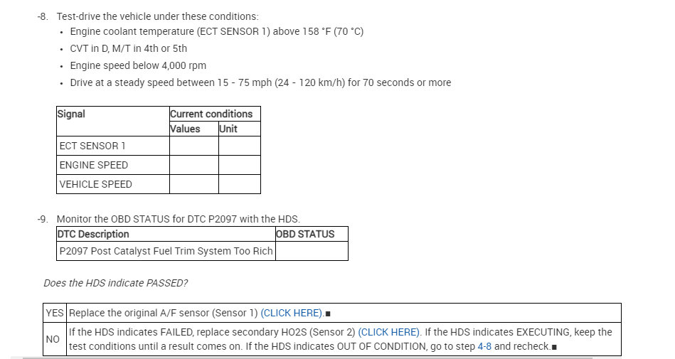

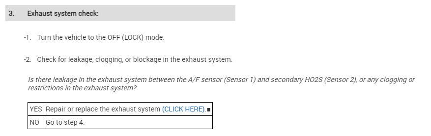

It's starting to run better, however it still cuts out every now and then. Usually, I just give it more gas or let off the gas and it stops but doesn't go into limp mode like it was before. Seems to do it most when going up hills. Throws code for cylinder misfire in same cylinder still and P219a and P2097 now.
May 30, 2023 at 1:55 AM

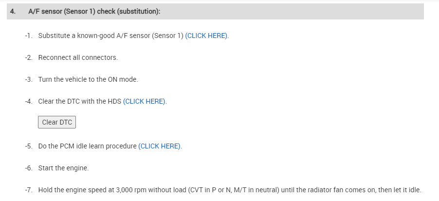

  • 110,251 POSTS

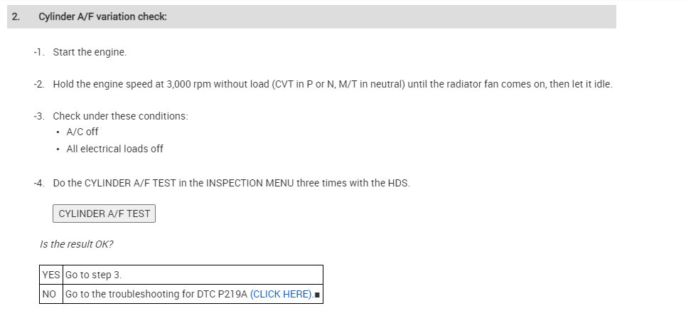

Code P2097 leads me to P219a. I attached the diagnostics below. Take a look through them and let me know if you are comfortable performing them.
See pics below. Note: When I go to the P2097, it walks me through one step and then asks if the P219a is present. If it is, that is where it indicates to go next.
