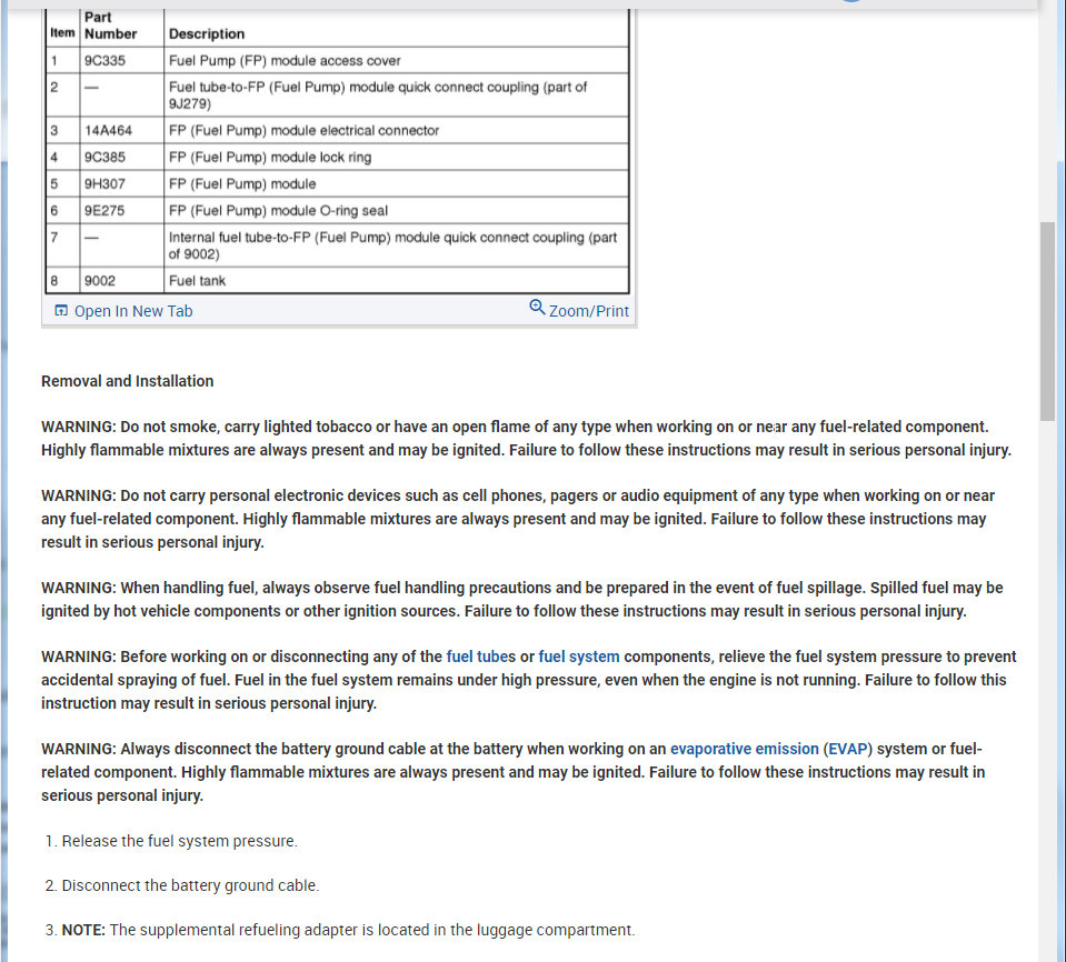

Someone put a sandwich bag with rice in the tank. I pulled the bag out and it broke and spilled the rice down inside the tank. I went to the gas station and tried to put gas in, but the nozzle kept clicking off and would not take any gas. Then the engine just stalled I checked and the fuel pump stopped working.
Feb 6, 2017 at 4:15 PM

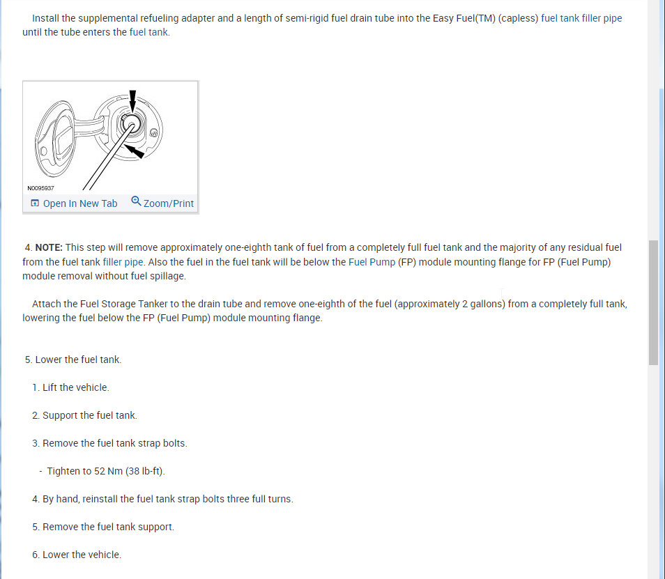

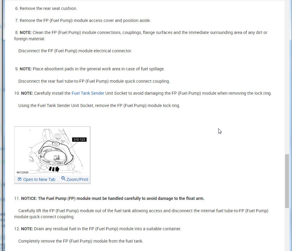

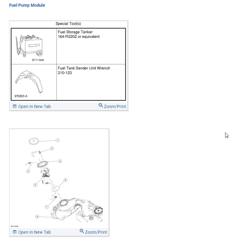

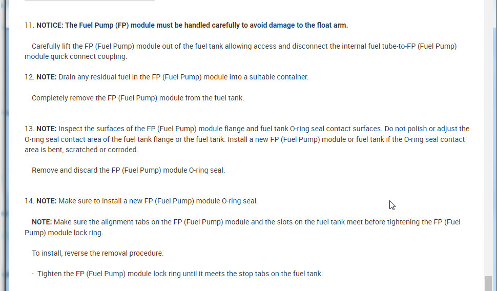

That is a shame that this happened. Here are some guides that will help with step by step instructions:
https://www.2carpros.com/articles/how-to-replace-an-electric-fuel-pump
Below is the process from the manual that will give additional details. Please let us know if you have other questions and how this turns out.
