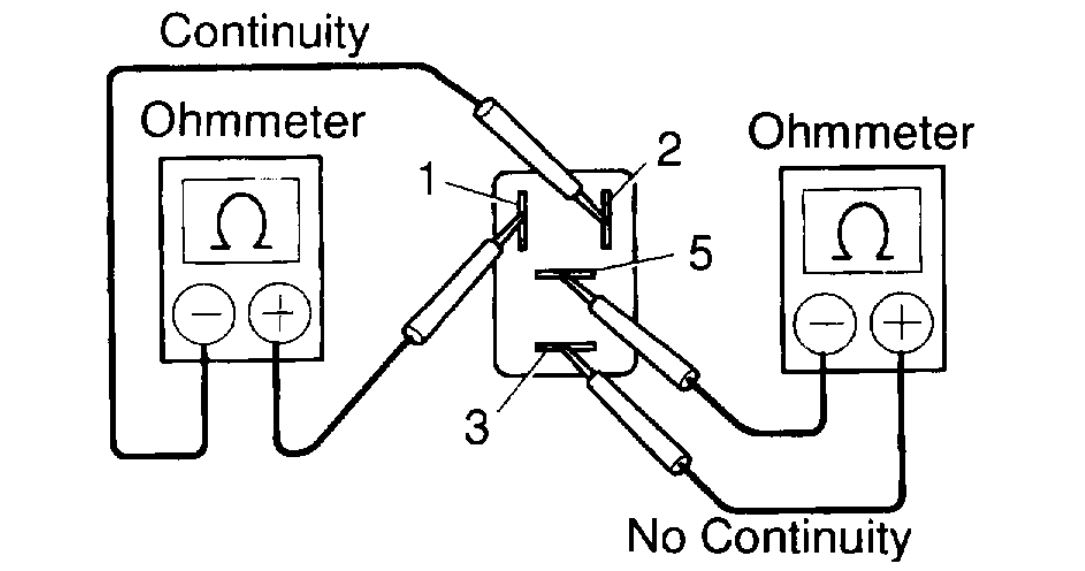

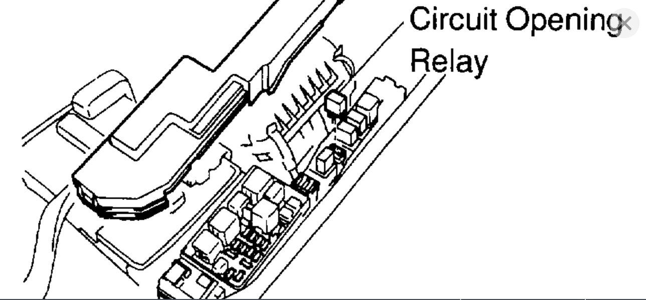

Probably failed fuel pump. However, I wanted to see about location of any relays and or inertia switch on this model. Car was working fine parked and twenty minutes later when I went to leave it would not start.

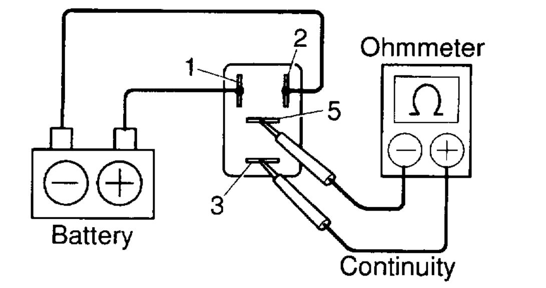

I attached a picture of the location and how to test the relay.
There is no inertia switch.
Have you verified power to the pump?
1. REMOVE RELAY BOX COVER
imageZoom/Print
2. REMOVE CIRCUIT OPENING RELAY
(Marking: CIR OPN)

3. INSPECT CIRCUIT OPENING RELAY CONTINUITY
(a)Using an ohmmeter, check that there is continuity between terminals 1 and 2.
If there is no continuity, replace the relay.
(b)Check that there is no continuity between terminals 3 and 5.
If there is continuity, replace the relay.
imageZoom/Print
4. INSPECT CIRCUIT OPENING RELAY OPERATION
(a)Apply battery positive voltage across terminals 1 and 2.
(b)Using an ohmmeter, check that there is continuity between terminals 3 and 5.
