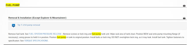

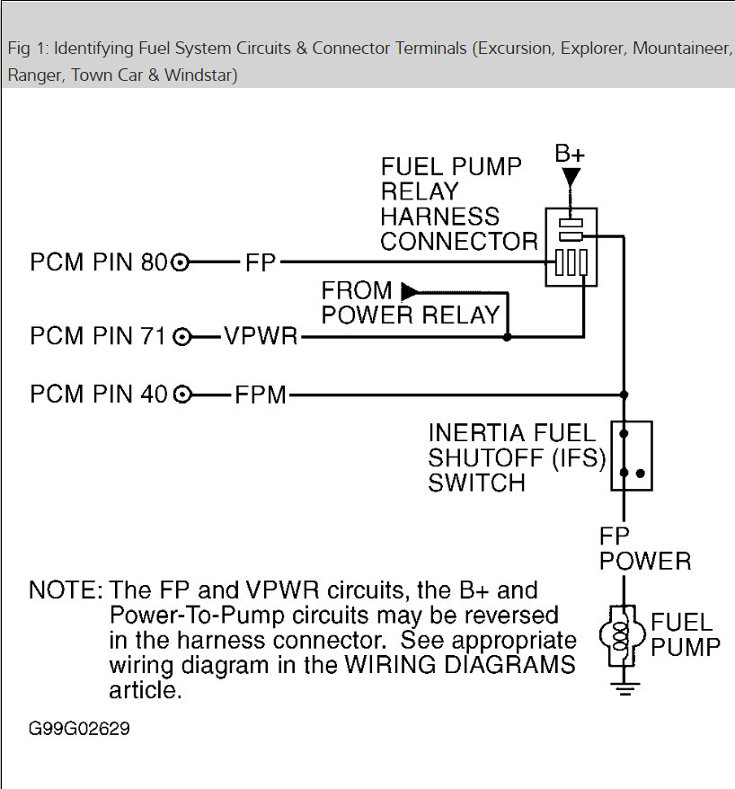

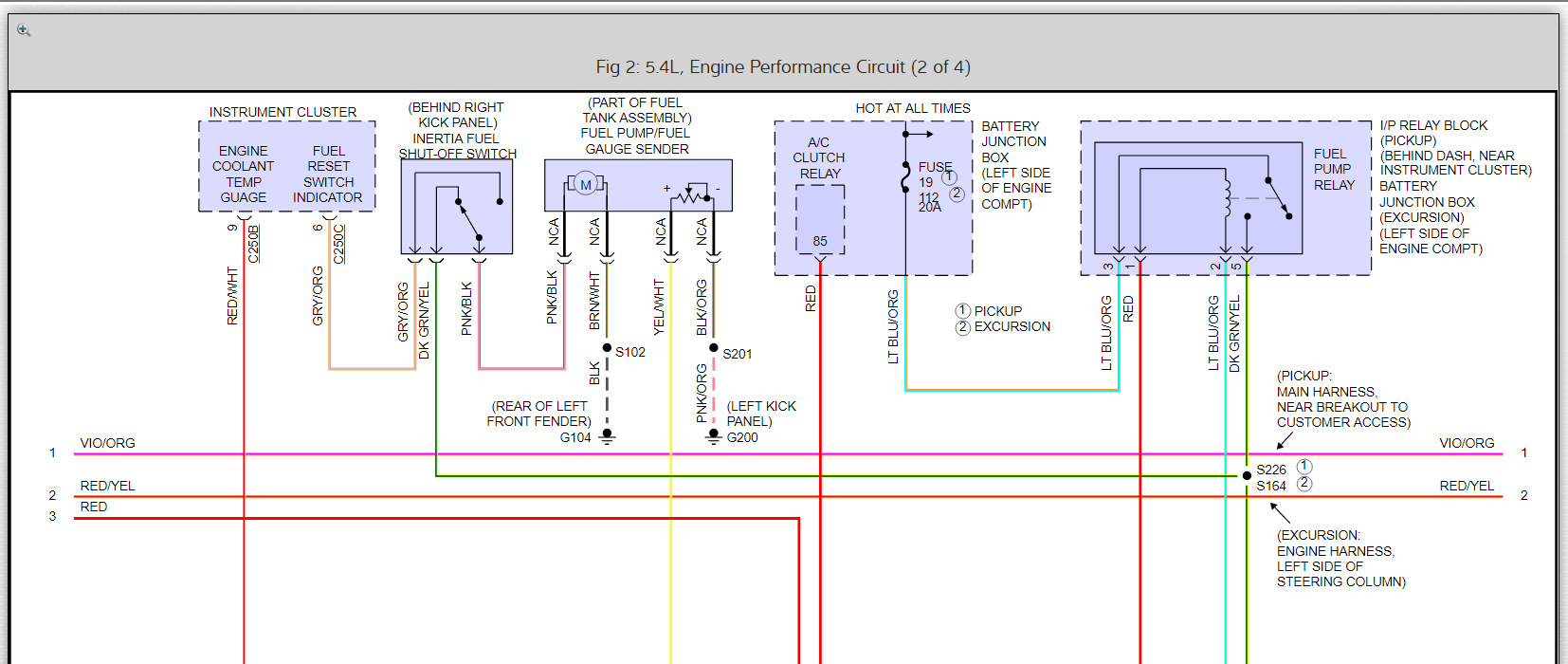

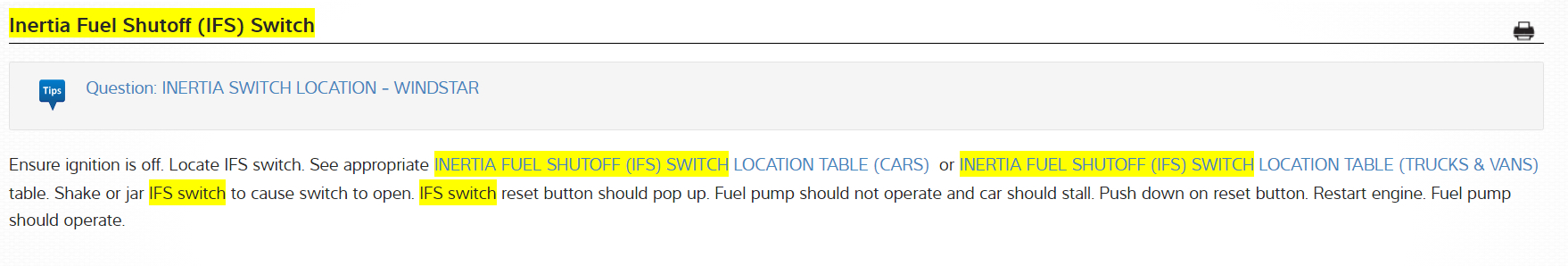

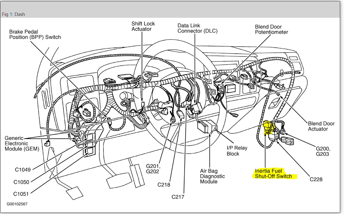

My SUV will not start. but it starts with starting fluid, but wont stay running. any ideas?
Feb 27, 2019 at 7:21 PM
SCGRANTURISMO
  • 4,897 POSTS

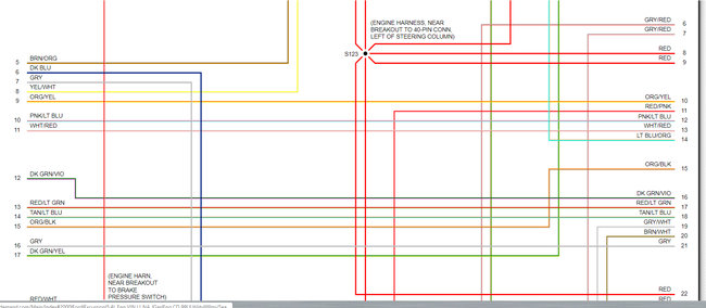

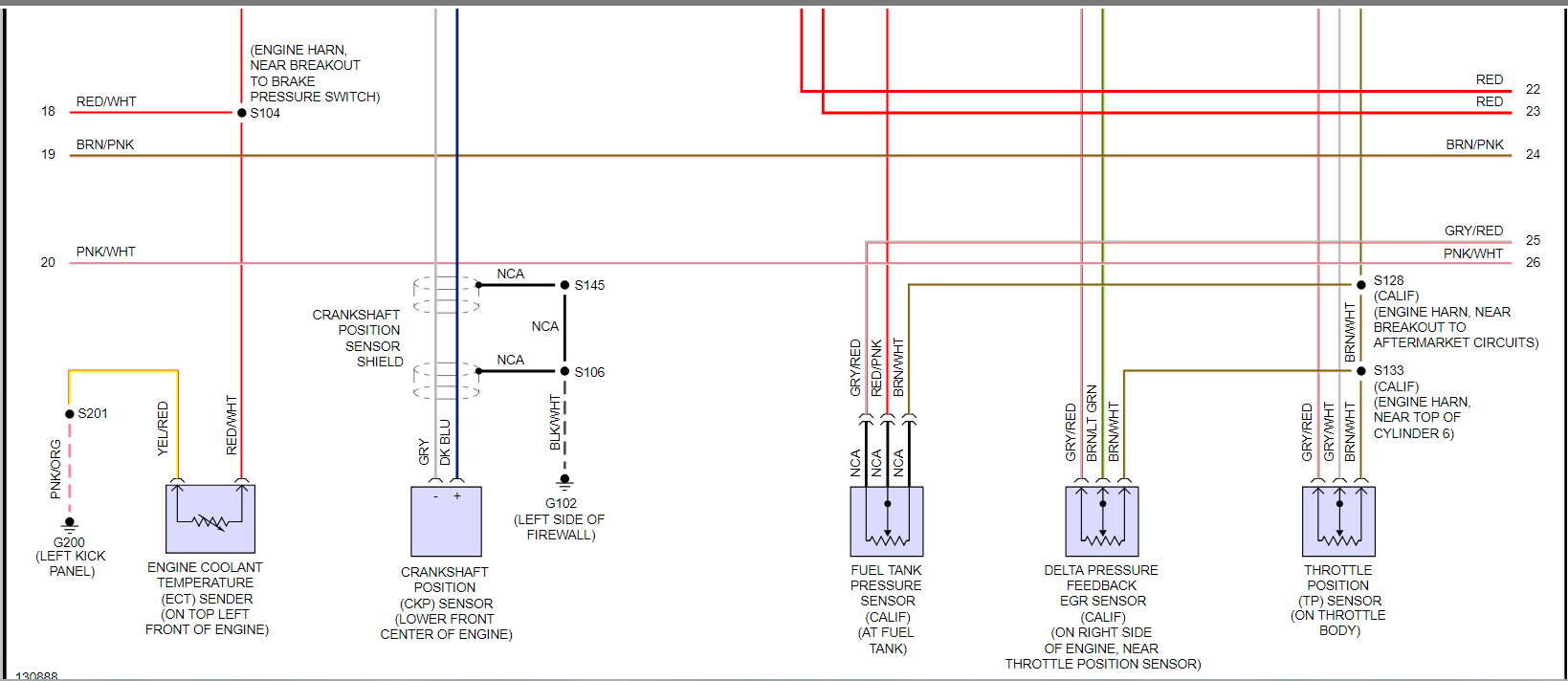

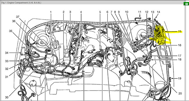

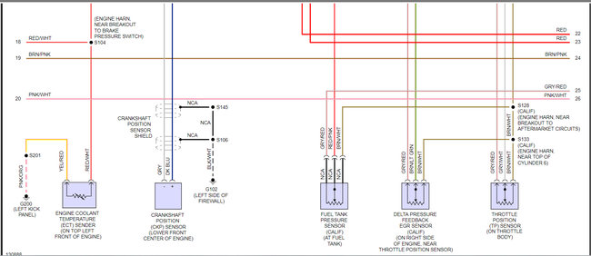

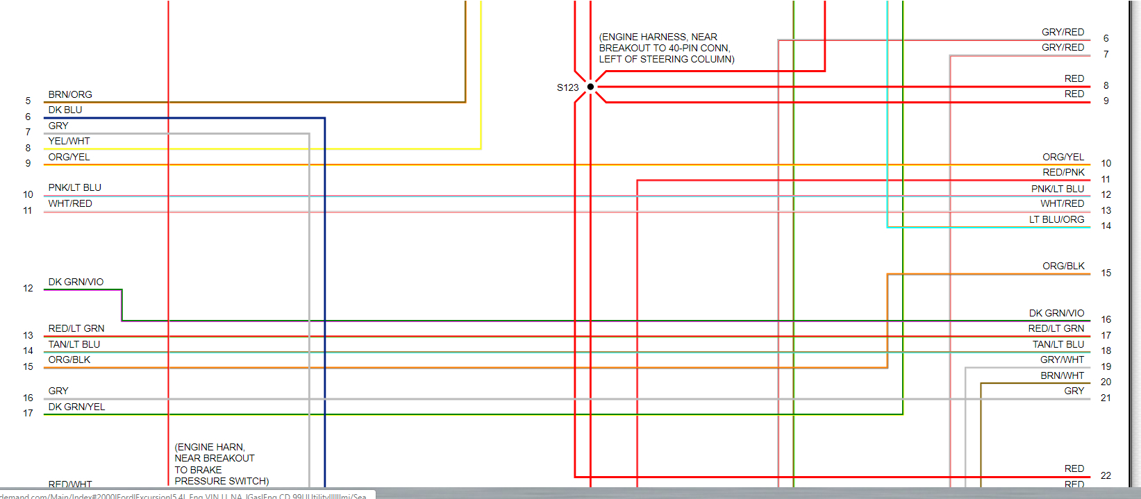

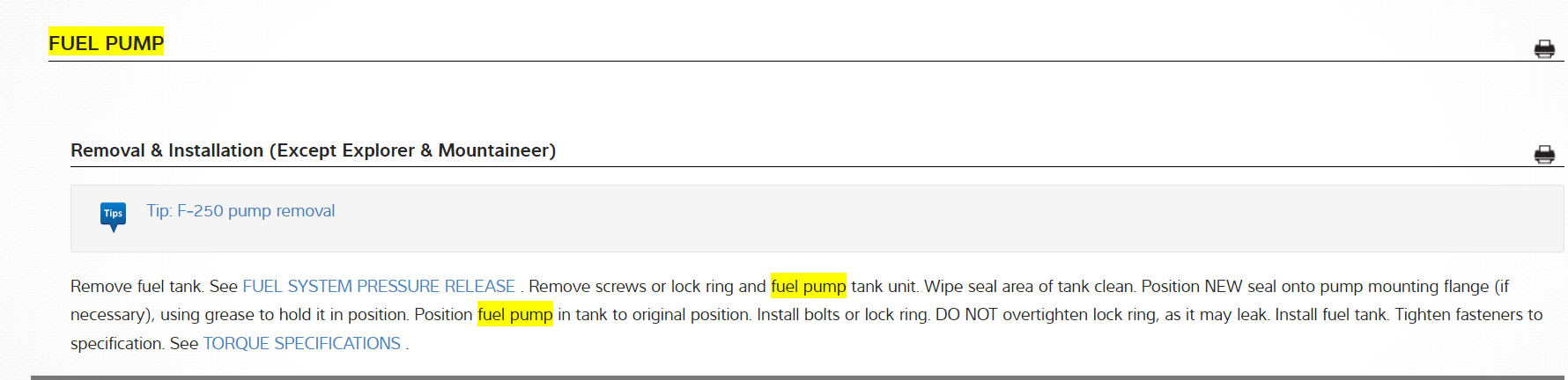

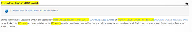

I want you to check the fuel pump relay, the inertial fuel cut off switch, and the fuel pump please, in that order.I have placed all pertinent information on your vehicle's fuel system in the diagrams down below. Get back to us and let us know what you find out.

I just found out that the vehicle has a security system on it. And the key I'm trying to use is a different key than it originally had the last time I ran. I believe I have to reprogram a key for the security system. thank you
