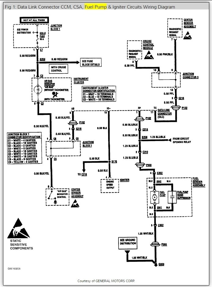

I cannot get power to my fuel pump.

That would pose a serious fire hazard. What are you trying to do or solve?

Hello CONNIE,
Here is a wiring diagram for you, please check the fuses and the relay
Here is a guide on how to do so
and
Let us know what you find
Best, Ken
