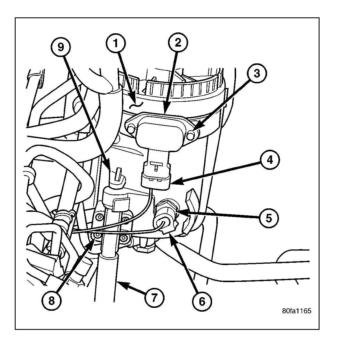

How low is the fuel level? If it is low, there could be enough dirt in the sock at the bottom of the fuel pump preventing the fuel from making it to the engine. When you turn sharp, the fuel in the take will surge in one direction.
Let me know. Since it is a diesel, it will likely be related to a fuel issue. I have a feeling it is dealing with the fuel pick up filter, but I will need more info.
If you haven't replaced the fuel filter, here are the directions for replacement. The attached pics correlate with the directions.

pic 1
Refer to maintenance schedules for recommended fuel filter replacement intervals.
Draining water from fuel filter/water separator housing:
The housing drain valve (9) serves two purposes. One is to partially drain the filter housing of excess water. The other is to completely drain the housing for fuel filter, drain valve, heater element or water-in-fuel sensor replacement.
The filter housing should be partially drained whenever the water-in-fuel warning lamp remains illuminated. (Note that lamp will be illuminated for approximately two seconds when ignition key is initially placed in ON position for a bulb check).
1. A drain hose (7) is located at the bottom of drain valve. Place drain pan under drain hose.
2. With engine not running, rotate drain valve handle counter-clockwise (rearward) to OPEN (DRAIN) position. Hold drain valve open until all water and contaminants have been removed and clean fuel exits.
3. If drain valve, fuel heater element or Water-In-Fuel (WIF) sensor is being replaced, drain housing completely. Dispose of mixture in drain pan according to applicable regulations.
4. After draining operation, rotate valve handle clockwise (forward) to the CLOSE position.

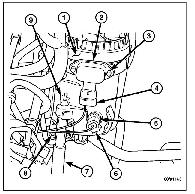

pic 2

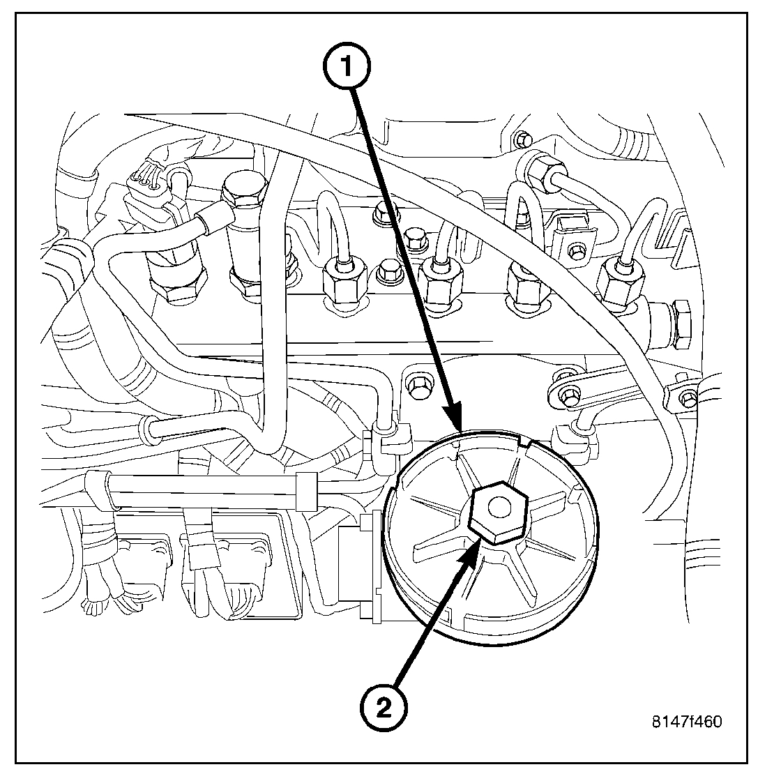

5. Fuel Filter Replacement: The fuel filter is located inside of the fuel filter housing.
a. Clean all debris from around canister.
b. Remove filter lid (1) using a socket. Attach socket to large hex (2) on top of lid. Rotate counter-clockwise for removal. Remove O-ring. Discard O-ring.
c. Remove filter element by twisting element sideways from filter lid.

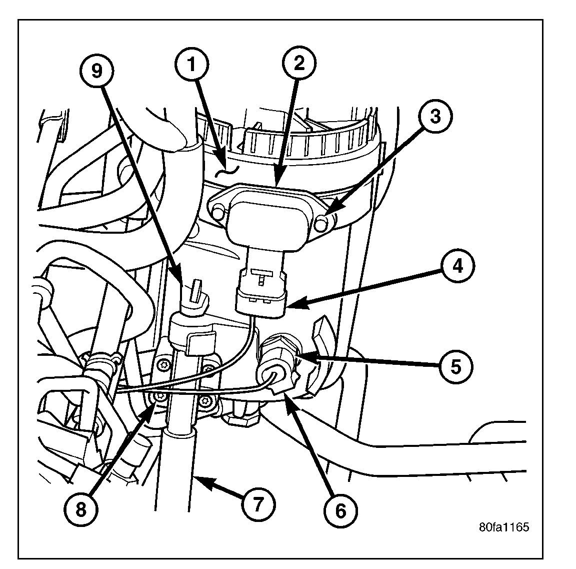

pic 3
6. Water-In-Fuel (WIF) Sensor Replacement: The WIF sensor (5) is located on the side of the fuel filter housing.
a. Disconnect electrical connector at sensor.
b. Clean area around sensor.
c. Remove sensor by rotating counter-clockwise.
d. Check condition of sensor O-ring. Replace if damaged.
