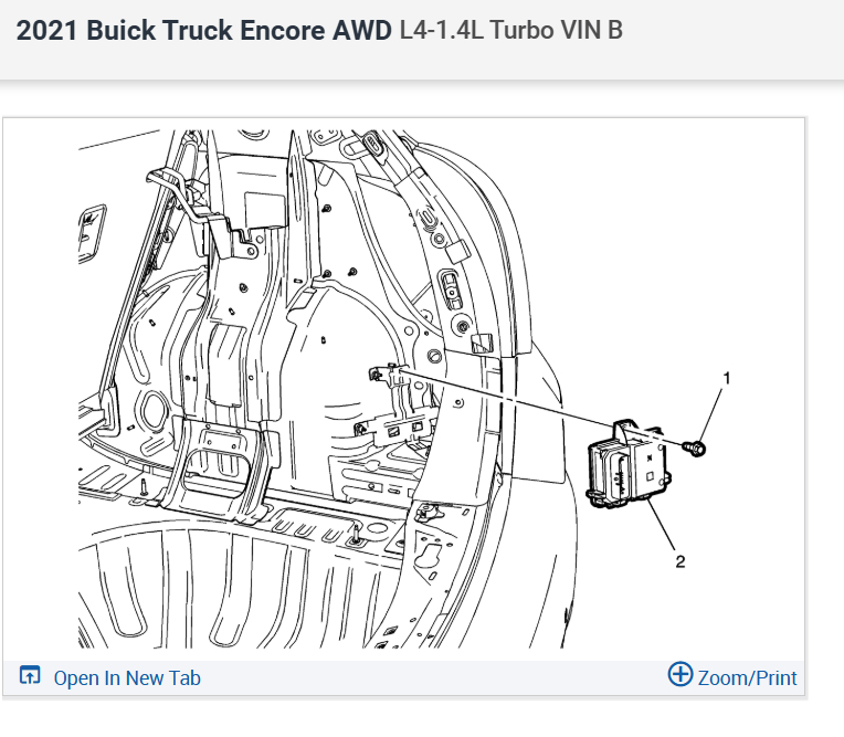

i have code u18a2 related to fuel pump driver control module, but i can't find where it is located. Can you give me that information? Thank you for your attention.

Sure the fuel pump control module is in the rear of the car on the passenger's side. Check out the images (below).
