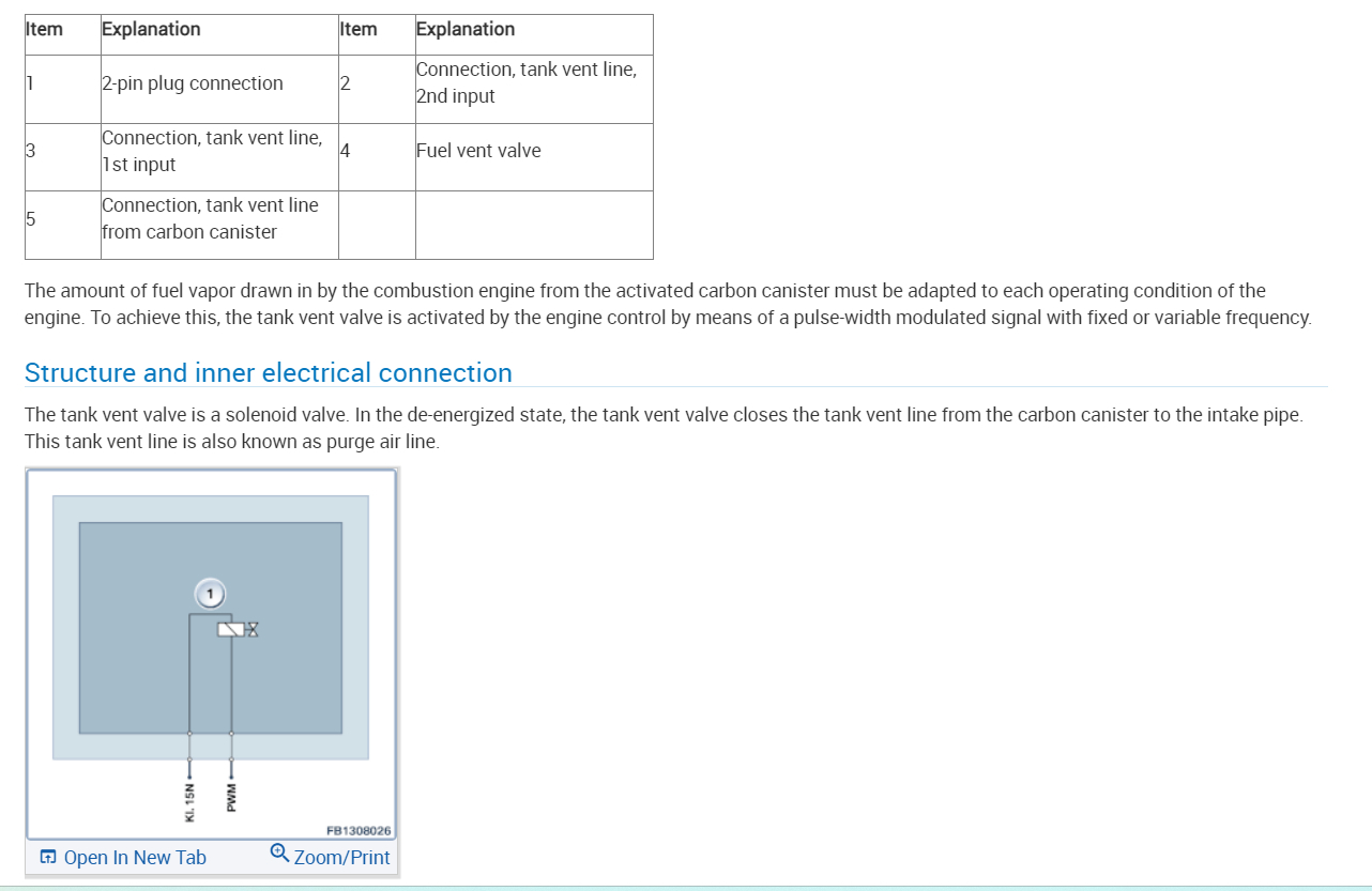

Issue when attempting to fill the fuel tank?
2015 MINI COOPER S
106,064 MILES • TURBO • 2WD • AUTOMATIC
AMYALANAE

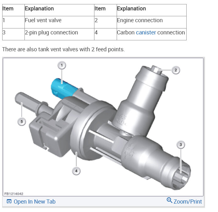

I try putting in fuel but every time I do it acts as if the tank is full, and it isn’t.
Jun 18, 2023 at 10:33 AM
  • 55,412 POSTS

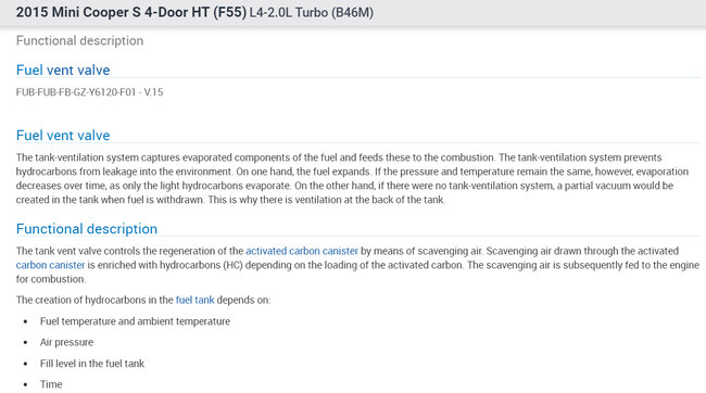

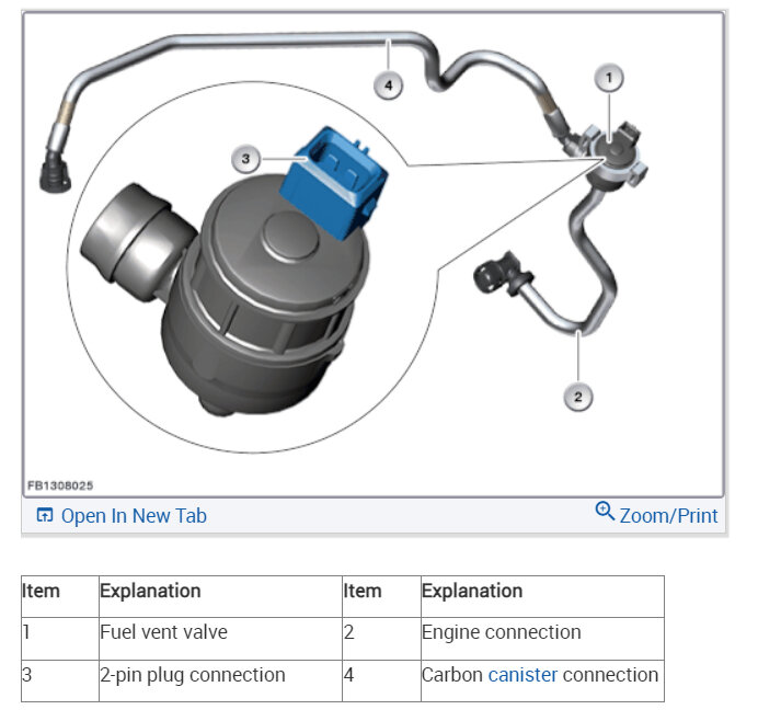

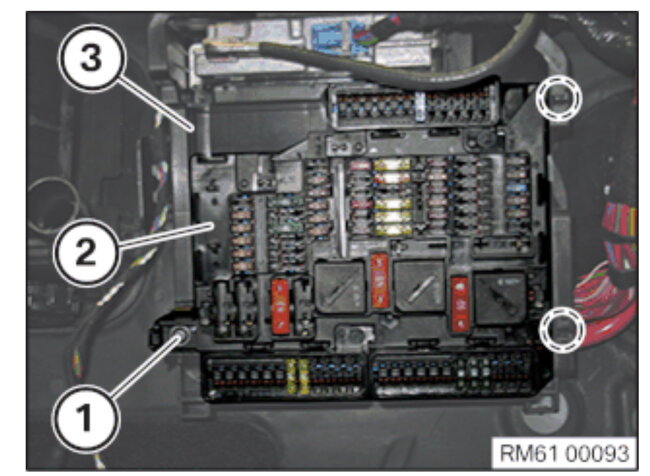

This happens when the fuel tank vent is not working, there are two of them, this guide can help as well. I would check the fuses as well with the systems on.
