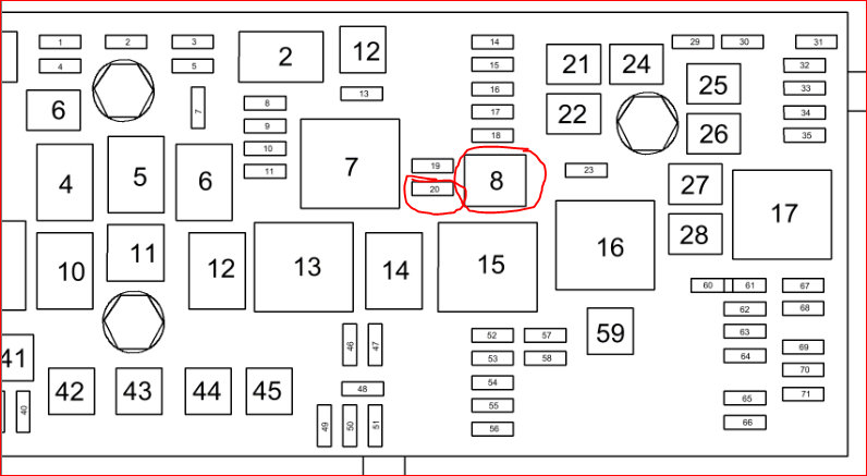

Replaced fuel pump still not working
2011 CHEVROLET CRUZE
125,000 MILES • 1.4L • 4 CYL • 2WD • MANUAL
JACKSAUTO
Put a new fuel pump and fuel pump driver module on. Pump still will not work. Where do I go from here? ECM?

Hello, I am Danny.
Did you check fuse #20 or more importantly the fuel pump # 8 in the fuse box? I have attached a picture of the fuse and relay location on your fuse box. I have also attached a few tutorials showing you what is involved. I hope this helps and thanks for using 2CarPros.
