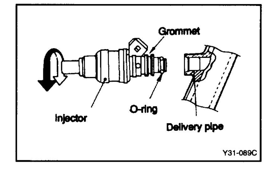

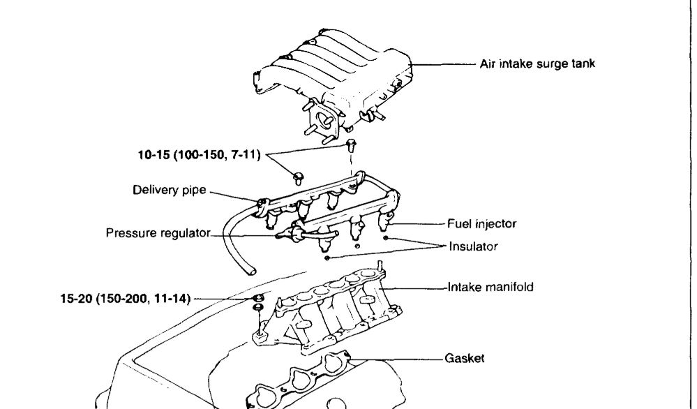

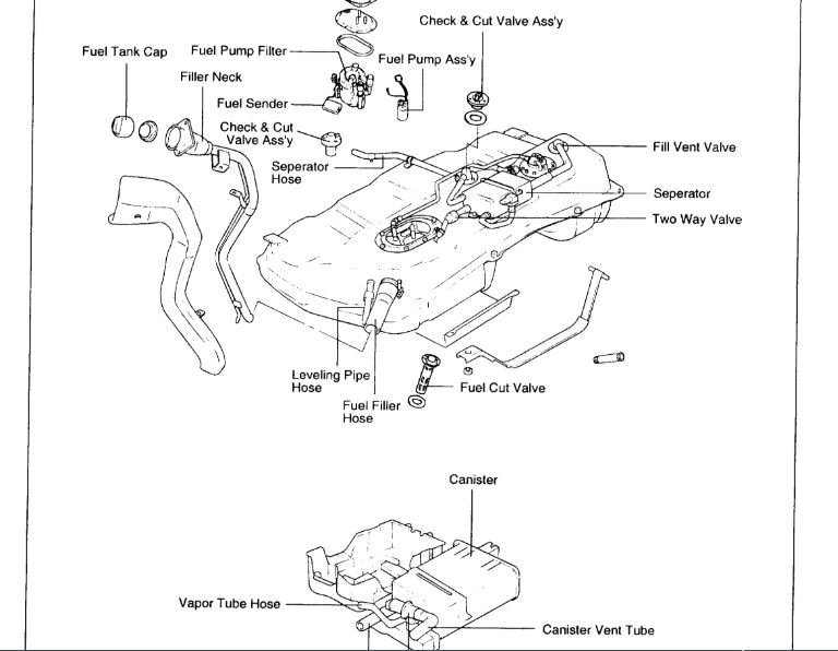

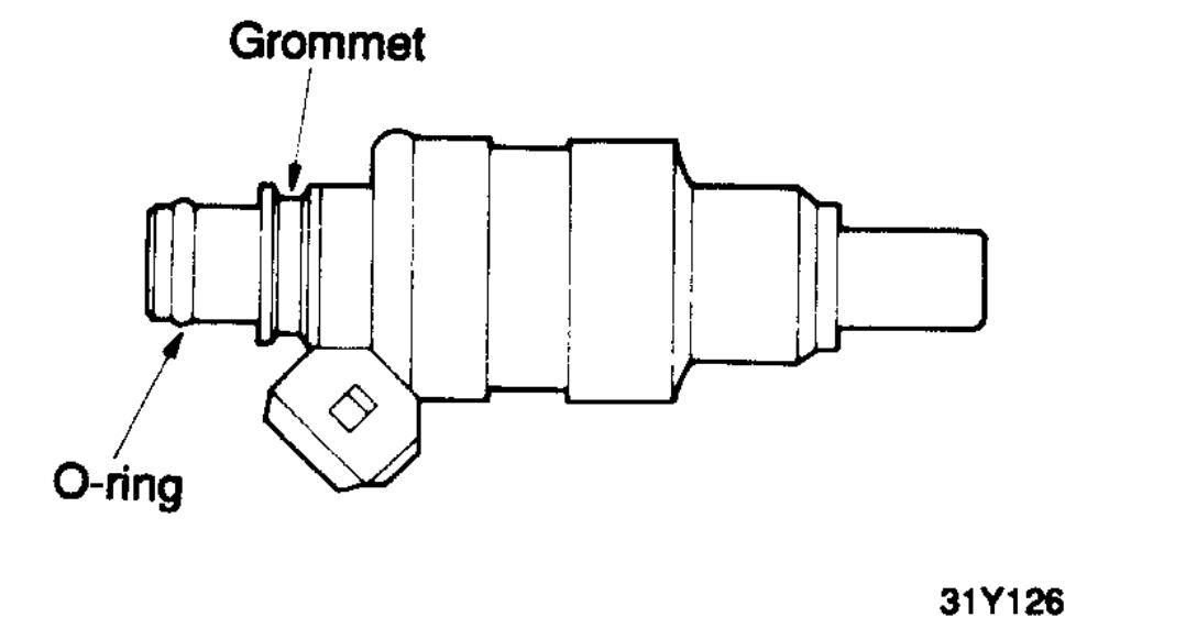

I had a friend give me some gas that had diesel kerosene and water in it before I found out I put gas in my car and ran into the engine and my car begin to run like really bad. I dropped it in and emptied everything out what else should I do to fix it?
Feb 6, 2020 at 9:59 PM
Good morning,
I would remove the fuel rail and flush it out of all that stuff. The injectors may have been damaged from this as well.
Remove the tank and have it flushed out and I would replace the fuel pump as well.
Blow out the lines to the front as well.
Lot of work to do to return this to normal operation.

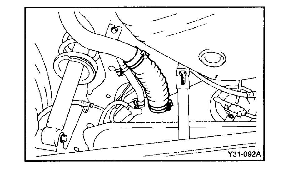

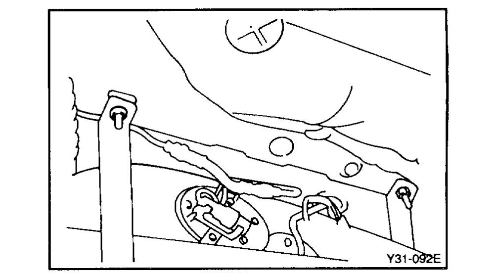

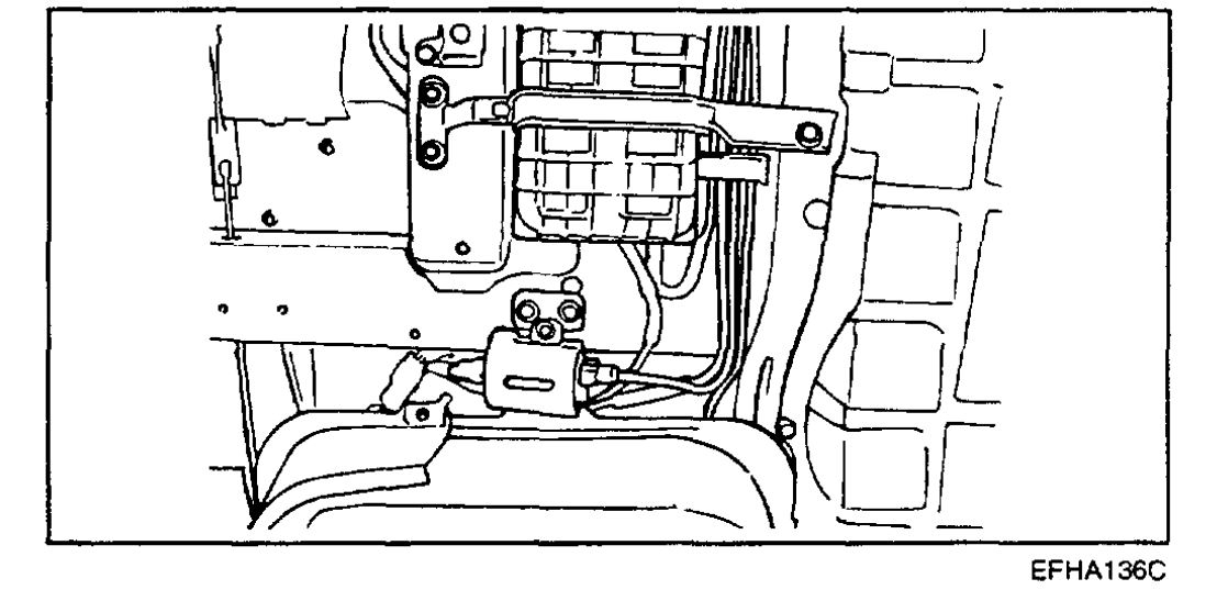

REMOVAL
1. To reduce the internal pressure of the fuel main pipes and hose, first start the engine and then disconnect the electrical fuel pump connector located near the fuel tank.
CAUTION: Be sure to reduce the fuel pressure before disconnecting the fuel main pipe and hose, otherwise fuel will spill out.
2. Disconnect the battery cable from the negative terminal of the battery.
3. Remove the fuel tank cap.
4. Disconnect the return hose and vapor hose.
5. Disconnect the fuel pump connector.
6. Disconnect the high pressure hose from the fuel tank.
7. Loosen the two self-locking nuts that hold the tank in position and remove the two tank bands.
8. Detach the fuel filler hose and leveling hose.
9. Remove the fuel vapor hose and the fuel tank.
INSPECTION
1. Check the hoses and the pipes for cracks or damage.
2. Check the fuel tank cap for proper operation.
3. Check the fuel tank for deformation, corrosion or cracking.
4. Check the fuel tank inside for dirt or contamination.
5. Check the in-tank fuel filter for damage or restriction.
6. Test the two-way valve for proper operation.
7. Using a vacuum hand pump, check the operation of the two-way valve.
