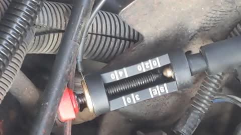

The truck listed above is a c1500. I had some electrical problems, I think. Hope they're simple. I was having grounding issues and think that's fixed because my battery gauge reads 11. It was running after I did a ton of work on it, new starter, alternator, front suspension, brakes, but was having grounding issues due to putting battery behind seat while I did front suspension work, when I put it back it started and ran for a while but was losing power, and dim lights. Then started making loud knocking. I was told may be module on distributor replaced that and new cap and rotor, and wires. After no success I reset timing mark and TDC pointing rotor at number one cylinder and sounds like it wants to start but won't. I thought I had weak spark, so I replaced the coil. Now I think may have gotten wires mixed or something and can't find a diagram telling me where do + and - wires lead off battery. Also, every pic I have found of junction block, seems like mine is missing wire or is misplaced. If you could help me troubleshoot, I would be forever grateful.

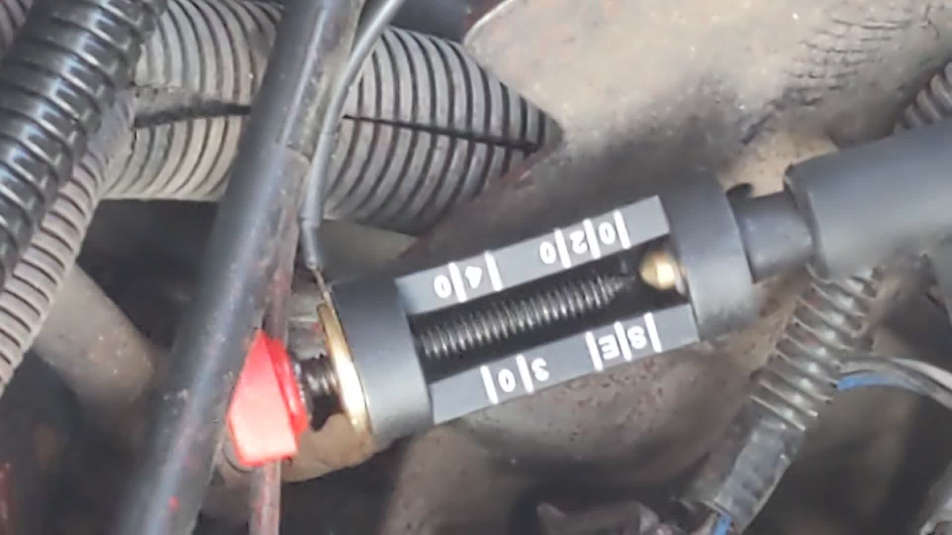

Thanks for help I had run long cables and it was running for a while and lost power slowly. Since then, think I fixed ground problems but couldn't find the diagram of grounds you sent. I installed a new coil cap and rotor and ignition module. Removed coil wire from distributor cap and checked with ignition spark tester. Didn't know how to set gap so used same as spark plug. It wasn't blue but was white. Checked battery while cranking over and got 10.6. including video of spark check off distributor. Also, I checked and have power to the red wire to coil but not white with ignition switch on but not cranking.

The spark looks strong. Is it running properly now?
