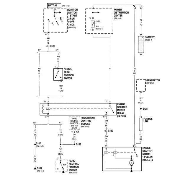

I changed the gasket on the manifold and put it in the engine and got everything hooked up and it started for five seconds and it would quit, started it again stayed running for three seconds, started it again nothing. Changed injectors, changed starter, alternator, ignition switch everything. Now car will not start at all? Any advice? Please!

I attached a diagram for you to view. Check for power to the relay from the fuse listed and with the key in the start position.

It was a broken vacuum line thank you.
