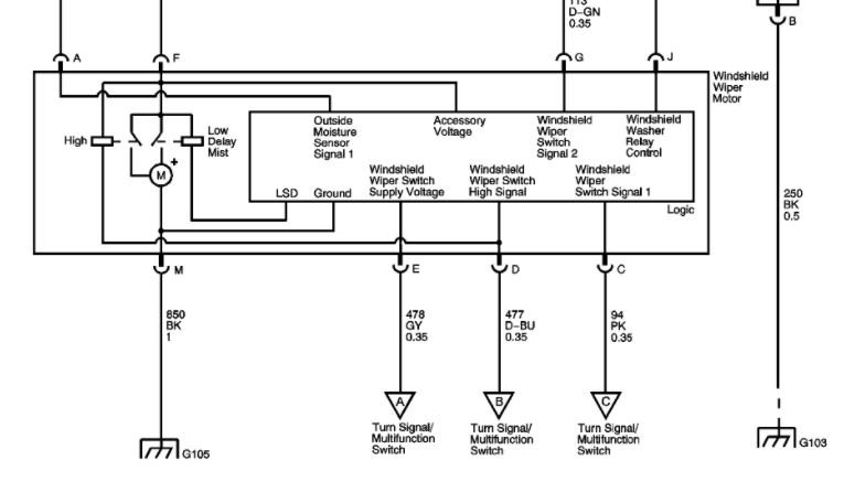

My vehicle's front windshield wiper just working on high speed rest of all options are not working. also, front windshield wiper motor not working. I check motor fuse and its performance it is working but by system not working.

I looked at a wiring diagram and it looks like you have either one of two issues.
The wiper switch may not be sending a low speed signal to the wiper motor or the motor itself is the issue.
