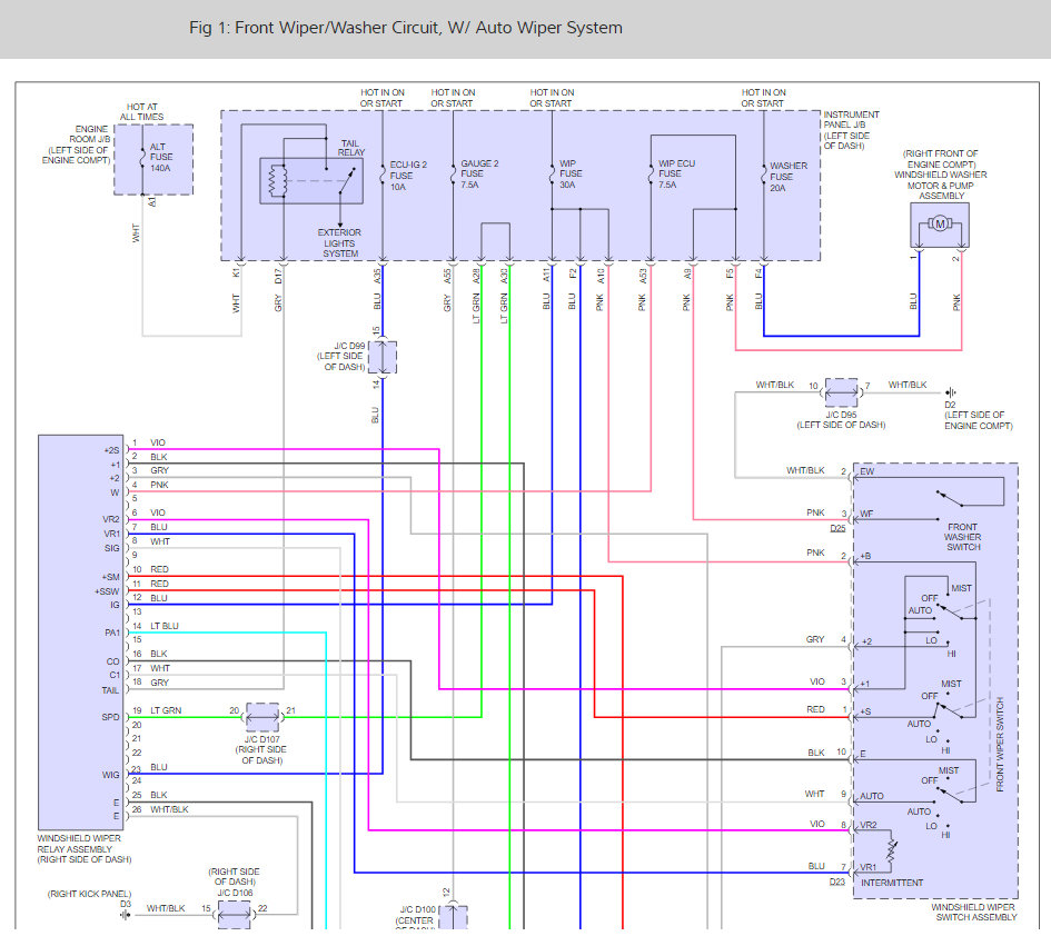

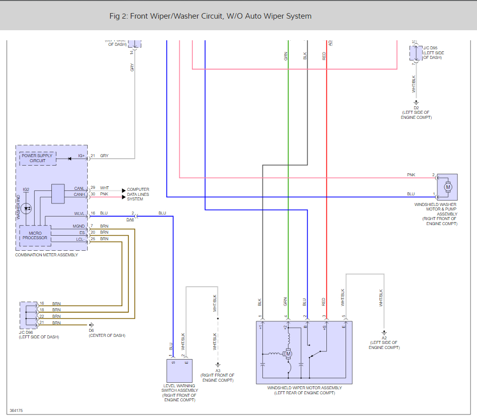

The front windshield wiper does not even move when I turn it on but the rear wiper will work perfectly. Could this be a major problem? Please let me know how much it will approximately cost and what can be done.
Thank you,
Zach
Jul 24, 2017 at 10:15 AM
  • 55,202 POSTS

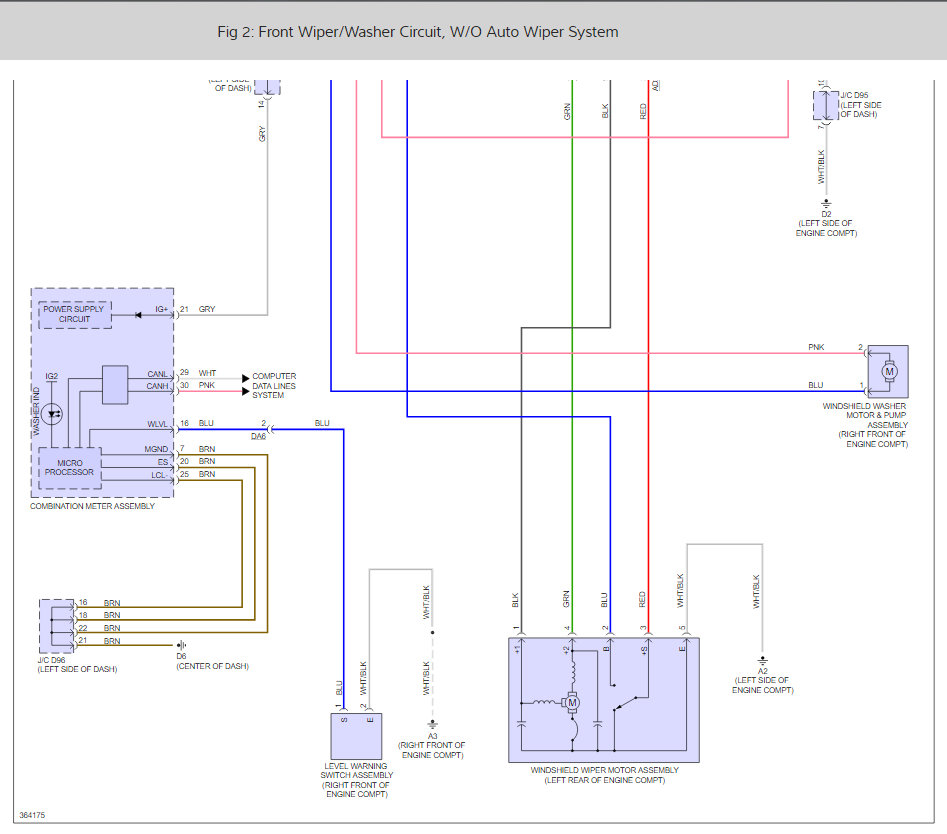

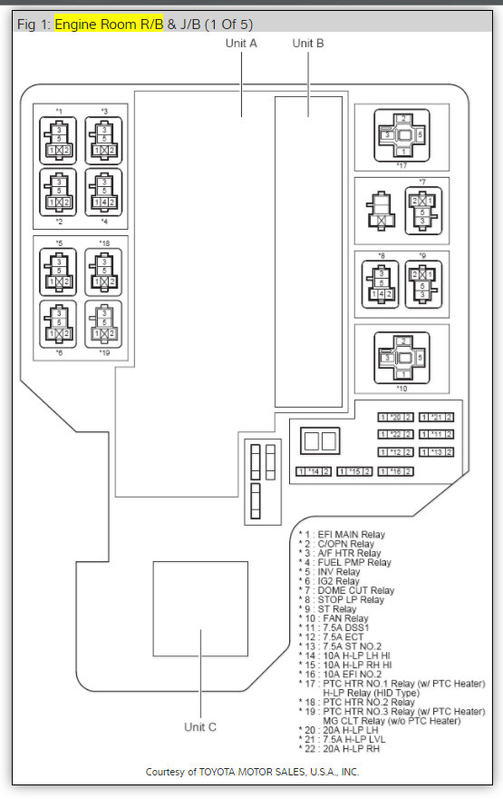

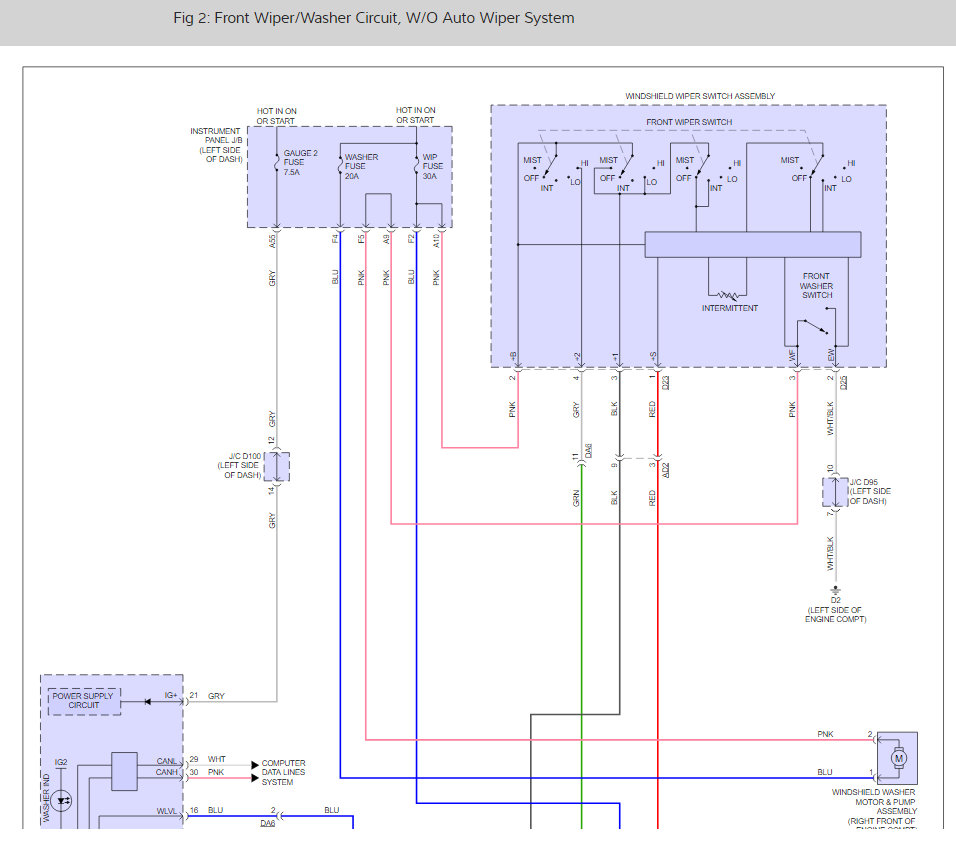

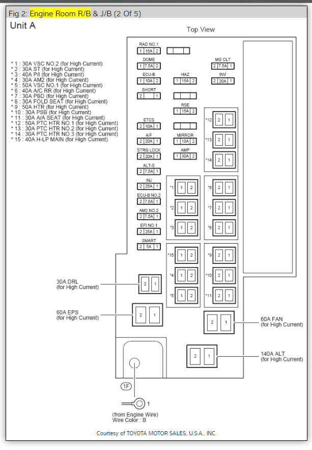

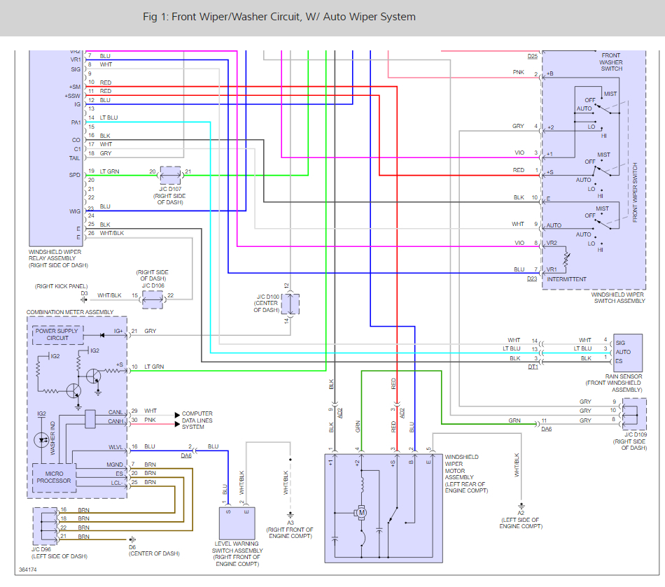

It sounds like it could just be a fuse, here are some guides and diagrams (below) to help you see if the fuse is blown.
and
Please run this test and get back to us we are interested to see what it is.
