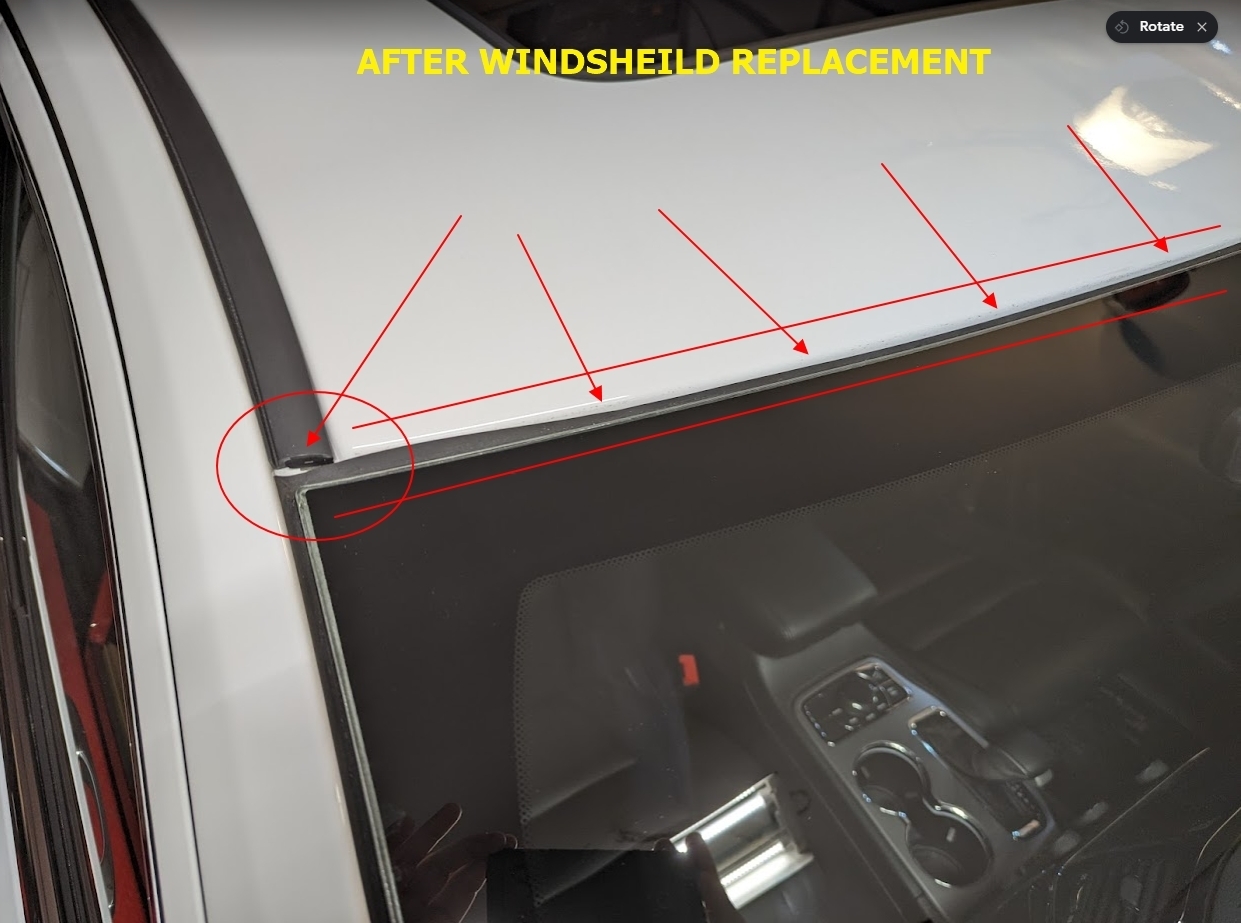

I had the windshield replaced in our vehicle listed above after it took a hard rock hit this past week.
Local body shop completed the replacement this past (4/1 Friday).
That said, they indicated they only calibrate the front facing camera if there is an “error” –
Told me to just drive it.
What I have read is that, anytime the windshield is replaced the front facing camera must be recalibrated. As well as my insurance company sent me an email stating the dealership (or someone trained) must recalibrate it.
Can someone confirm for me?

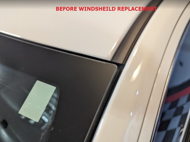

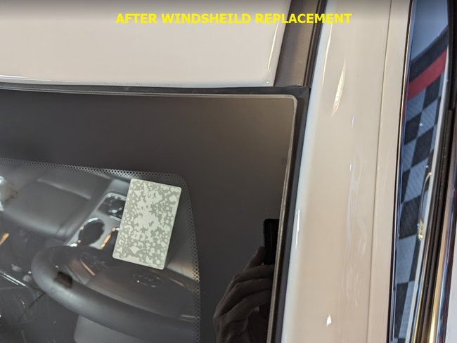

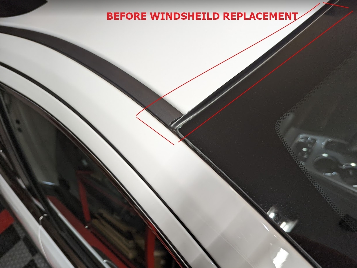

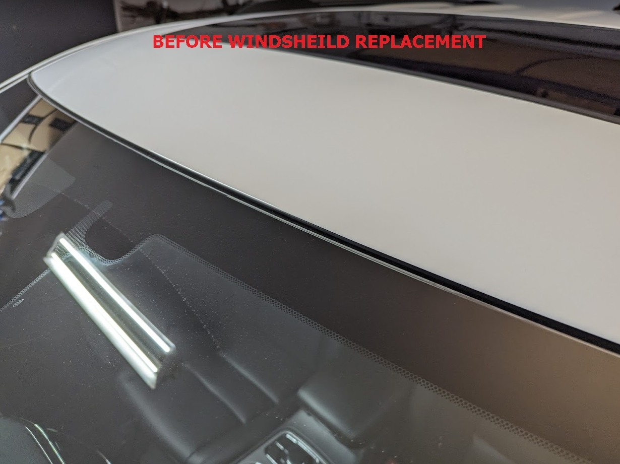

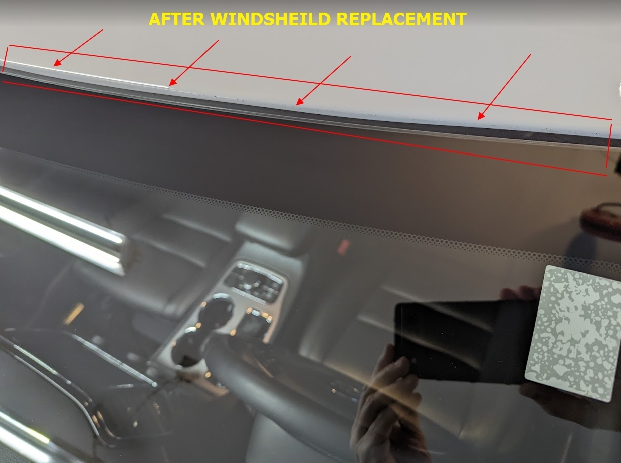

Also, perhaps not a big deal but I feel like they didn't take care with the top seal, and I am concerned that it's now going to collect water when it shouldn't had they ensured the seal was in its original position.
I am bringing it back on Monday 4/4 to ask them to fix it. I presume the only way to fix it is to take the windshield out again.

The camera must be recalibrated after any glass replacement as the refraction qualities and patterns will be different for every piece of glass. Yes, the camera may see through the glass without errors, but it may not be seeing the correct image until calibrated. Sort of like an eyeglass prescription, each piece of glass is different.
As for the seal, unless it is factory glass set in by the robot it likely won't fit the same way. That said it looks like it is sealed okay, the trim itself can leak moisture behind it, that is why it is actually open on both ends at the bottom so that moisture can get out. That would be your choice, but the camera needs calibration.
