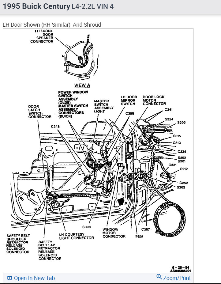

The back windows work fine, but the front windows do not work at all. They are all the way up.

This happens when the main window switch goes out. To be sure this guide can help you test the switch:
https://www.2carpros.com/articles/electric-window-repair
Here is how you can replace the switch int he diagrams below. Check out the diagrams (below). Please let us know what happens.
Image (Click to enlarge)
