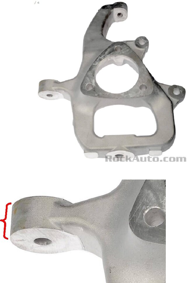

I have play where my outer tie rod connects to hole slot in steering knuckle. Assume area causing vibration feedback through steering wheel but how can I tell if tie rod is bad or slot on knuckle is worn down creating the gap for the play.

If I understand correctly, you're seeing sideways movement between the tapered stud of the outer tie rod end, and the tapered hole it goes into in the steering knuckle. If I have that right, the only proper repair is to replace both parts. What happens is the top of the hole, (the wider end), gets wobbled out, then that hole will not support the tapered stud on the new tie rod end. It will only wedge tight next to the smaller end. That leaves the fatter part of the stud free to wobble back and forth. Very often the stud will snap from those stresses.
This mainly applies to GM vehicles, but it's worth mentioning. Sometimes a manufacturer has a part from a previous year or model that can work in a new application, but with minor modifications. I can see this happening to an aftermarket supplier too. A case in point is when an outer tie rod end from last year's model can be used on a newer model, but the steering knuckle isn't as fat where the stud comes through. Rather than try to restate that a less confusing way, the photo below shows the spindle for my truck. It's a year older than yours, but the part number is the same. The area with the red bracket can be smaller on some models, but the diameter and taper of the hole is the same as on a previously-used part. The tie rod's stud can stick through too far until it runs out of threads. You may be able to see part of the tapered section peeking through. When that is a possibility, there will be two washers included with the new tie rod end.
The other clue is when the castle nut is fully tightened, the slots for the cotter pin will not line up with the cotter pin hole in the stud. That nut could back off a couple of revolutions before it backs into the cotter pin. Adding those washers under the nut ensures the nut doesn't run out of threads, and the cotter pin will go through the slots in the nut.
The spindle is made of aluminum to save weight, but it also hammers out easily from the tapered stud banging back and forth. What's less easy to see is the tapered stud wears too. It is steel, so it wears less, but it will not fit snugly into the hole in the new spindle. Even the slightest looseness or irregularity will let that new stud move around and start wearing the hole in the new spindle. As that hole gets bigger, the hammering effect gets worse and worse until you have the same failure. That's why both parts must be replaced at the same time.
The next concern is the vibration you mentioned. Tie rod ends and ball joints do not cause vibrations. When worn, they can allow vibrations to become bad enough to feel, but vibrations have to be caused by something that is rotating, in this case wheels, tires, and brake rotors. If that vibration goes away after the parts are replaced, I would chalk it up to normal vibrations that are amplified by the road force energy that gets put into the tires. In other words, the tires are free to oscillate left and right because the steering system isn't holding them in alignment. This is where the worn tie rod end can allow a normal vibration to get bad enough to feel.
Once the tie rod end and spindle have been replaced, let me know if that solves the vibration or if we need to look further.

I appreciated that very thorough response. I ended up changing the outer tie rod to see what it did and if it would need to progress to the knuckle being replaced. The new tie rod took the wobble/play out. When tightened up there was zero play/ movement in the rod and knuckle. Here is the kicker though. Didn't remove the feedback/ vibration I have been feeling in the steering wheel and gas pedal. Do know this issue.....the feedback/vibration is very minimal. It isn't like there is "visible" shake but I have a slight buzz (non audible) in the gas pedal and steering wheel that wasn't there until I changed to new tires. I had the wheel and tires checked for trueness and just fine. Had them rebalanced and fine. Had a new alignment. Changed my wheel bearings. Changed my brake pads. Now changed outer tie rod. Still have the odd feel through the steering wheel and gas pedal. The fact it's coming through the gas pedal is what is throwing me off. Engine and transmission idles fine and no shake when driving. And the even weirder notation is the vibration/feedback is when going from start to say 40mph. Once cruising a good 45+ it isn't there or noticeable. And at 70 rides perfect. The new tires also are street not mud tires. I thought warped rotor but I have no shake braking. So, solve this mystery....haha

This is not a proper repair. The tapered stud on the new tie rod end will wedge tight on the narrow end of the hole, then it will feel tight, as you found, but if that hole is wobbled out, the same thing is going to happen and ruin the new tie rod end. Both parts have to be replaced at the same time when the stud has worked loose.
