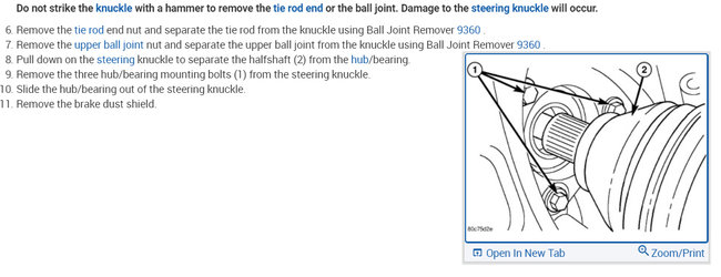

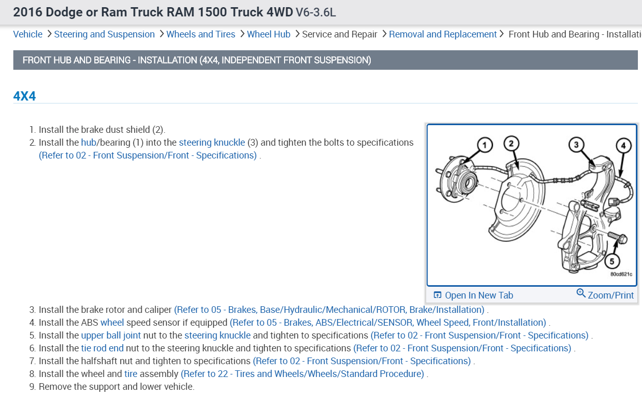

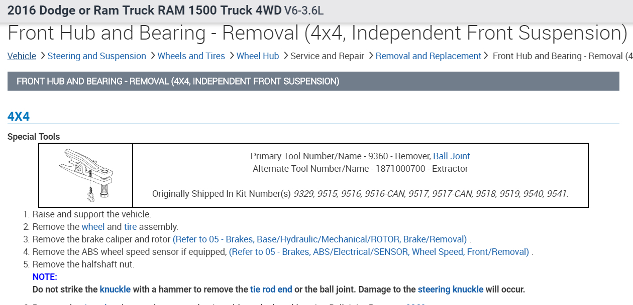

I have seen this problem before it is the front wheel bearing hubs need to be replaced here is a guide to help you fix the problem step by step with diagrams below to show you how on your truck.
https://www.2carpros.com/articles/bearing-hub-replacement
Check out the diagrams (Below). Please let us know what you find.
