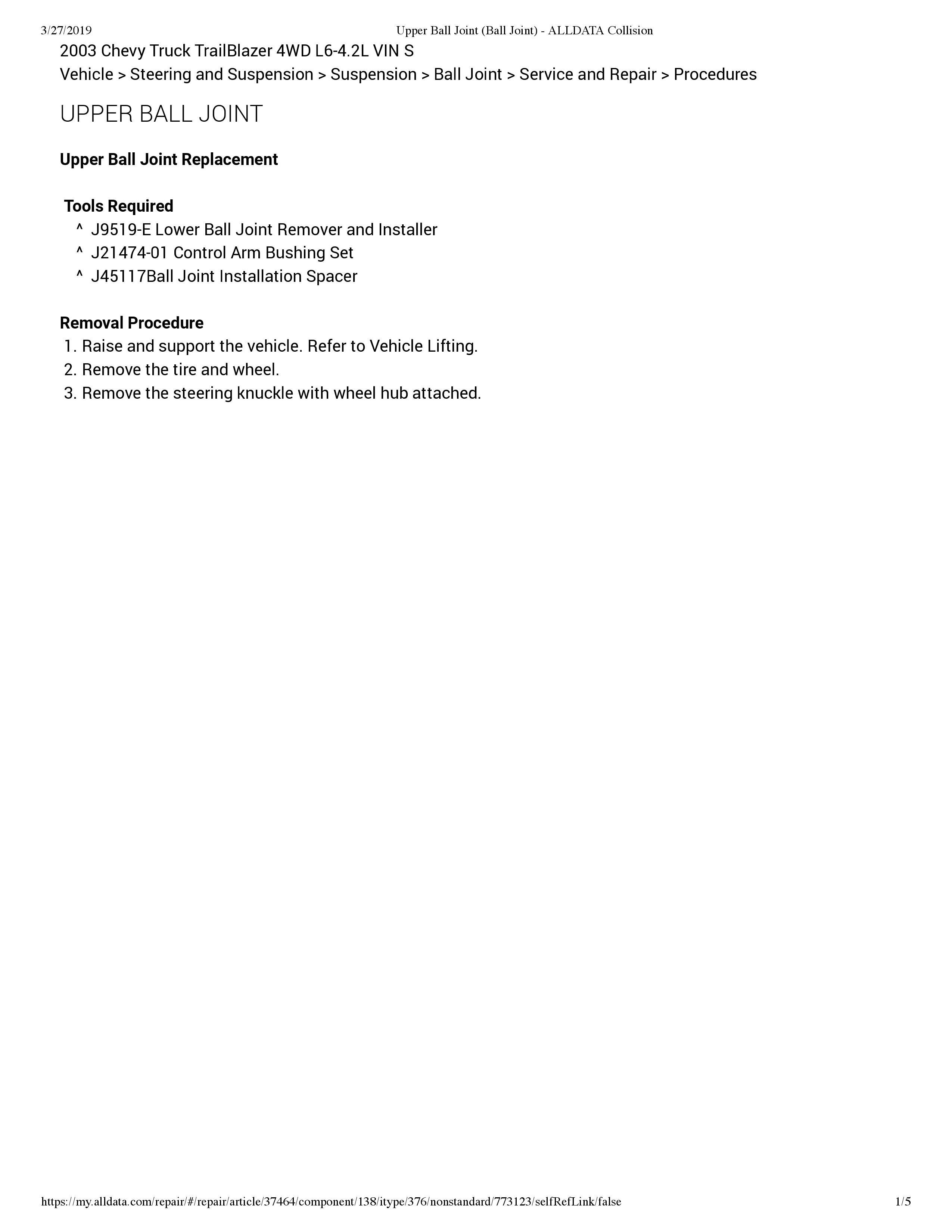

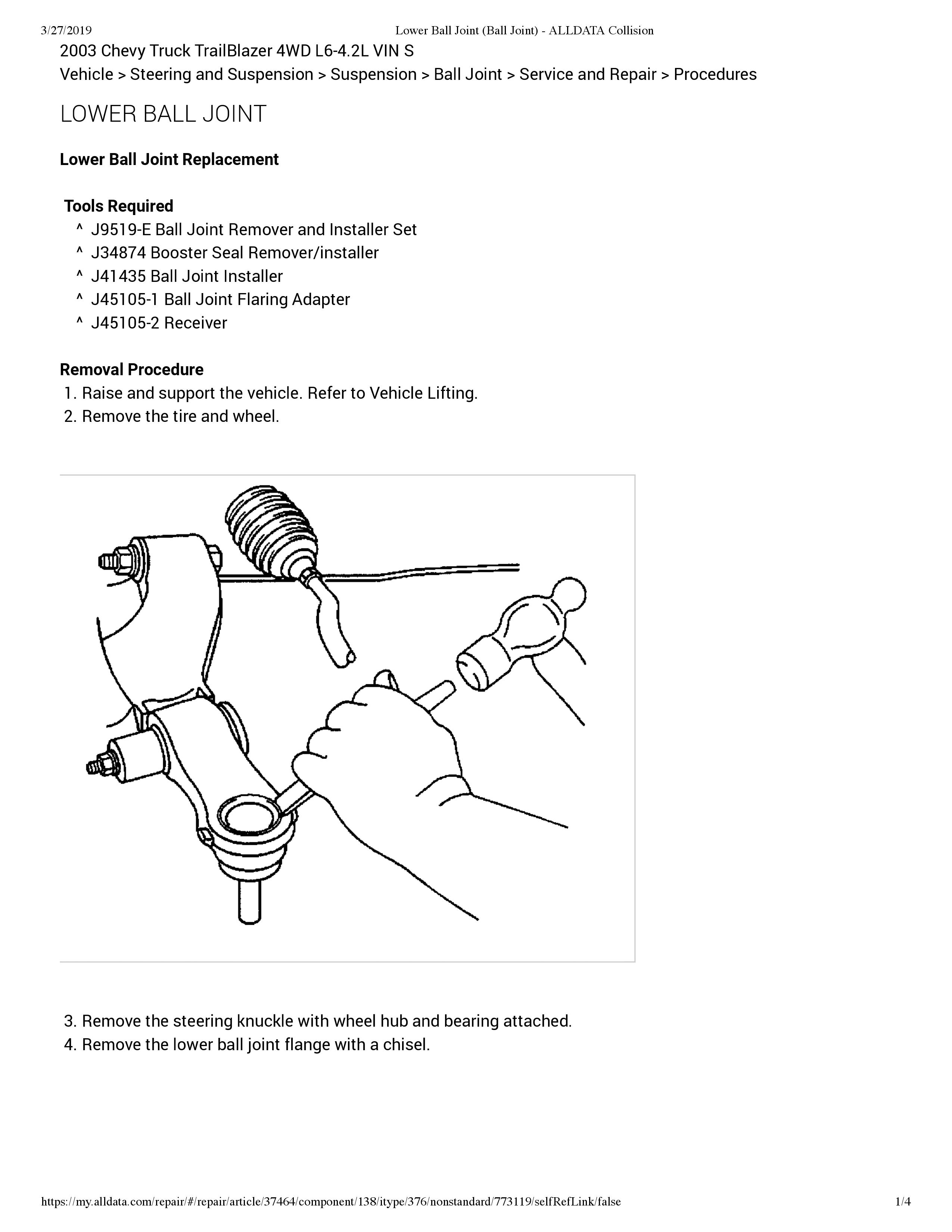

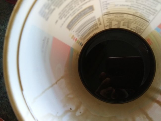

Hey Joe, yesterday finally got under front end of Blazer. I found that my car has both upper ball joints ready to fall out. Opened up gear box no oil in there or pretty close to none. I am in shock I had a tie rod end done and was never told about ball joints.
Could these be the focus of my issues?
How hard are these to do?
Wednesday, March 27th, 2019 AT 6:04 AM
CHARLIEGIRL223
  • 8 POSTS

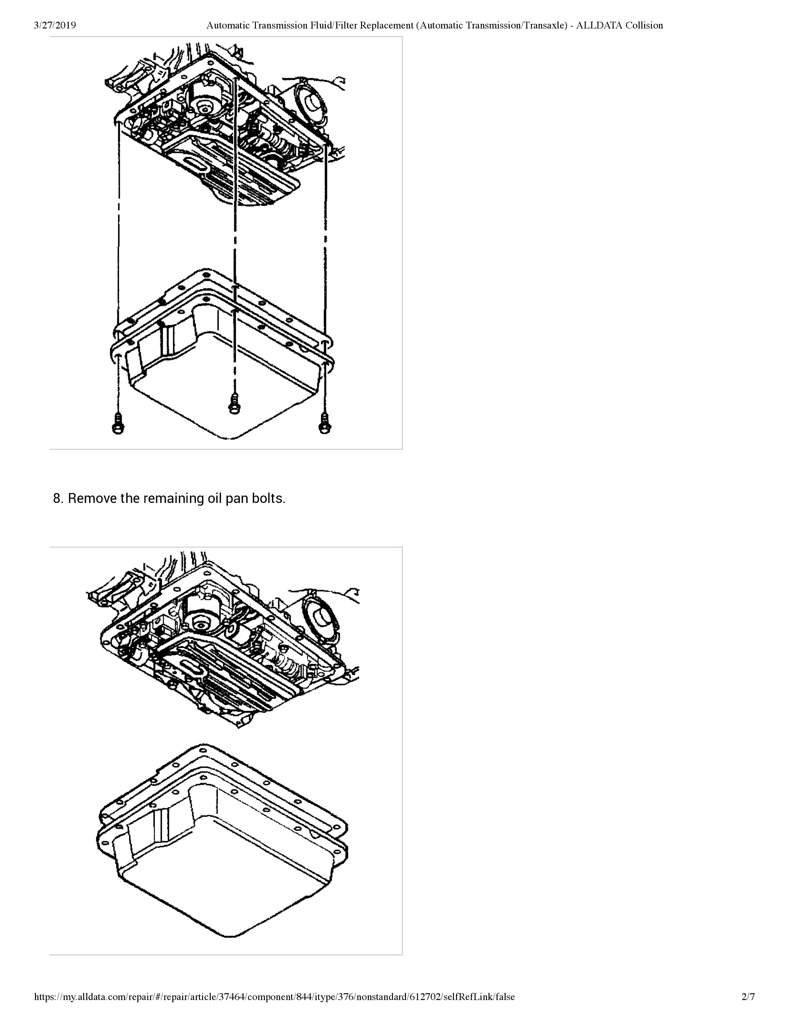

This is all that was in it. Not good huh?
Wednesday, March 27th, 2019 AT 7:07 AM
JOETECHPRO
  • 705 POSTS
Hey CHARLIEGIRL223,
If they sold you a tie rod end they should have checked the rest of the suspension at the same time.
This could be the cause of your skipping issues if there is excessive play in those ball joints the wheel can shift when loaded/turning.
I would change the transmission oil filter and refill the transmission.
I will attach the instructions for the ball joints and transmission service below.
I would ensure that your wheel bearings and other front end components are in good condition also.
Regards, Joe
Wednesday, March 27th, 2019 AT 10:38 AM

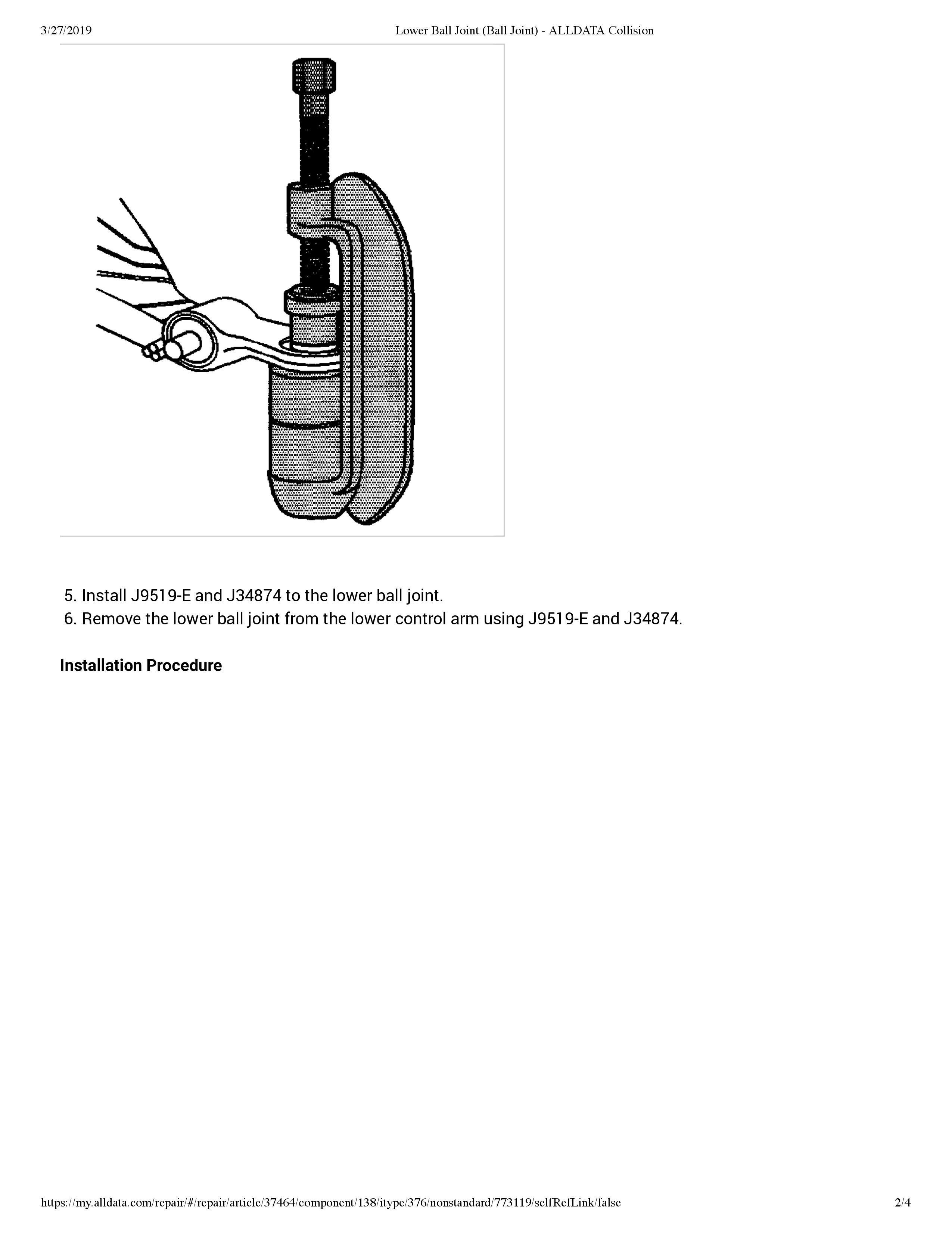

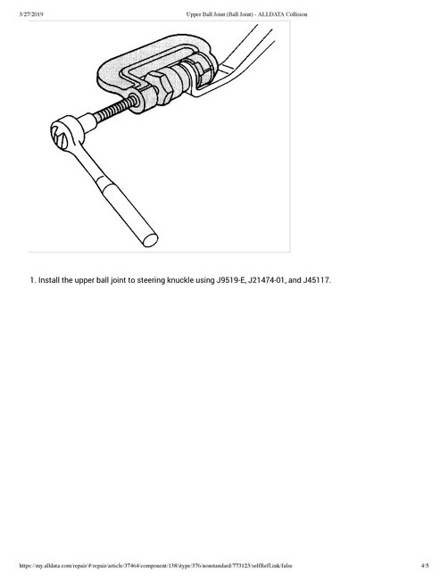

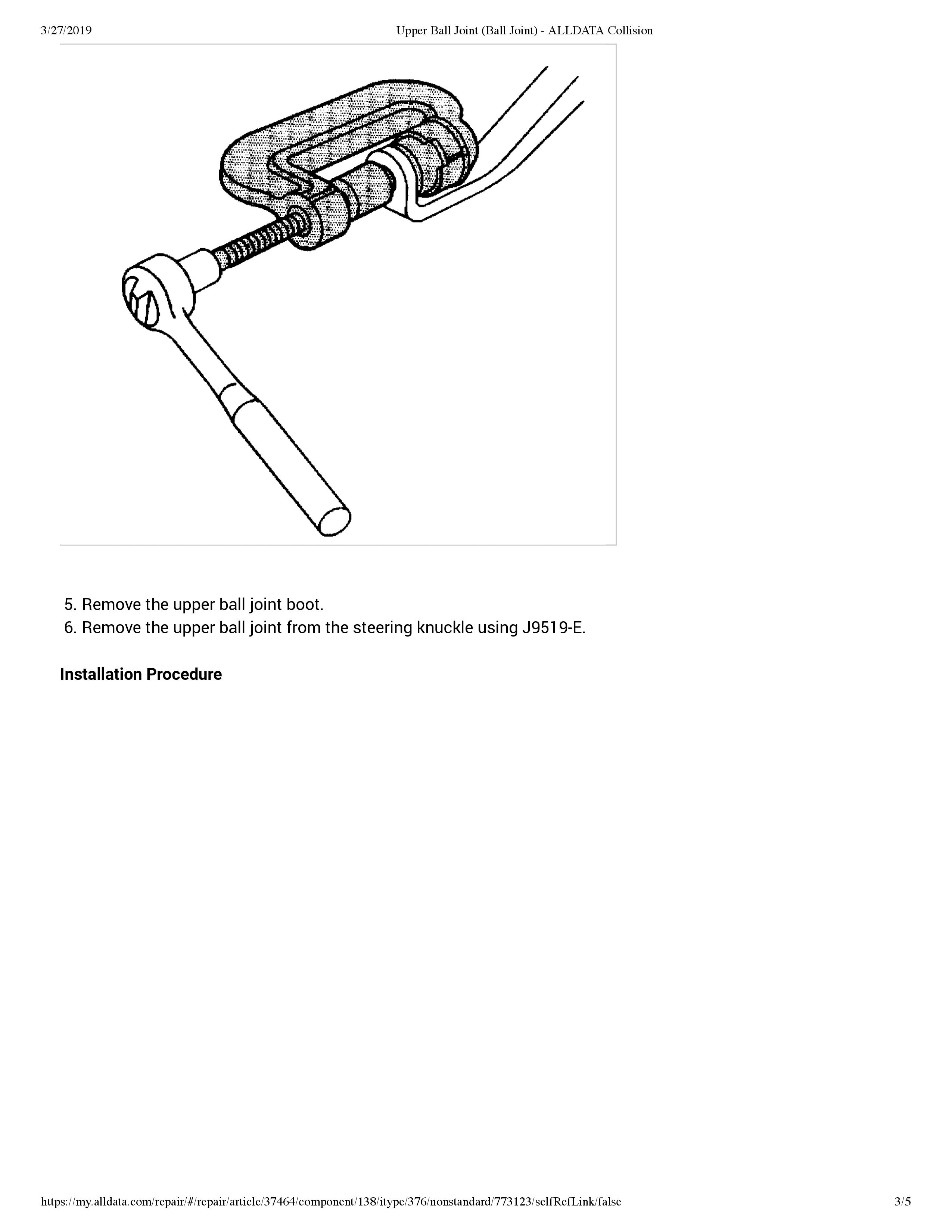

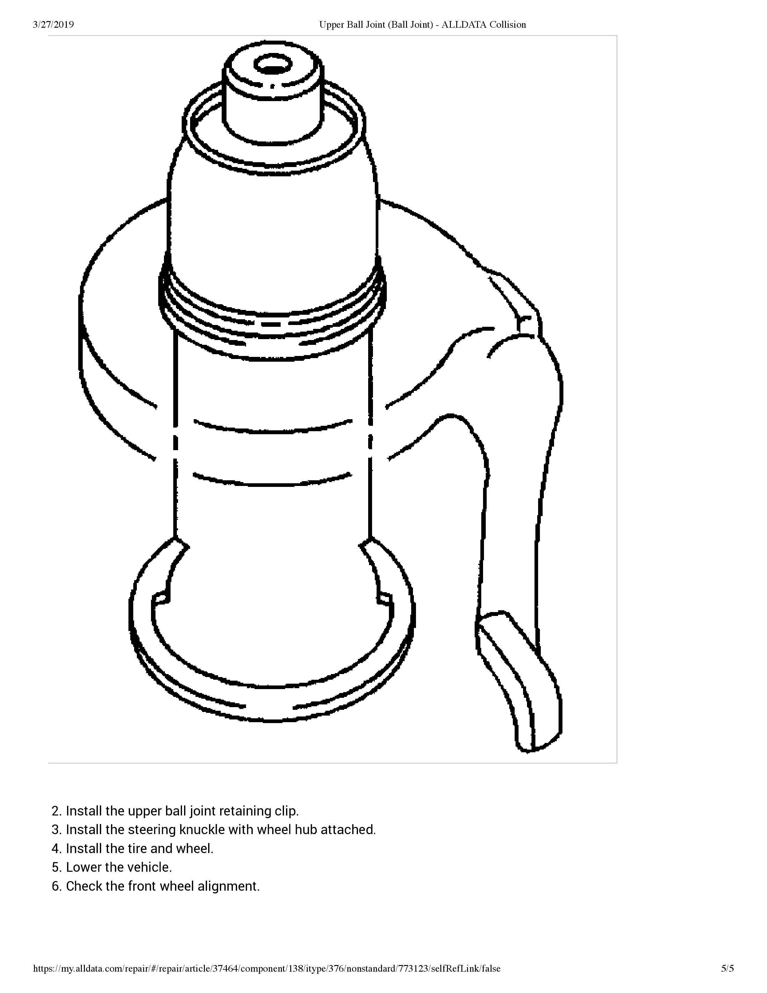

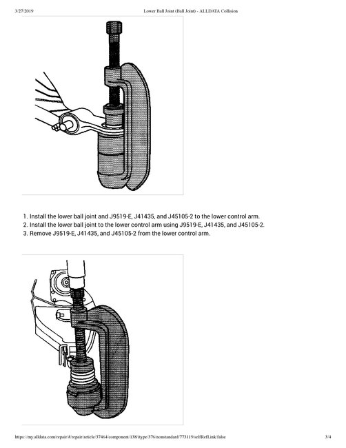

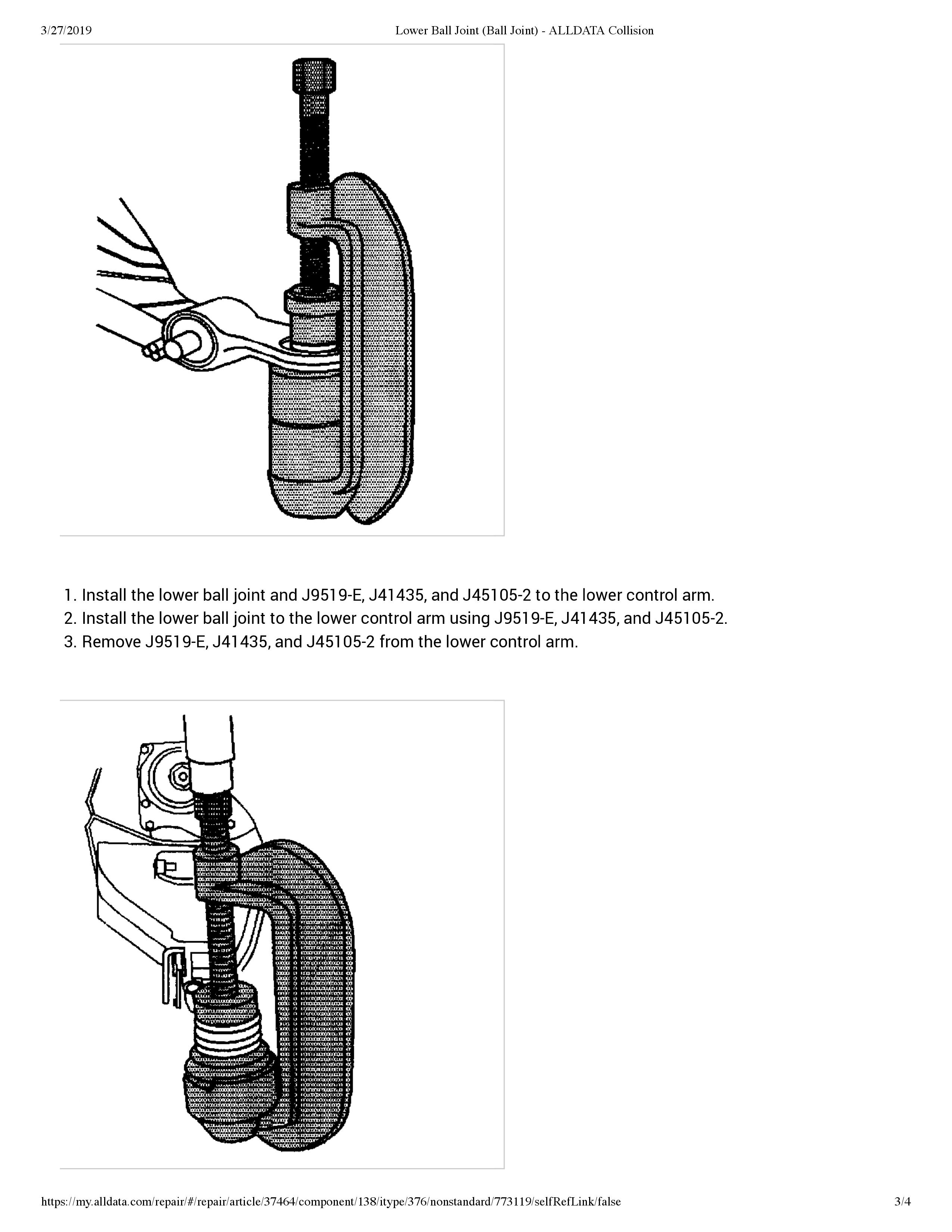

JOETECHPRO
  • 705 POSTS

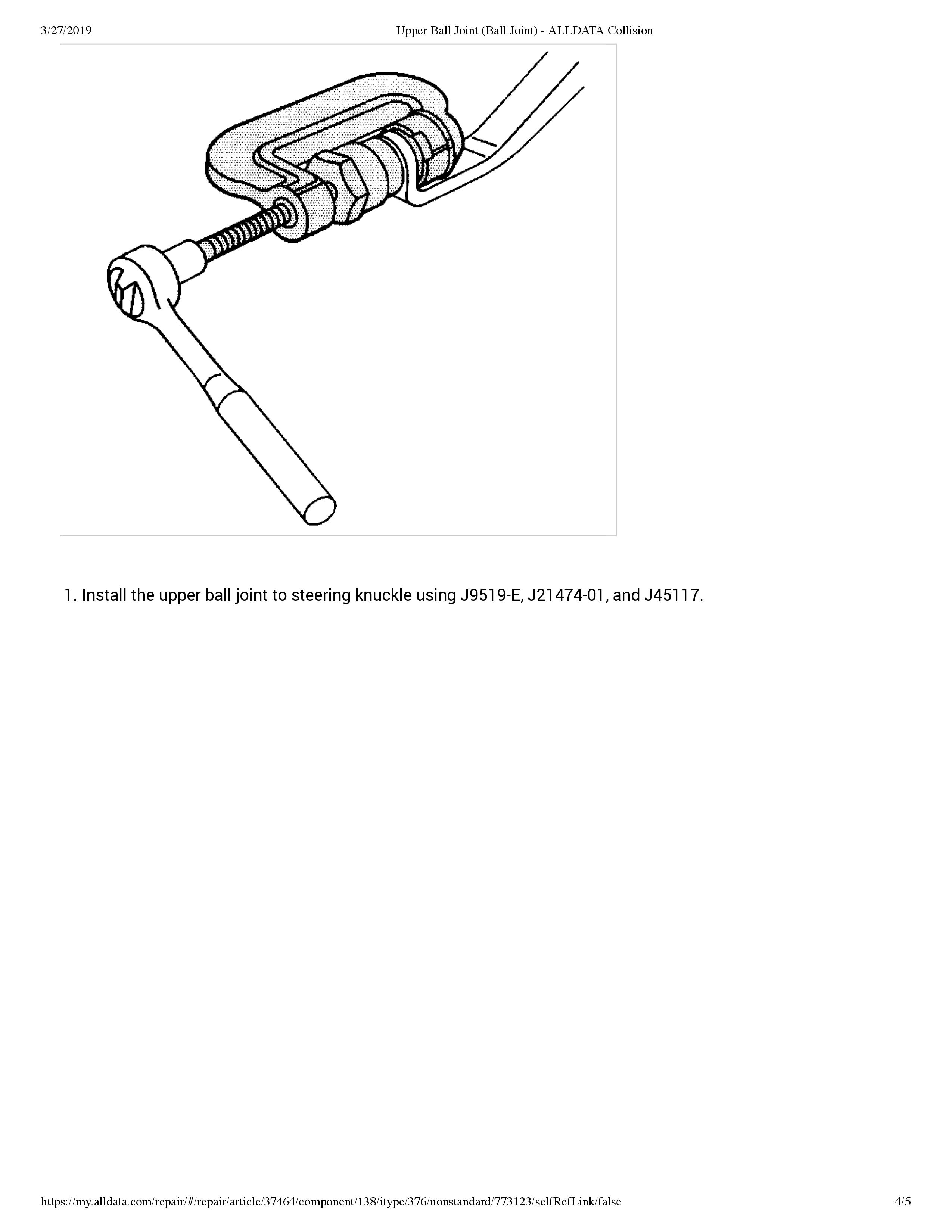

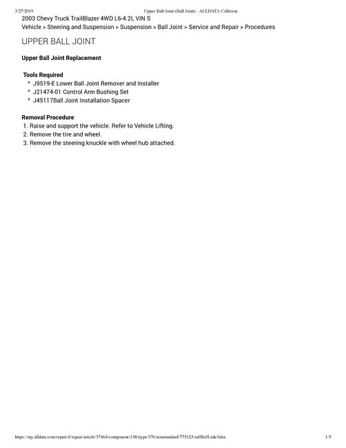

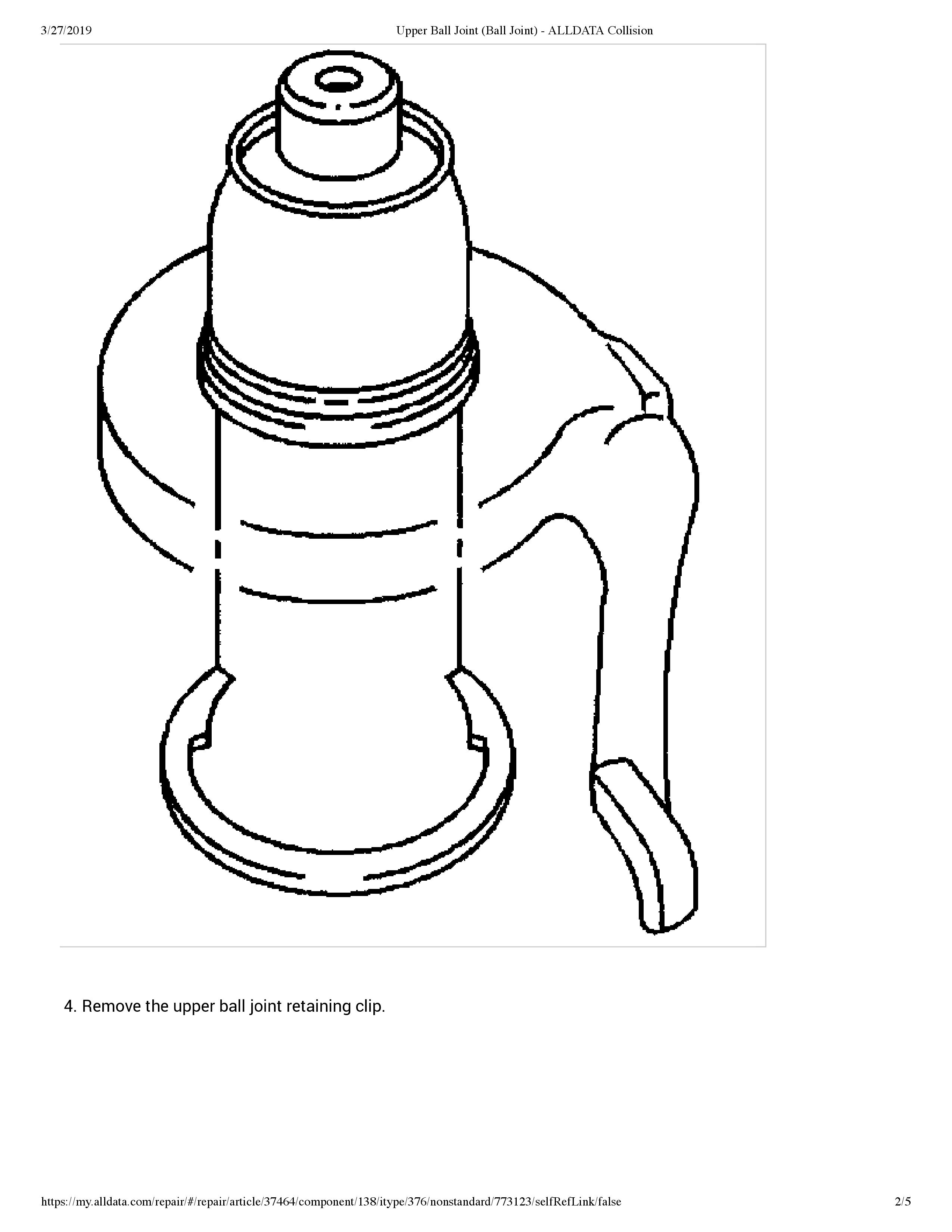

Hey CHARLIEGIRL223,
Ball joint repair instructions below for the lower and upper.
Regards, Joe

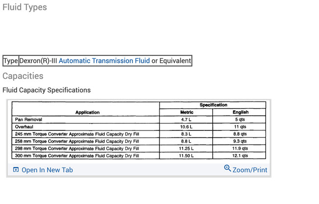

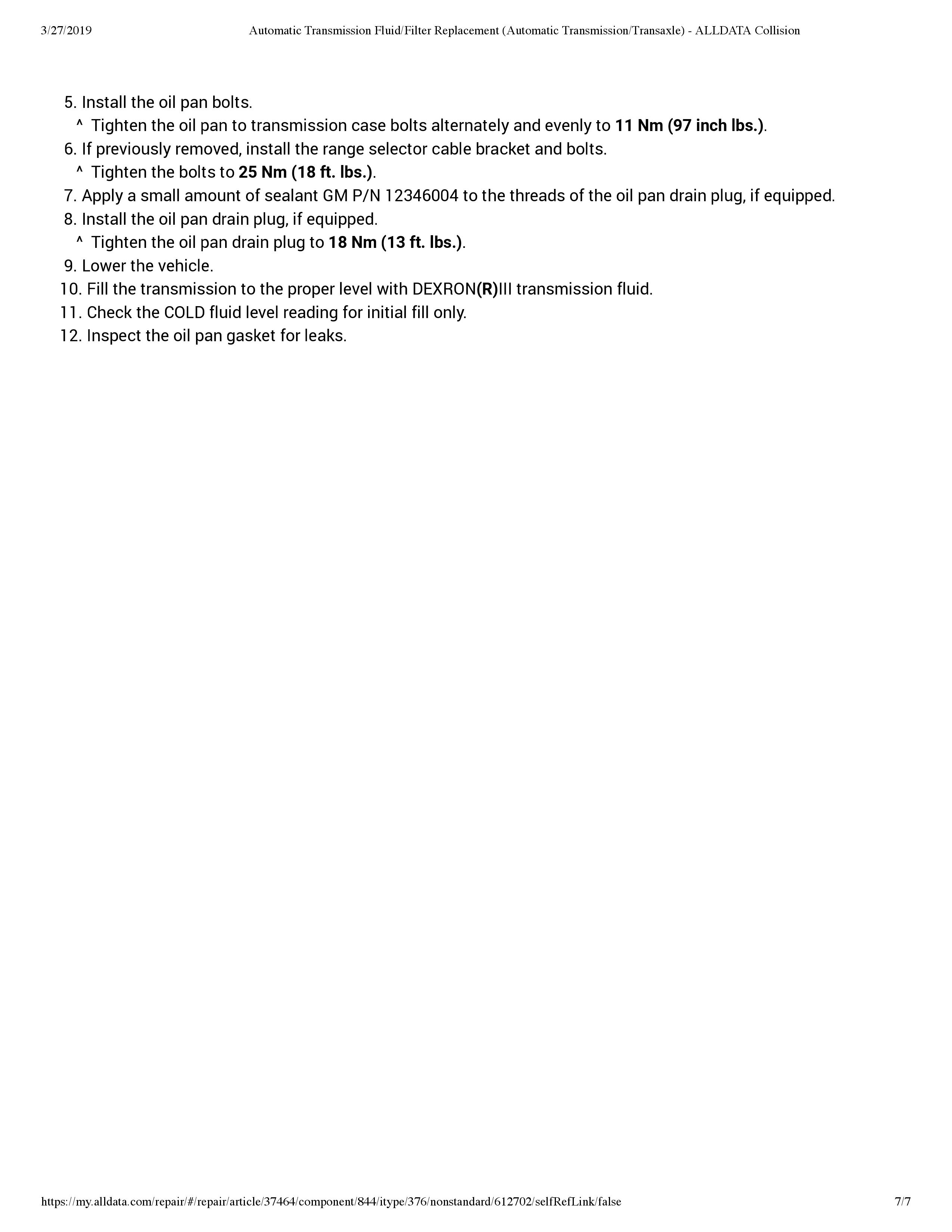

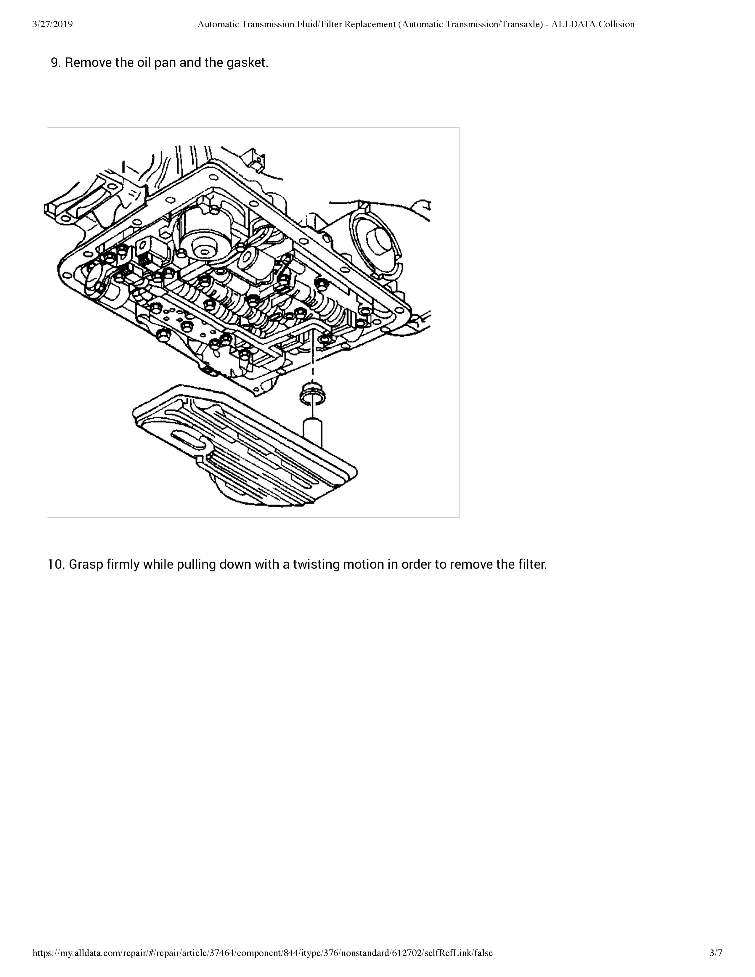

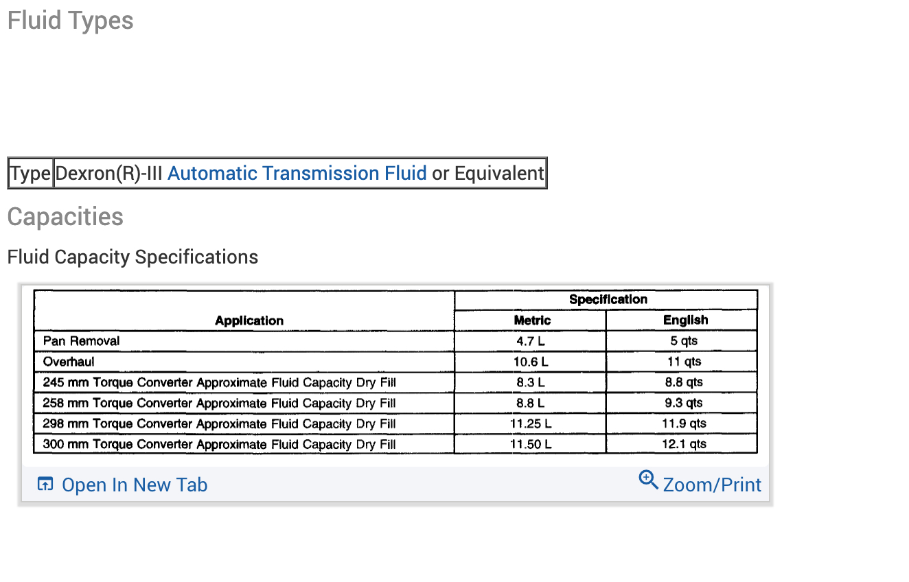

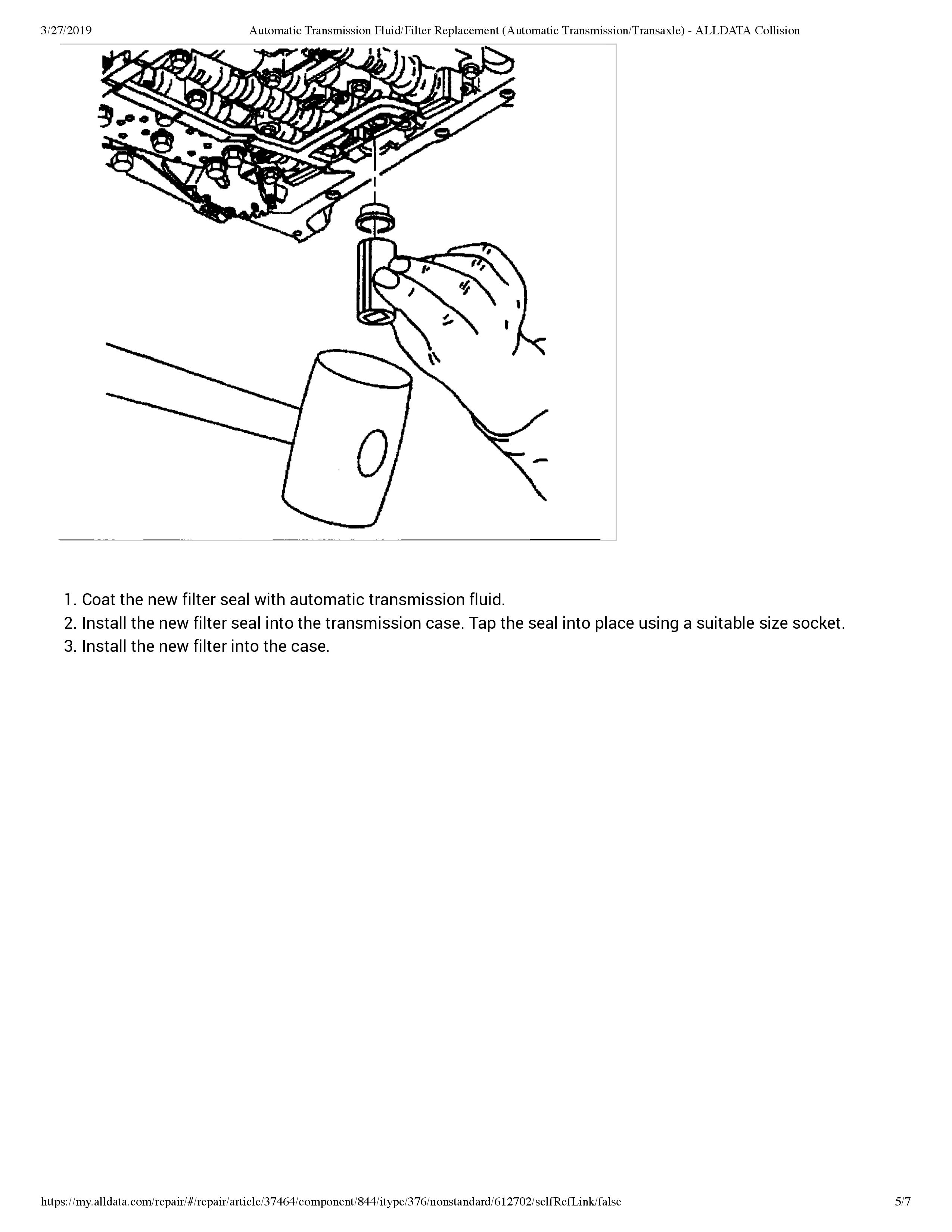

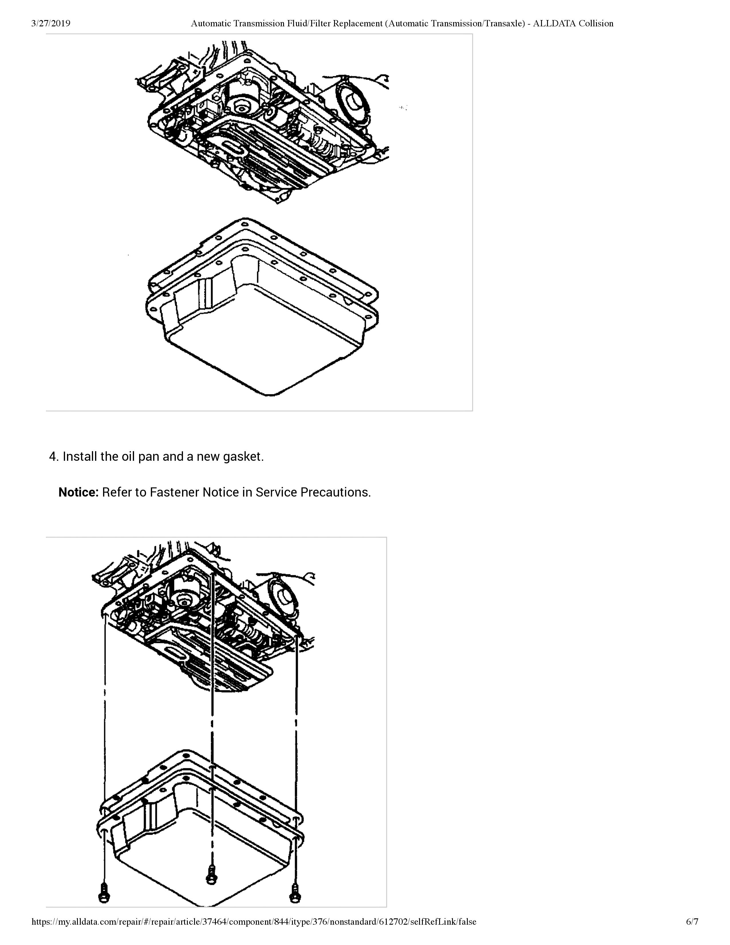

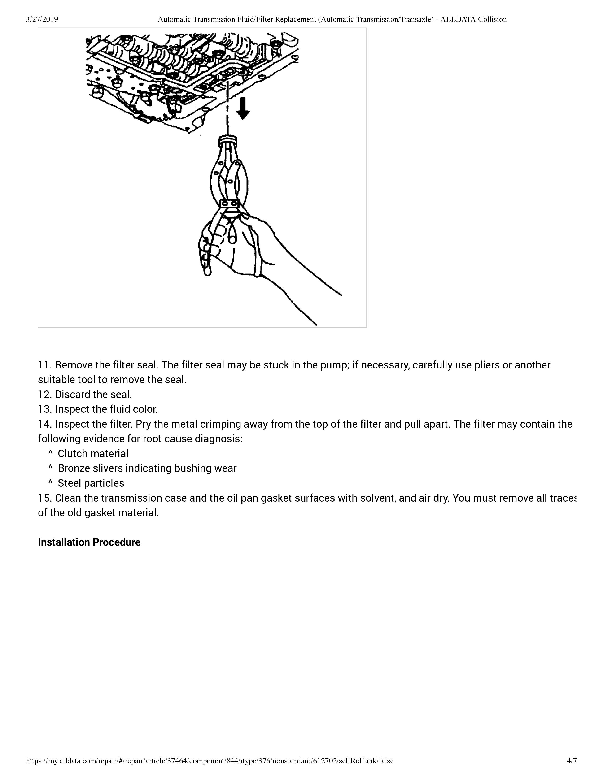

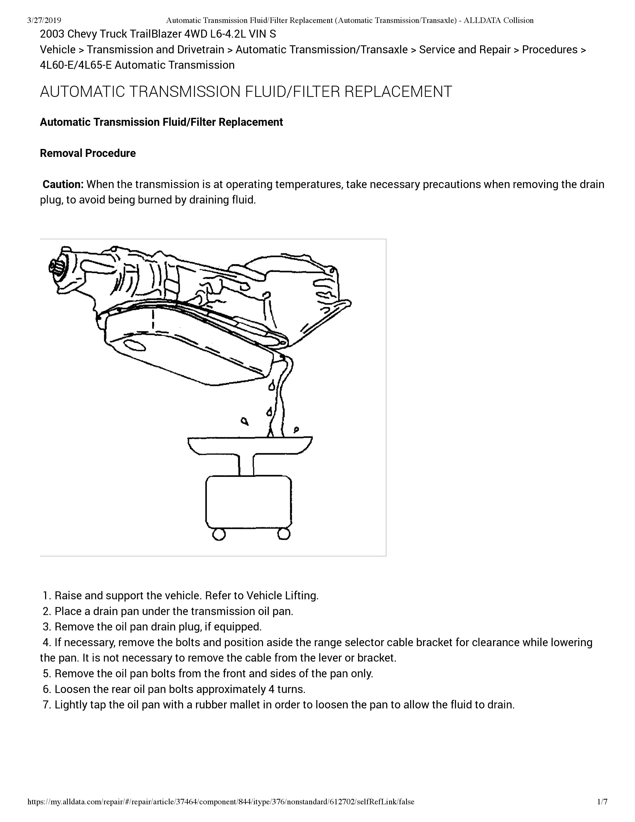

JOETECHPRO
  • 705 POSTS
Hey CHARLIEGIRL223,
Instructions on replacement of transmission oil filter and refill below.
The transmission should take 4.7L of oil after filter replacement.
Regards, Joe
