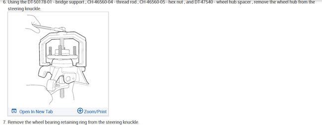

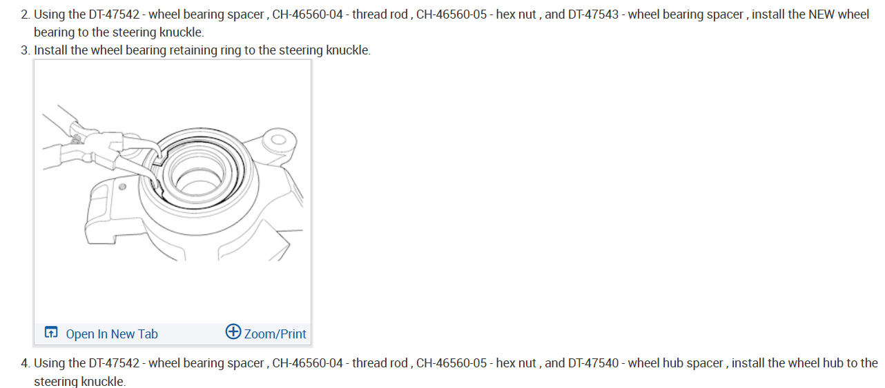

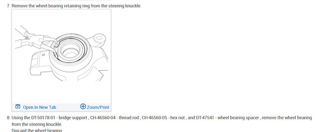

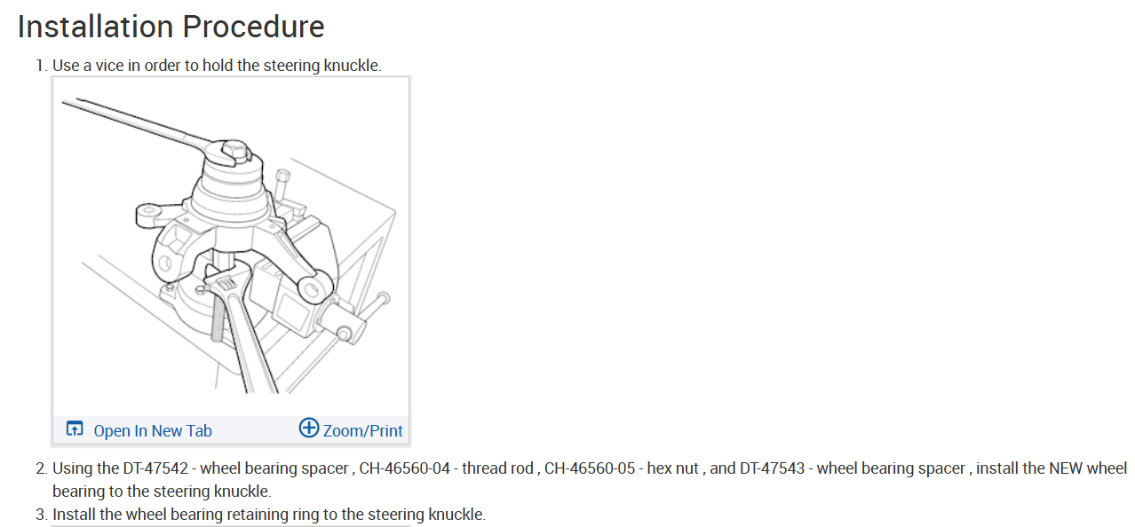

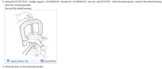

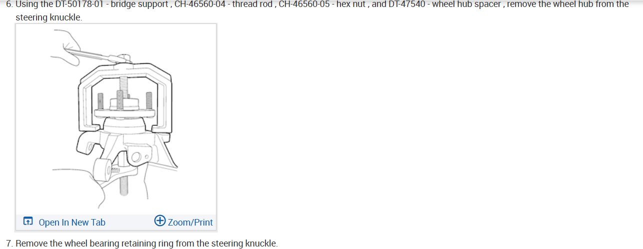

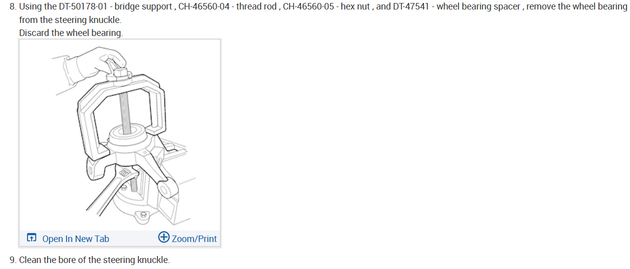

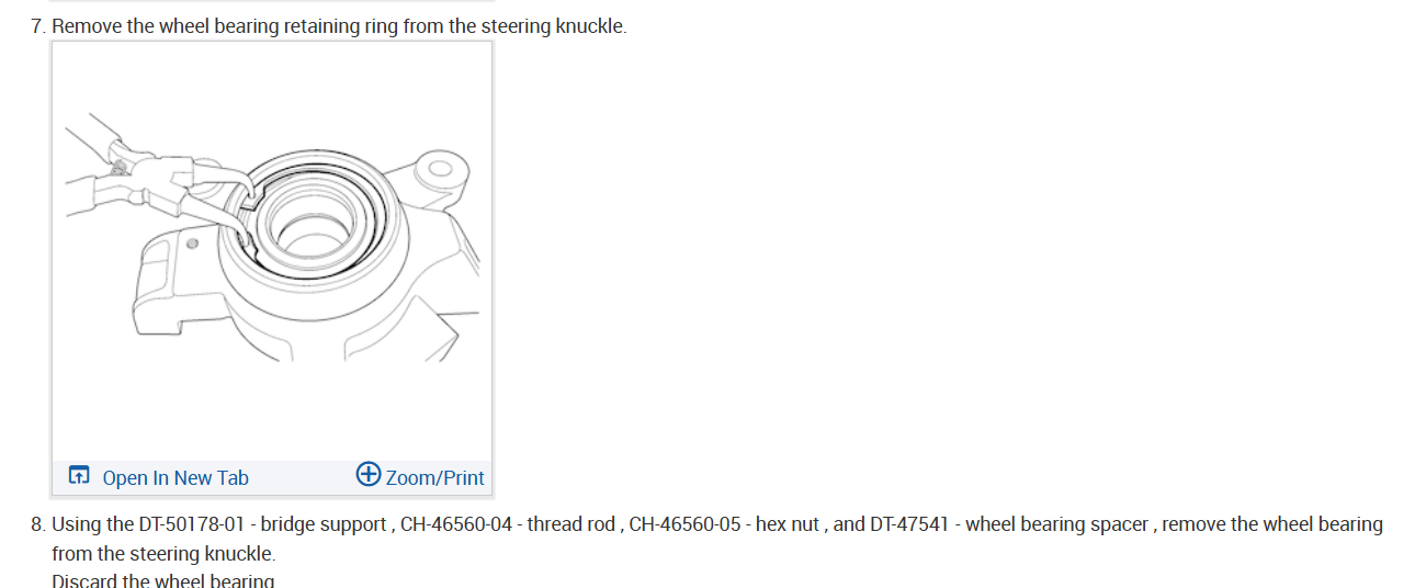

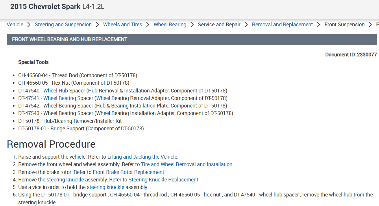

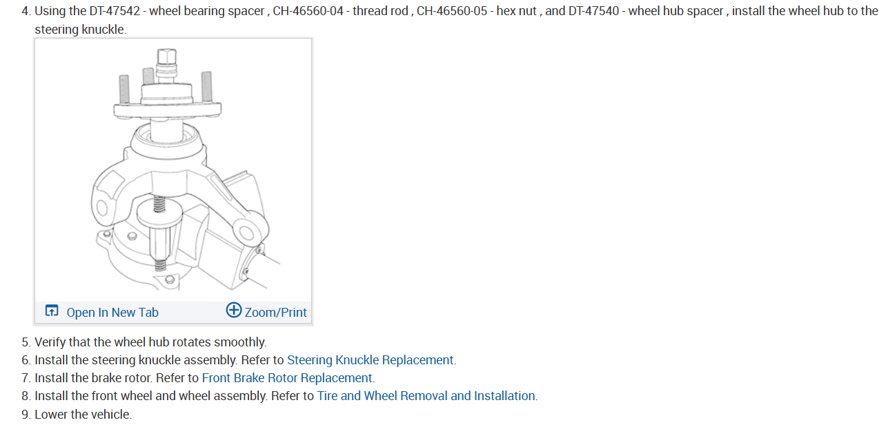

Wonder if you could help me out with any diagrams and possible step by step instructions on removing and replacing front wheels hubs?
Be much appreciated.
Thanks
Mar 9, 2025 at 3:13 AM
  • 55,214 POSTS
So this bearing and hub are separate. This means the hub will need to be pressed out and the new bearing pressed in, and the spindle will need to be removed. They show some kind of special tool, but I can tell you it is best if you use a press. Here is a video to show you how to sue the press or so you can see what needs to be done.
https://youtu.be/_FzmmBoa4Tg?si=IRmoXOJklxWYGBVK&t=436
Here are the instructions on how to change the bearing out. Check out the images (below). Please upload pictures or videos in your response of any problems so we can see what to help you with.
