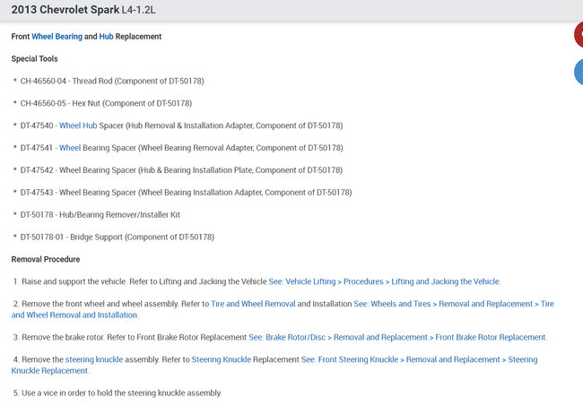

I have replaced the front wheel bearing and want to know what torque setting I should tighten the hub nut to? I am concerned that if I under or over tighten the nut that I may cause the new bearing to fail prematurely.
Jun 3, 2022 at 1:33 AM
  • 55,732 POSTS
This car is similar to a Chevrolet Spark, so this is the torque spec for that car which should be acceptable.
Using a torque wrench and the appropriate size socket, install the wheel drive shaft nut and tighten to 240 Nm (177 lb ft).

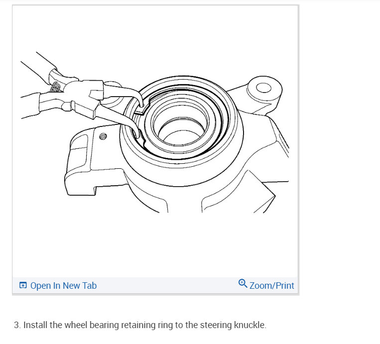

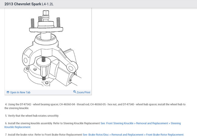

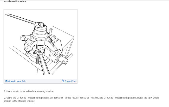

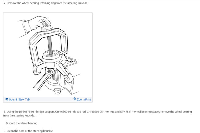

Here are the instructions in the diagrams below to replace the wheel bearing and a generic guide to help show you the steps:
https://www.2carpros.com/articles/how-to-replace-a-cv-axle-bearing
