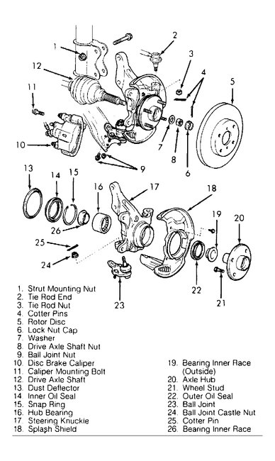

Need to replace the front bearings and hubs. The bearings for the car listed are the same part number as for a corolla but cheaper price. Cannot find the hubs for the car. Dose anyone know if the Corolla hubs will work? All the fitment charts I have seen say they do not, but there not always correct. Any help would be appreciated!

The bearing is the same part number for both applications in the same year. This style requires special tools and a lot of time to replace. To make the job easier, many aftermarket suppliers offer repair kits that include a new hub. It is that hub that could be different. Specifically, the number of studs, their spacing, and the hub's offset could be different resulting in a different part number. The hub is not listed for the Geo on the site I use for reference, but it is for the Toyota.

The hubs are different. The Corolla hub is a different bolt pattern and uses a different hub diameter.
The reason is that the Geo Prism is a joint venture of GM and Toyota. The hubs that the rims bolt to are GM spec. only. The internal bearings are the same part number because the Prism is designed with hubs that you press apart to replace the bearing unit and they used a common bearing that Toyota was already using in the Corolla and Sprinter.

The bearings usually come with the correct grease, but if you want to add more you will need to clean out ALL of the grease. Mixing grease unless it is the same is not a good idea. As for what to use, that is a regular ball bearing design so any good wheel bearing grease would work.
Be careful that you press the bearing in using the outer race. Don't miss the rear circlip.
The hub (part 20) doesn't show in GM's parts data. If the Corolla fit they would still list a valid part number.
What is bad/damaged on yours? If it's the seal surfaces you might be able to find a shop that could TIG that up and turn it back or turn it down and press a sleeve on. Wouldn't be cheap but it would work. Or get one of the Corolla hubs and measure it up. Maybe it could be altered to fit.
Or go on www.car-part.com/ and see if you can get a complete spindle with hub. There seemed to be a few listed.

The damage is the seal area but the bearings got so hot they turned the hubs blue. they are so bad that new bearings will not push on them correctly. Had a new pair of hubs pulled at the store for a corolla and only thing I see is the flange-plate which the studs are mounted to is thicker. My hub is 8mm thick while the corolla's is 11mm and the studs are a little longer. Steve W. thank you for trying to help me out! Car is down and the machine shop told me they can't fix the hubs. Its funny that the bearings and the seals for both cars are the same part number but they don't list the hubs. Thank you again!!

Go over those hubs and measure everything real close.
If that flange is the ONLY thing different then you could simple have it faced thinner. It may not even need that if the caliper can still fit on the slides with new pads in place.
