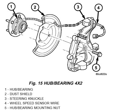

I need guidance changing the front wheel bearings on the truck listed above it is a 2500. I am looking specifically for: procedures, torque values, and diagrams so I can replace the front wheel bearings. Especially the torque of the three bolts to mount the bearing. I also understand they may have lock-tight on them? Any detailed procedures will help along with any tips. Thank you

Hi and thanks for using 2CarPros.com. Here are the directions specific to your vehicle. The torque specifications are listed in the directions. I also attached an exploded view of the assembly.

REMOVAL
Raise and support the vehicle.
Remove the wheel and tire assembly.
Remove the brake caliper and rotor.
Remove the ABS wheel speed sensor if equipped
Remove the three hub/bearing mounting bolts from the steering knuckle.
Slide the hub/bearing out of the steering knuckle.
Remove the brake dust shield.
INSTALLATION
Install the brake dust shield.
Install the hub/bearing into the steering knuckle and tighten the bolts to 163 Nm (120 ft. lbs.) .

Hub bearing torque:
TORQUE SPECIFICATIONS
Front Hub/Bearing Bolts (LD) 163 Nm (120 ft. lbs.)
Front Hub/Bearing Bolts (HD 4X2) 176 Nm (130 ft. lbs.)

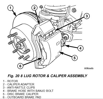

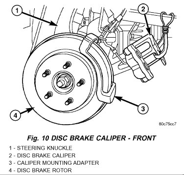

Hi Joe thanks. I was wondering the torque of the caliper to caliper bracket and also anything related to installation of pads and brake hardware on the front end. I finished the passenger side today as far as the bearing and brakes but I could not wait for torque specs. So now I want to do the driver side more accurately as far as caliper mounting etc also.
May 19, 2018 at 11:24 PM
  • 110,194 POSTS
Hi, not a problem. Here are the directions for replacing brake pads and caliper (if needed). The torque specs for the caliper to mounting bracket are listed. In the directions, the slid pin bolts are what attach the two, so use that spec. If you look at the second picture, it is related to the brake hardware or anti rattle clips. I hope this is what you needed.
REMOVAL - FRONT
CAUTION: Never allow the disc brake caliper to hang from the brake hose. Damage to the brake hose with result. Provide a suitable support to hang the caliper securely.
Remove the tire and wheel assembly.
Compress the disc brake caliper.
Remove the banjo bolt and discard the copper washer.
Remove the caliper slide pin bolts.
Remove the disc brake caliper.
INSTALLATION - FRONT
NOTE: Install a new copper washers on the banjo bolt when installing
Install the disc brake caliper.
CAUTION: Verify brake hose is not twisted or kinked before tightening fitting bolt.
Install the banjo bolt with new copper washers to the caliper. Tighten to 27 Nm (20 ft. lbs. )
Install the caliper slide pin bolts tighten to 32 Nm (24 ft. lbs.)
