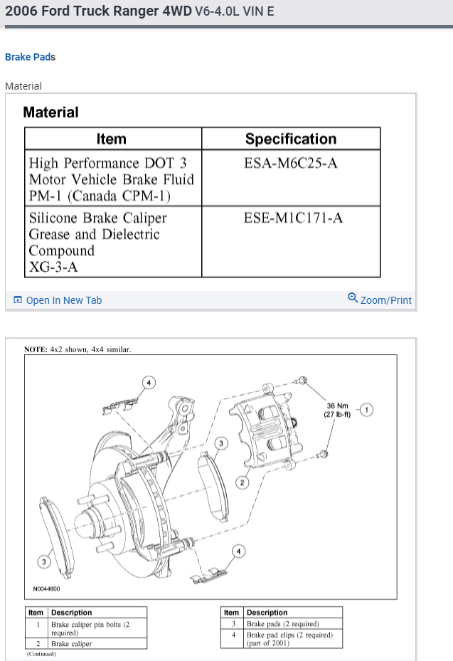

when driving you can hear a rubbing noise that sounds like wawawa and goes faster with speed increase and stops if you press on the brake pedal.
Oct 16, 2017 at 9:38 AM
SQM
  • 6,383 POSTS

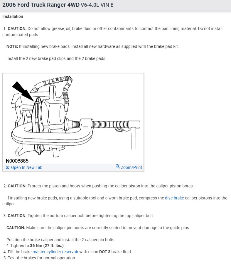

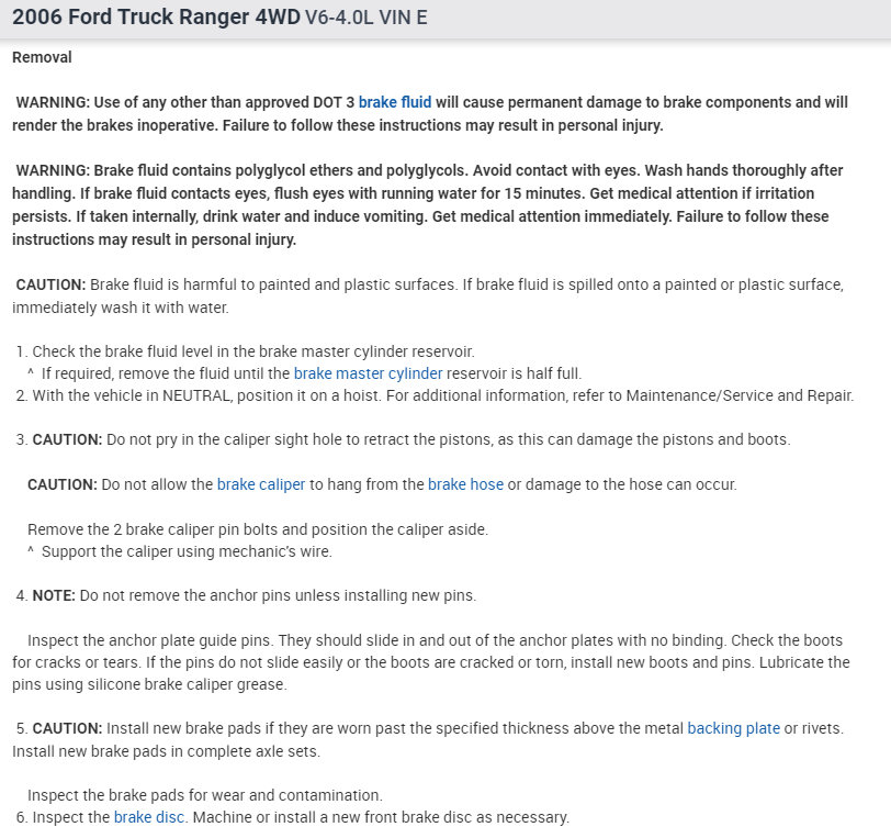

It could be the brake pads rubbing against the rotors.
Inspect the brake pads. Make sure that they are secured. As is the anti-rattle clips are loose or missing on the pad it can move around and run against the rotor.
But when you depress the brake pedal the pads gets firmly pressed against the rotor and the noise goes away as the pads are unable to move around.
