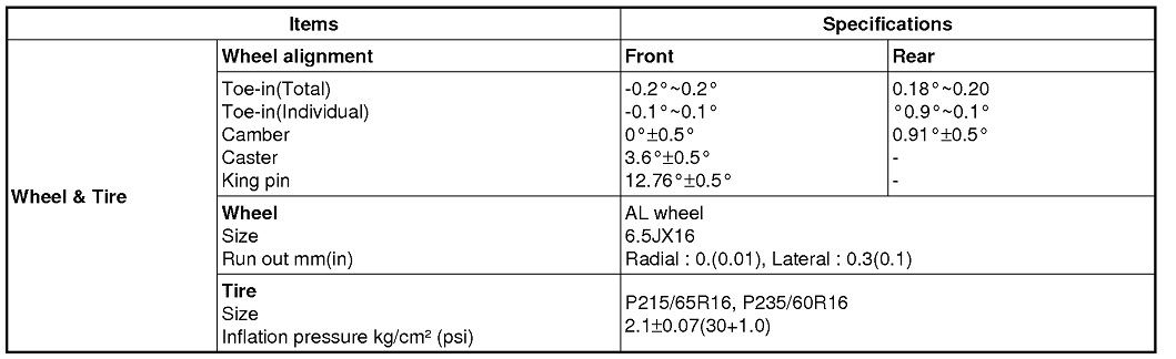

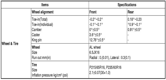

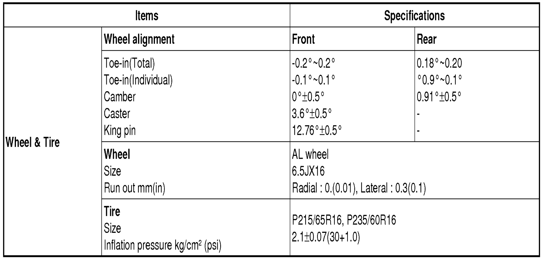

My right front tire is wearing on the outside. What is the front wheels spec for toe and camber.

This kind of the wear is usually the toe adjustment. FYI. This guide can help as well:
https://www.2carpros.com/articles/how-car-tires-work
The front and rear wheel alignment spec card is featured below. Check out the images (below). Let us know if you need anything else.

Here's the alignment specs.
