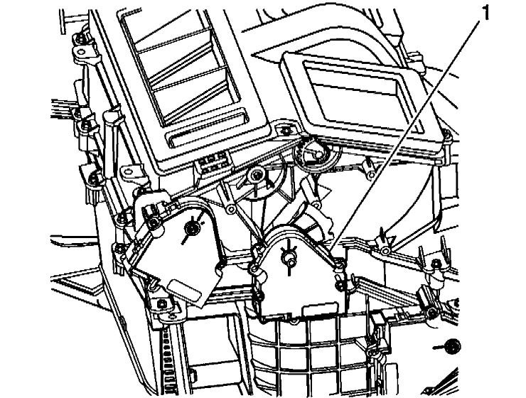

So my grandpa has the vehicle listed above, the air blows out the side, feet, and dash vents but not the front vents. I have tried a new actuator, and I tried resetting the fuses under the back driver side seat. Does anyone know what else I can try to do?

Good afternoon,
What actuator did you replace as there are several?
I attached a picture of the actuator that controls modes.
+1
Tuesday, May 14th, 2019 AT 5:01 PM
ALONZO ROSE
  • 8 POSTS
From all the videos I watched I replaced the blend door actuator, what is this one called that I would have to replace, and thanks for the tip. Lol, I don't know that much.
Tuesday, May 14th, 2019 AT 5:12 PM
  • 52,797 POSTS
Is the one in the picture the one you replaced? That is the one for the blend door.

That is the one I replaced, it may have been a faulty one, even though it was new.
Tuesday, May 14th, 2019 AT 5:50 PM
  • 52,797 POSTS
I would remove it again and hook up the wires. Then turn on the key and command heat and cold and see if the motor turns back and forth.
Tuesday, May 14th, 2019 AT 6:01 PM
ALONZO ROSE
  • 8 POSTS
At first it did easily, but when I put the new one on it didnt turn at all so I put the old one back on and it barely budgeds back and forth now, not much at all.
Tuesday, May 14th, 2019 AT 6:09 PM
  • 52,797 POSTS
Does it move free with the motor off the case and the wires hooked up?
Tuesday, May 14th, 2019 AT 6:13 PM
ALONZO ROSE
  • 8 POSTS
I didn't check the actuator its self. I tried turning the little plastic piece that the actuator attaches to, it turns but it's tough to turn it.
Tuesday, May 14th, 2019 AT 6:17 PM
  • 52,797 POSTS
Okay, that may be the issue. It should turn freely.

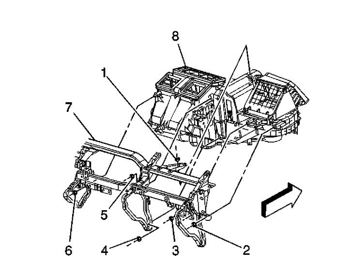

Then good chance the door is the issue inside. The heater case would have to be removed and opened up to find the issue.
The downside is the dashboard has to be removed to gain access to the case that holds the door.
HVAC MODULE ASSEMBLY REPLACEMENT
TOOLS REQUIRED
- J 43181 Heater Line Quick Connect Release Tool
- J 39400-A Halogen Leak Detector
REMOVAL PROCEDURE
1. Drain the engine coolant. Refer to Draining and Filling Cooling System (Body Vin Code 6) Draining and Filling Cooling System (Body Vin Code 3) in Cooling System.
2. Recover the refrigerant.
3. Remove the I/P carrier. See: Dashboard / Instrument Panel > Removal and Replacement > Instrument Panel (IP) - Carrier Replacement

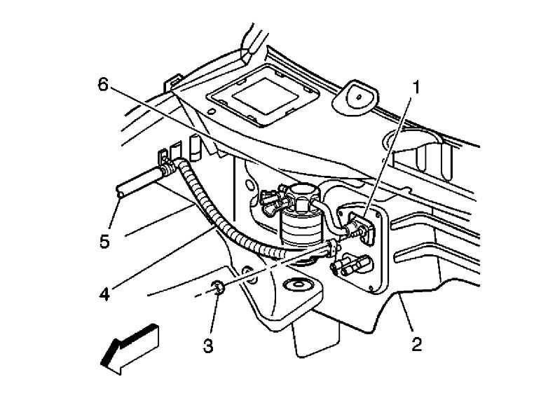

4. Reposition the heater hose clamps using J 43181.
5. Disconnect the heater hoses from the heater core.
ImageOpen In New TabZoom/Print
6. Remove the retaining nut (3) from the accumulator (6) at the evaporator (1).
7. Disconnect the accumulator (6) from the evaporator (1).
8. Disconnect the evaporator tube (4) from the evaporator (1).
9. Disconnect all of the electrical connectors to the HVAC module assembly.
10. Remove the HVAC module assembly.
