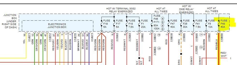

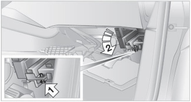

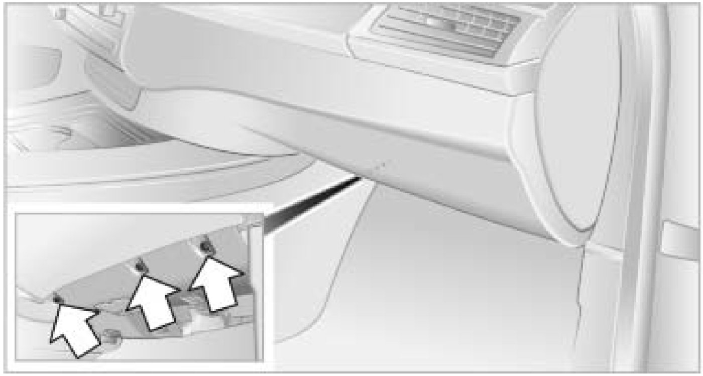

Okay, the first thing we need to check is the fuse which provides power to the blower motor. It is fuse 48 in the junction box on the right side of the dash.
Take a look through the attached pictures to help locate it.
Here are a few links you may find helpful:
_________________________
Let me know what you find.
