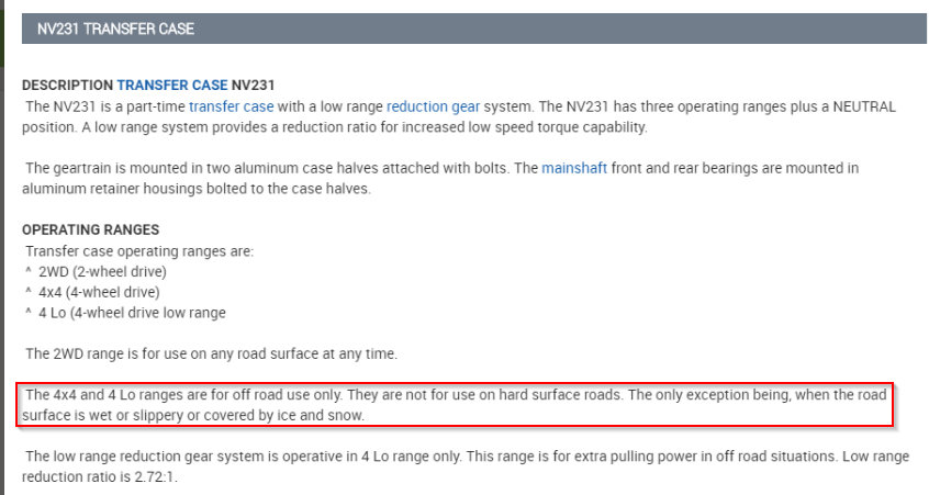

I just replaced both front u joints because they were shot. The new ones are fine in 2 wheel drive but when in 4 wheel they start to fight back when you take more than a medium turn. I have only driven maybe 1 mile. Should I drive more to see if they improve or do I need to take back apart?

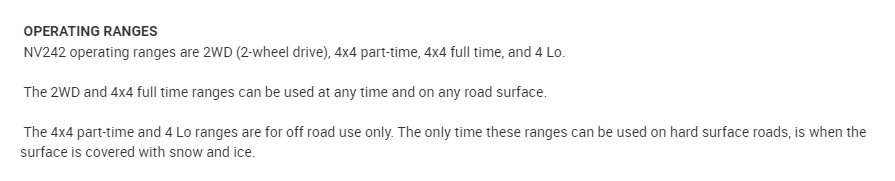

Which transfer case do you have? Do you have the full time (NV242 ) or the 2WD transfer case (NV231)? Do you have an option that says 2WD, Full Time 4WD, part Time 4WD, 4LO? Or does it say 2WD, 4x4, 4 LO?
Let me know which your selector says and that will determine what could be happening. Also, when you are putting it in 4WD, what selection are you making?

I have the 2 wheel drive transfer case and 2wd 4x4 or 4 low we are using the 4x4 position.
Aug 16, 2020 at 1:43 AM

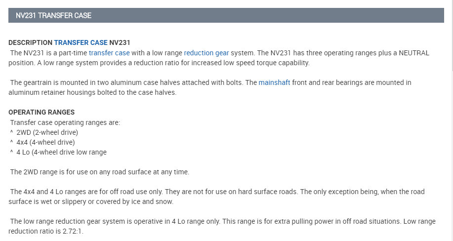

Okay. That is what I suspected. Take a look at the attachment with the highlighted area. This sounds normal due to this so if the vehicle drives normally except when turning in 4WD, I would not worry about it.
Does that make sense?
