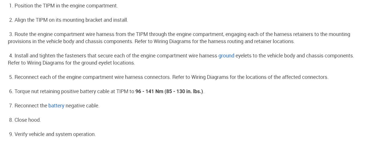

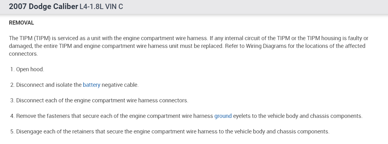

Works with headlights off. The bulb has been replaced and no other bulbs are out on the vehicle. Also, when the signal left is selected, indicator sound is a much faster pace than usual.
Dec 16, 2022 at 2:29 AM
  • 55,433 POSTS

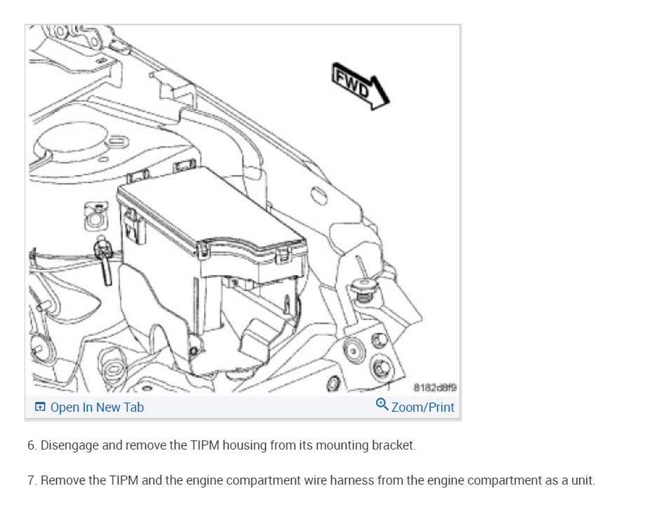

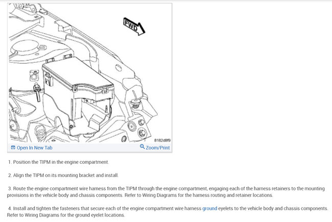

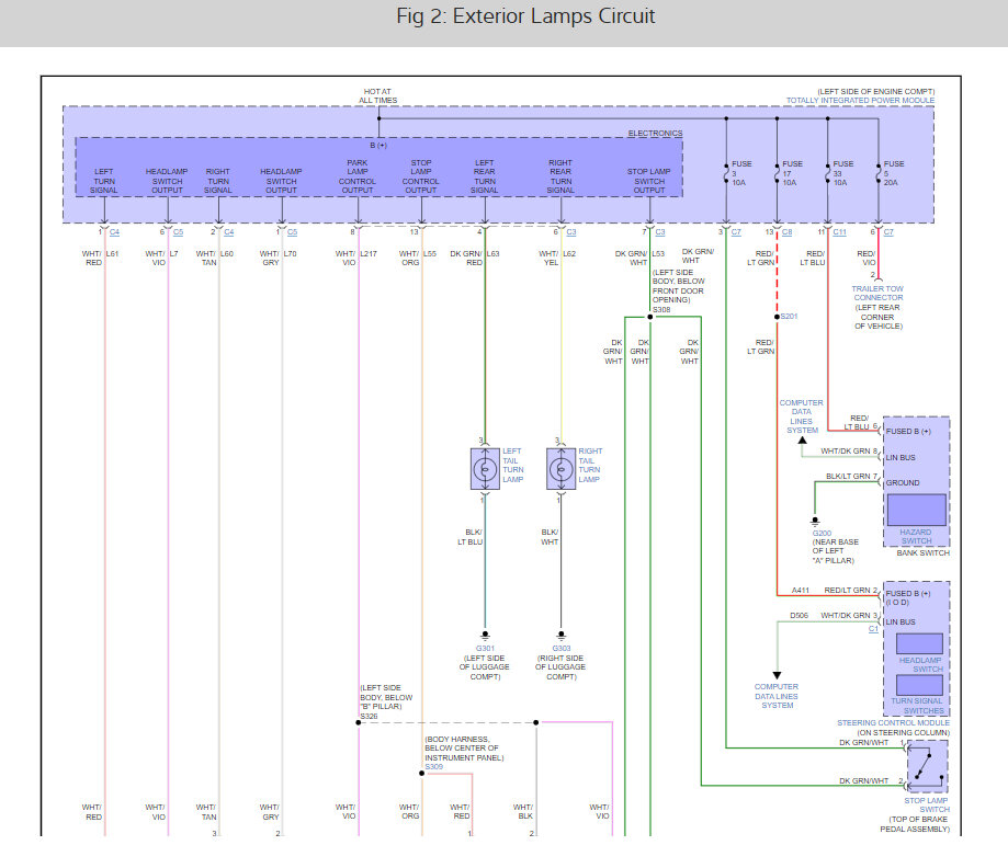

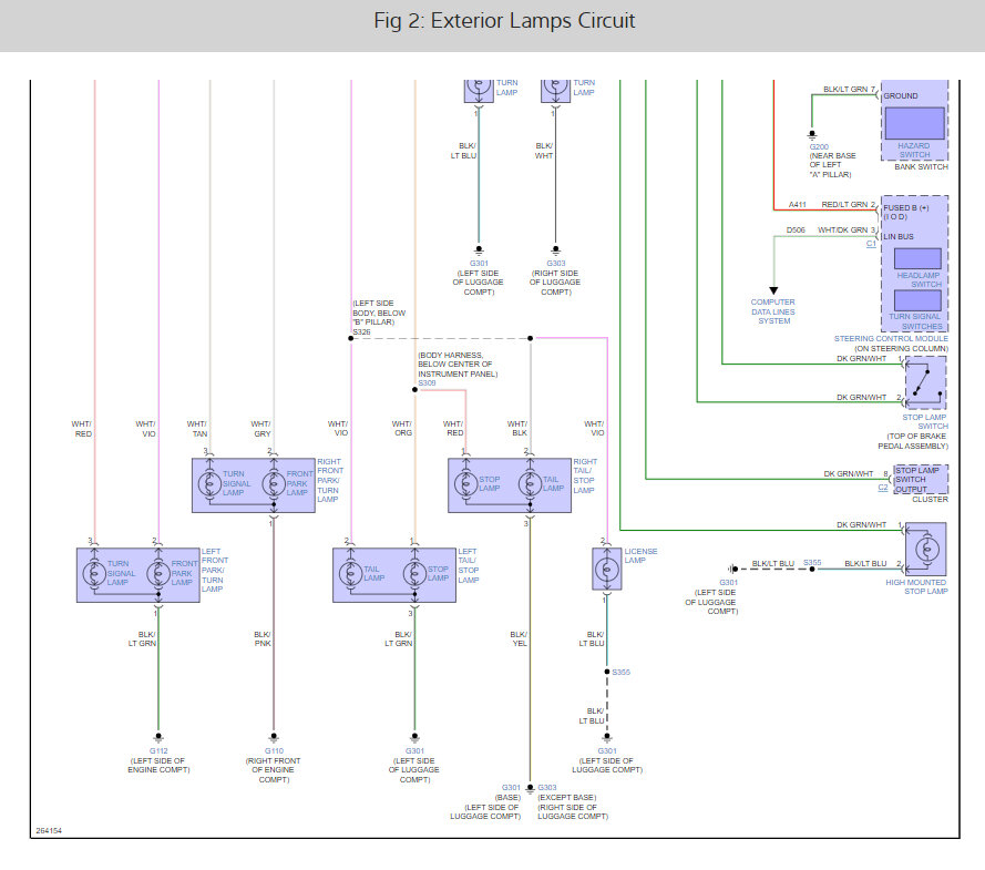

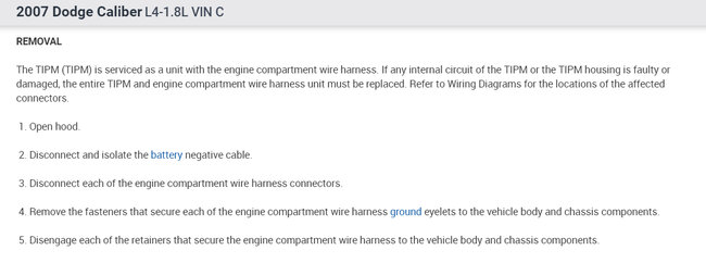

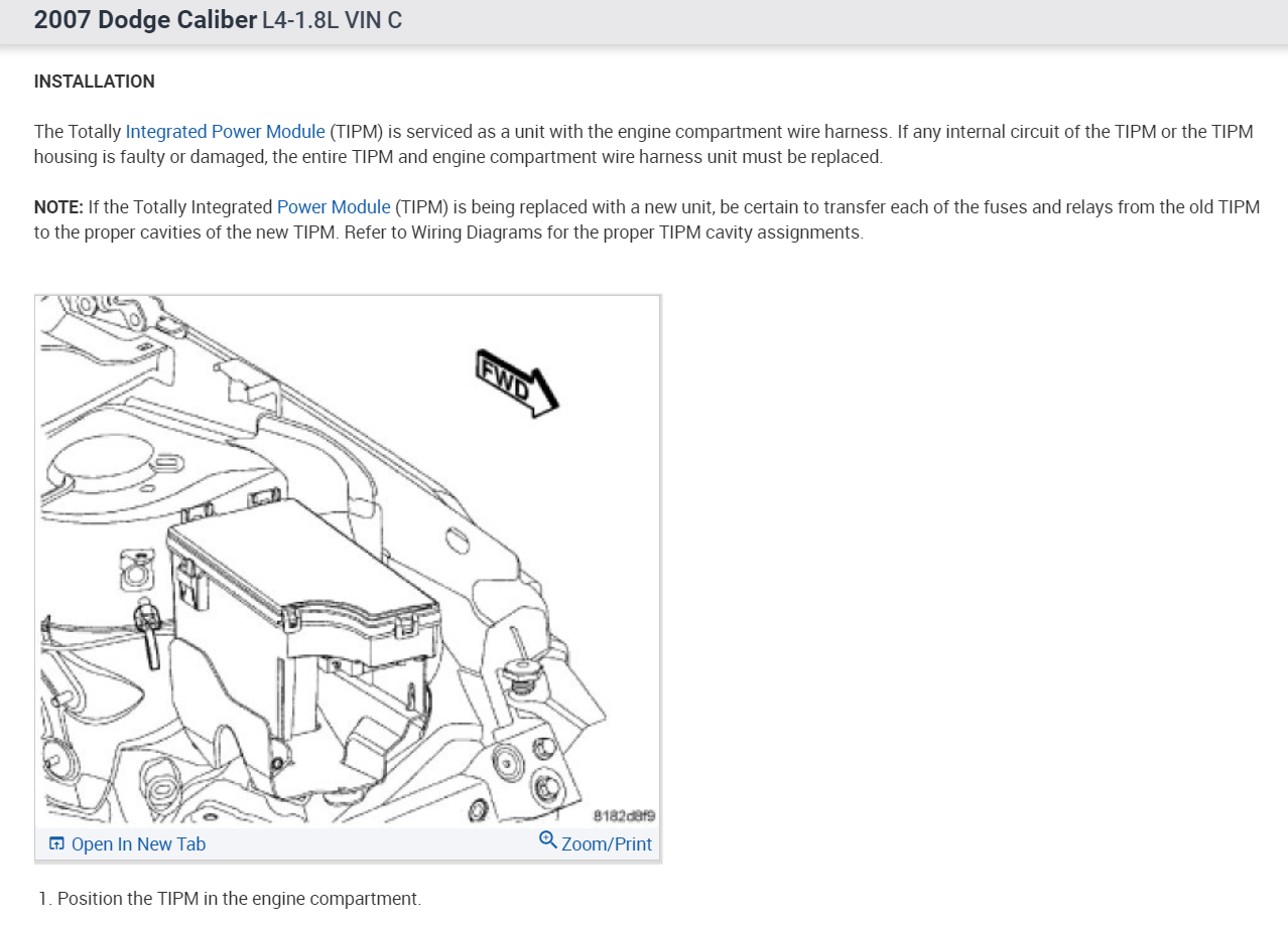

Let's start by checking the ground which is located at the left side of the engine compartment (G112) if that is okay is sounds like you have a TIPM going out which is common on these cars. They are easy to replace because they self-learn. Here are the instructions on how to replace the unit, plus I have included the blinker wiring diagrams so you can see how the system works. Check out the images (below). Let us know what happens and please upload pictures or videos of the problem.
