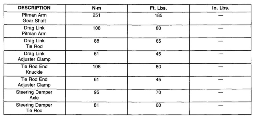

I need the correct torque specs please.
Oct 13, 2020 at 6:51 PM
I am attaching the torque specs for the steering system. Let me know if you need more info. Thanks
Oct 14, 2020 at 7:15 AM
BMPHILLIPS
Thanks you. He will be back out there today working on it.
Oct 14, 2020 at 3:59 PM
Okay. Great. Let us know if you need more info. Just make sure you get an alignment after they are replaced just to make sure you don't do damage to your tires. Thanks

Can you do your own alignment at home?
Oct 15, 2020 at 10:15 AM
BMPHILLIPS
How hard is it to change heating core?
Oct 15, 2020 at 12:51 PM
You can do a home alignment for the toe adjustment but the other angles, camber and caster are near impossible to get correct. You can find a shop in most areas to do an alignment for less then $100.00 and it is money well spent because if you try it and get it wrong you will ruin your tires then you will need to pay for an alignment and tires.
