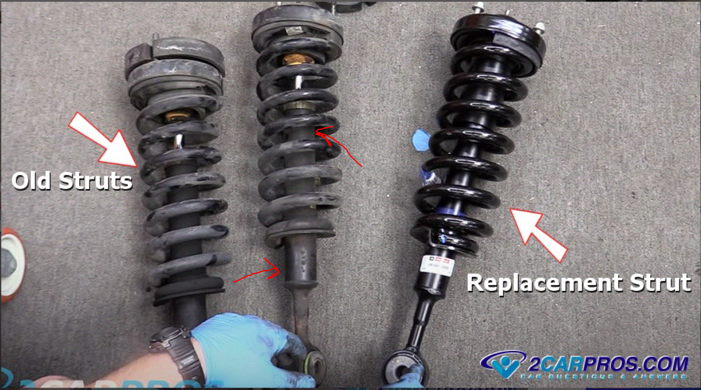

I have a problem finding out the problem. I already changed the tie rods and the sway bar but every time I hit a bump the front end wants to jump in the next lane. Can you help me solve this problem?

That doesn't sound good. LOL By chance, have you had the alignment checked? Also, have you checked to see if the front shocks are still in good condition?
Take a look at the front struts. See if there is any evidence of oil leaking from them. See pic 1. Also, bounce the front of the vehicle. After you let go, it should stop bouncing within three bounces. Does that happen?
Let me know. Also, let me know what all has been checked so far. For example, are the ball joints good? Is the rack and pinion gear tight? You mentioned the tie rods are you sure the inner joints are good?
I will watch for your reply.
See pic below.
