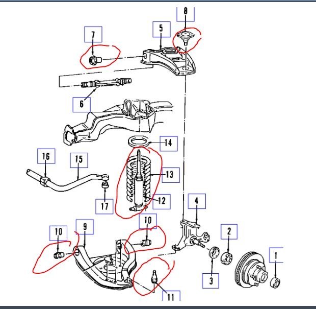

While riding down the street, I constantly hear a squeaky noise in the front of the especially on ruff roads? Where is it coming from?

Good morning,
I attached a diagram of the front suspension for you.
You have shocks, not struts for this model.
https://www.2carpros.com/articles/replace-shock-absorber
I would have someone check the suspension for you but the bushings I circled are common for wearing out and causing the noise.
https://www.2carpros.com/articles/lower-control-arm-bushing-replacement
https://www.2carpros.com/articles/upper-control-arm-replacement
