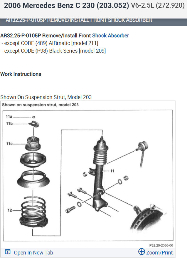

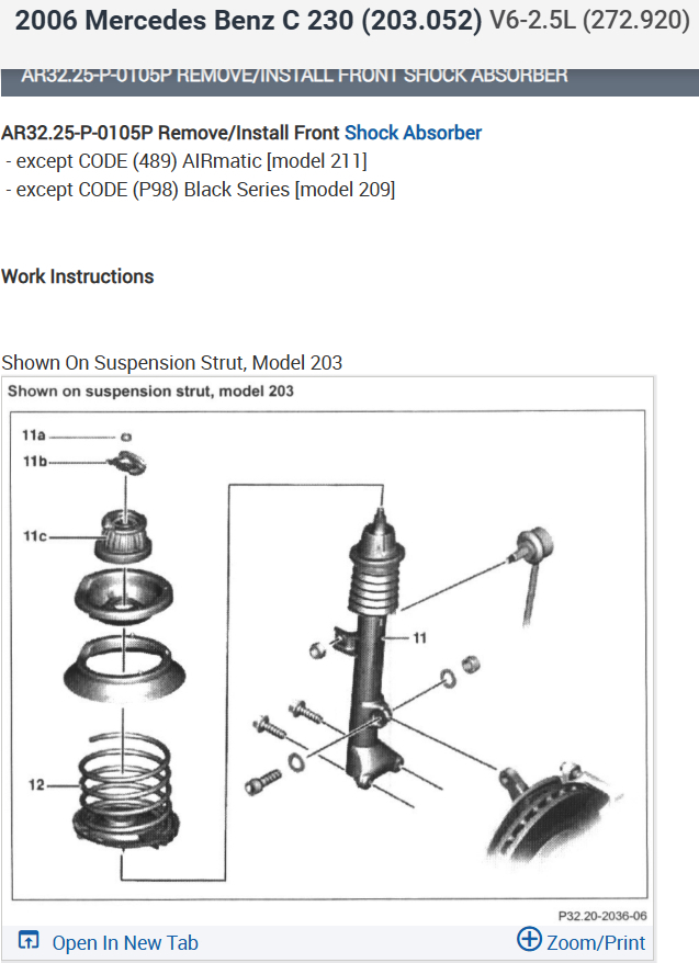

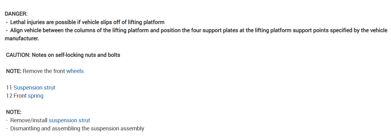

Here is a guide to help walk you through the steps, this job can be dangerous if not done correctly. I would get the strut and spring together all in one piece, so you don't need to mess with the spring.
Here they are on amazon, both for $175.00:
https://amzn.to/4k1YGtk
Here is the guide with instructions for your car in the images below:
https://www.2carpros.com/articles/how-to-replace-a-suspension-strut-and-spring
Check out the images (below). Let us know if you need anything else.
