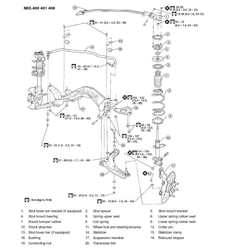

Can I get the front strut nuts torque specs?
2005 NISSAN SENTRA
120,000 MILES • 1.8L • 4 CYL • 2WD • AUTOMATIC
P77STEP
What are the torque specs for the front strut nuts, both the top and bottom?
Thanks
Jul 22, 2022 at 12:28 PM
  • 55,399 POSTS
Sure, here you go; the torque specs for the front suspension are in the diagrams below. Check out the diagrams (below). Please let us know if you need anything else to get the problem fixed.
