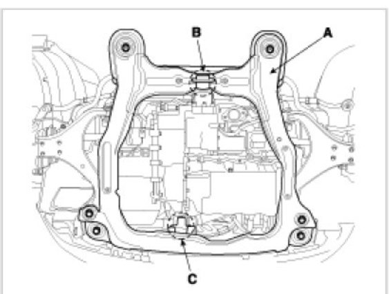

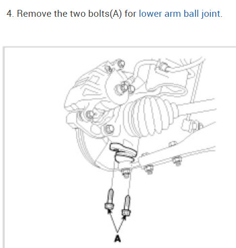

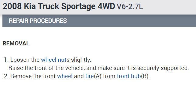

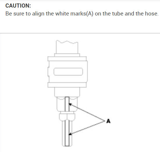

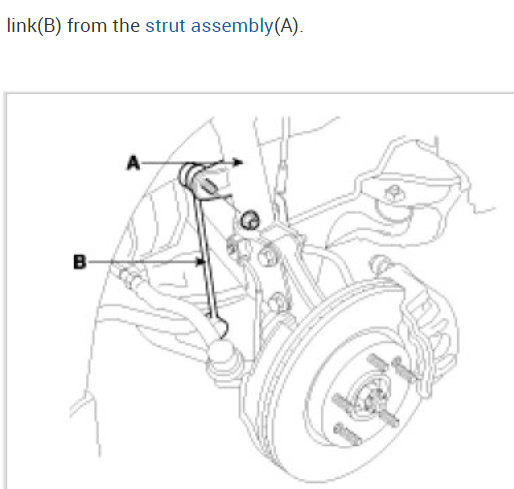

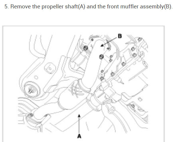

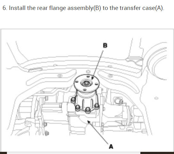

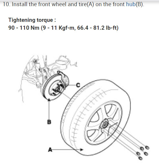

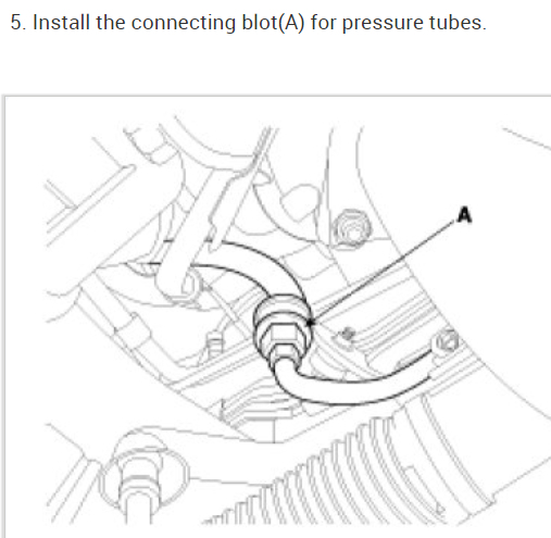

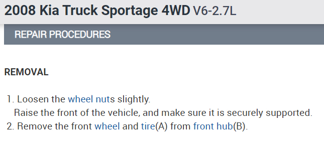

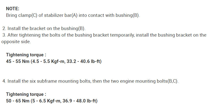

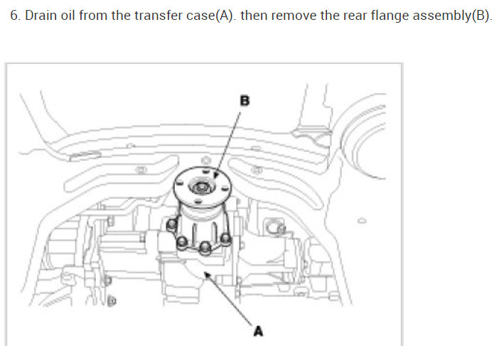

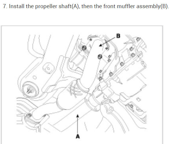

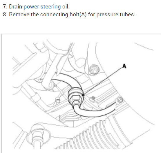

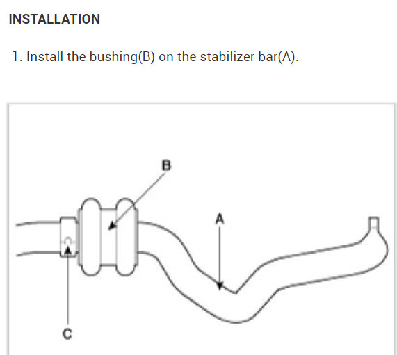

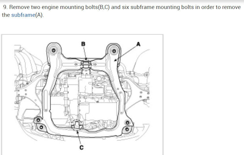

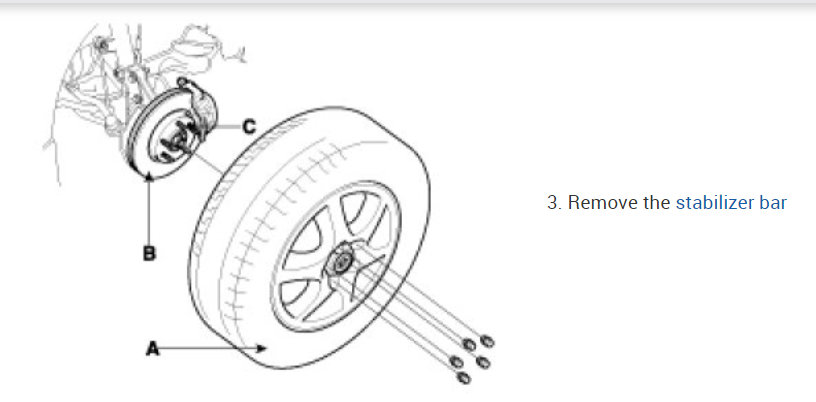

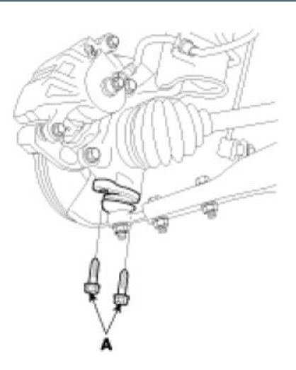

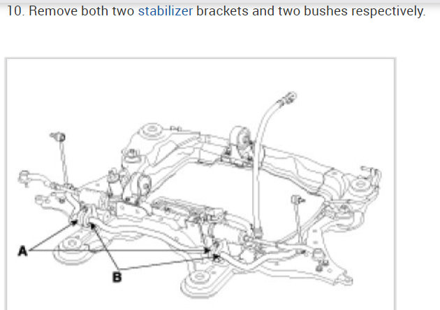

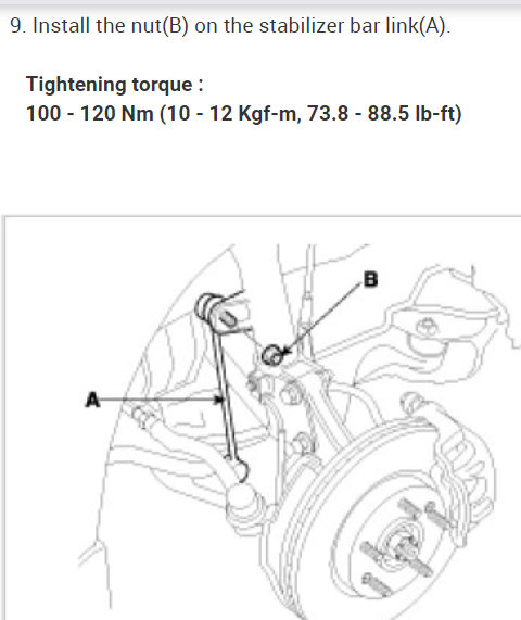

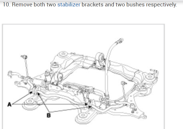

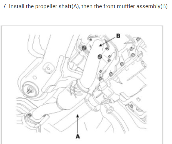

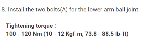

How to front stabilizer bar bushing replacement?
Thanks
Dec 18, 2020 at 6:31 PM
DANNY L
Experienced Mechanic
5,648 POSTS
Hello, I'm Danny.
Here is the information you've requested. I've attached picture steps below on how to replace the stabilizer bar bushings on your car. Hope this helps and thanks for using 2CarPros.
Images (Click to enlarge)
