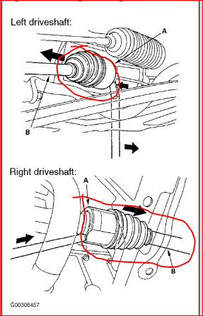

When I turn van on a rattle noise begins as its sitting on park. While driving noise sounds like knocks. When turning right loud noise from front left tire sounds like it is scrapping something. When I bought used van I was told it needed shocks but I never got to it. Is the need of shocks the problem?

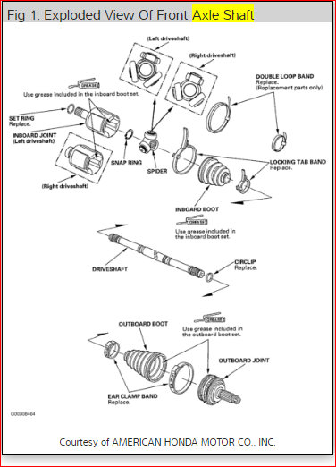

It sounds like your left CV Axle is starting to fail. They are subject to wear and tear and need replacement after time due to it being your vehicles drive axle. I have attached a picture of what they look like and a tutorial showing how to remove and replace. Hope this helps and feel free to ask any questions. Thanks for using 2CarPros.
