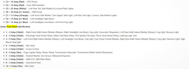

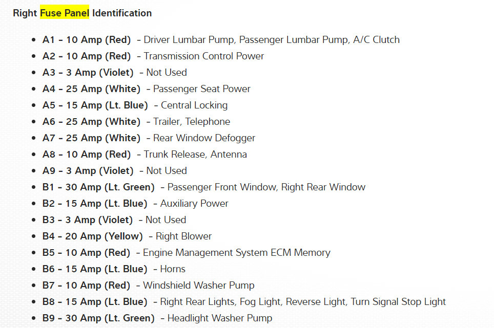

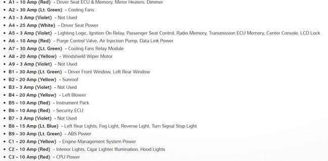

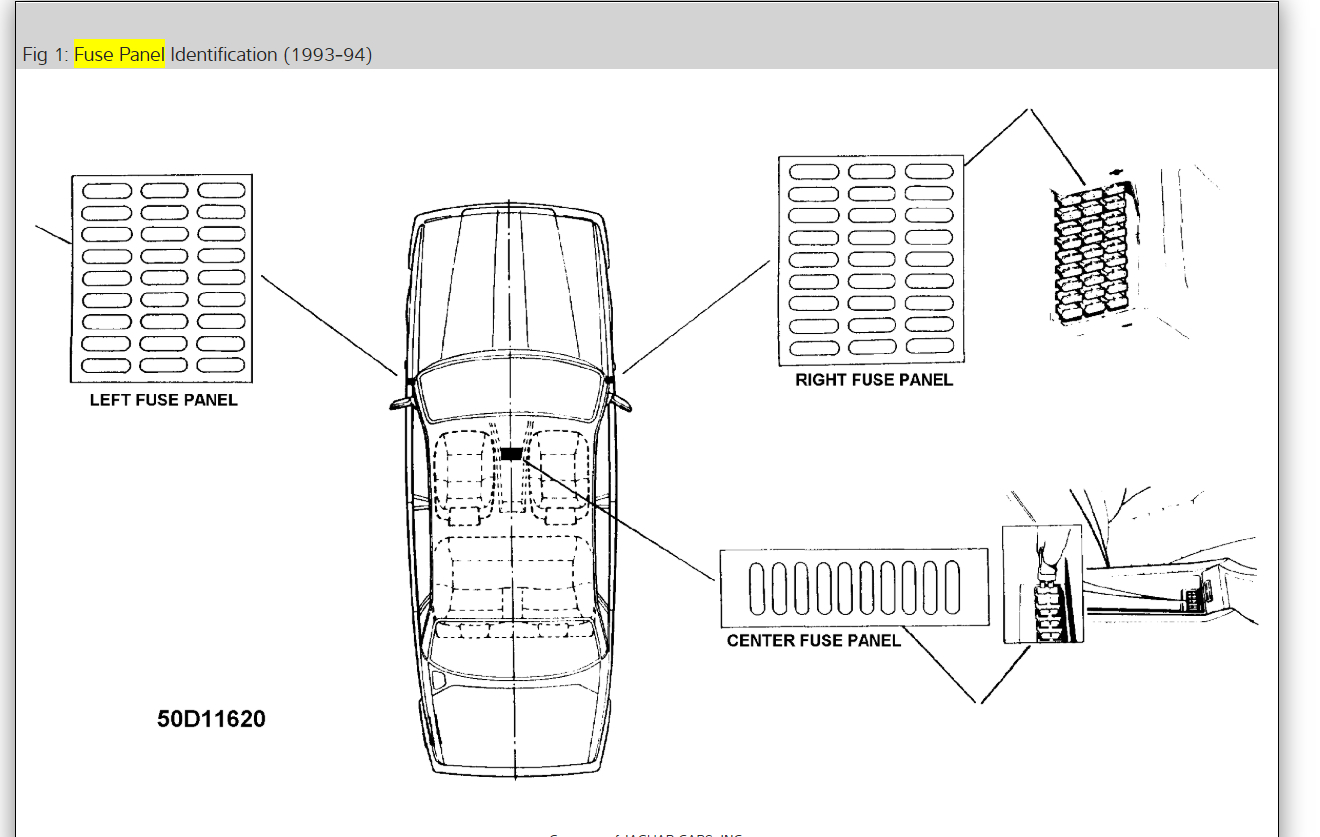

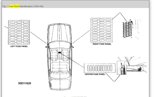

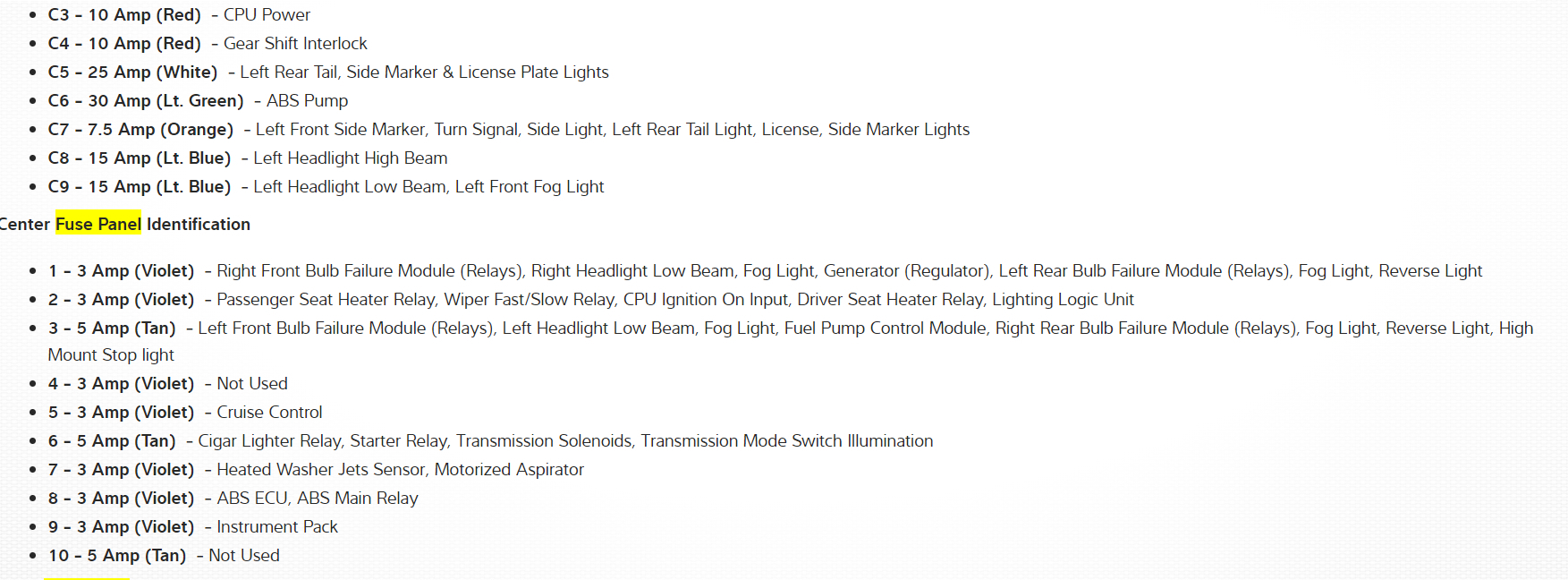

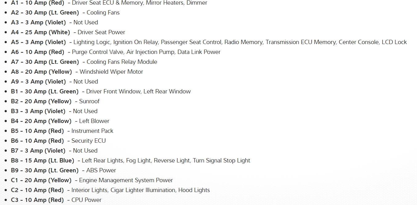

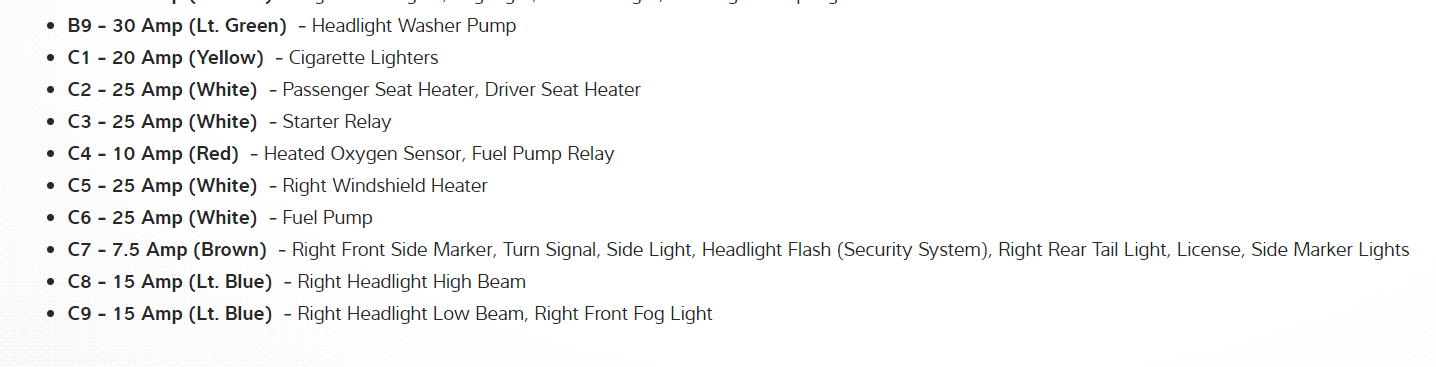

Both front seats won't move. anything thing you can tell me to help?
Jun 2, 2019 at 2:23 AM
Experienced Mechanic
55,676 POSTS
It sounds like a fuse has blown. lets start by following this guide and the fuse locations below to help us fix the problem.
Check out the diagrams (below). Please run this test and get back to us.
